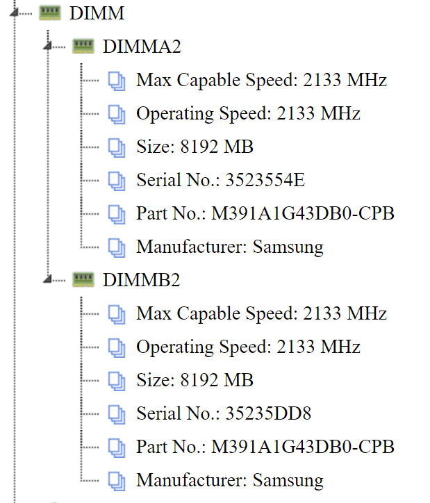

This is my RAM, would you double check plz?!
Continue using the array normally and run a couple more non correct checks.
There's also the possibility that something was written to the previous wrong sector after the first check updating parity, so now it would be correct, if it wasn't that you likely have an hardware problem somewhere.
