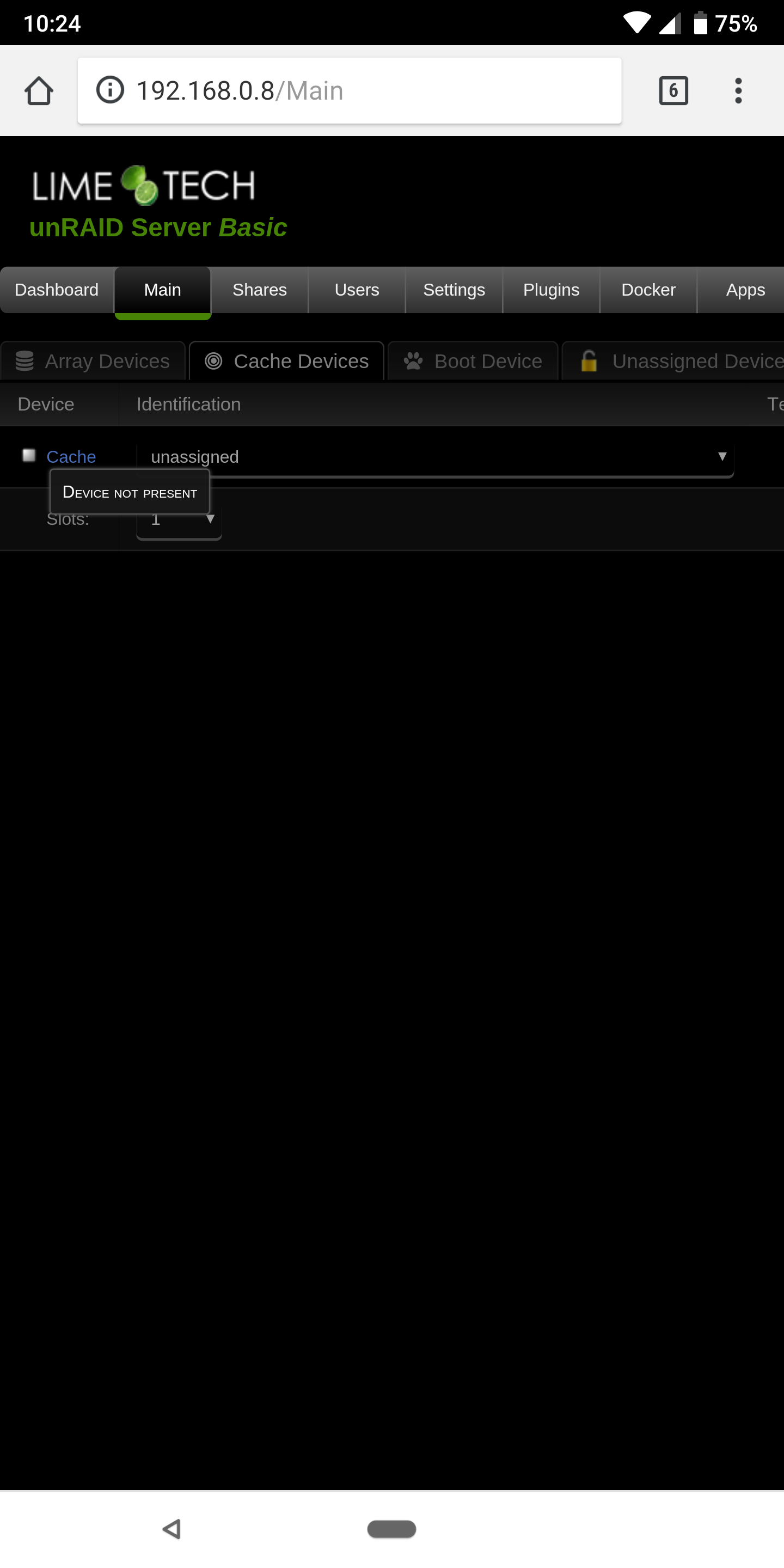

Few weeks ago i noticed my Plex server was not working. Looking at the Unraid Web GUI I noticed the docker tab said "failed to start". More looking around in the UI told me the cache drive was not being recognised and is labeled as not present when I spin down the array and check the cache tab out. I've checked the power and Sata cables and they are working perfectly as they have no issue powering up other disks. The screenshot below was taken while it had the working Sata and power cables connected.

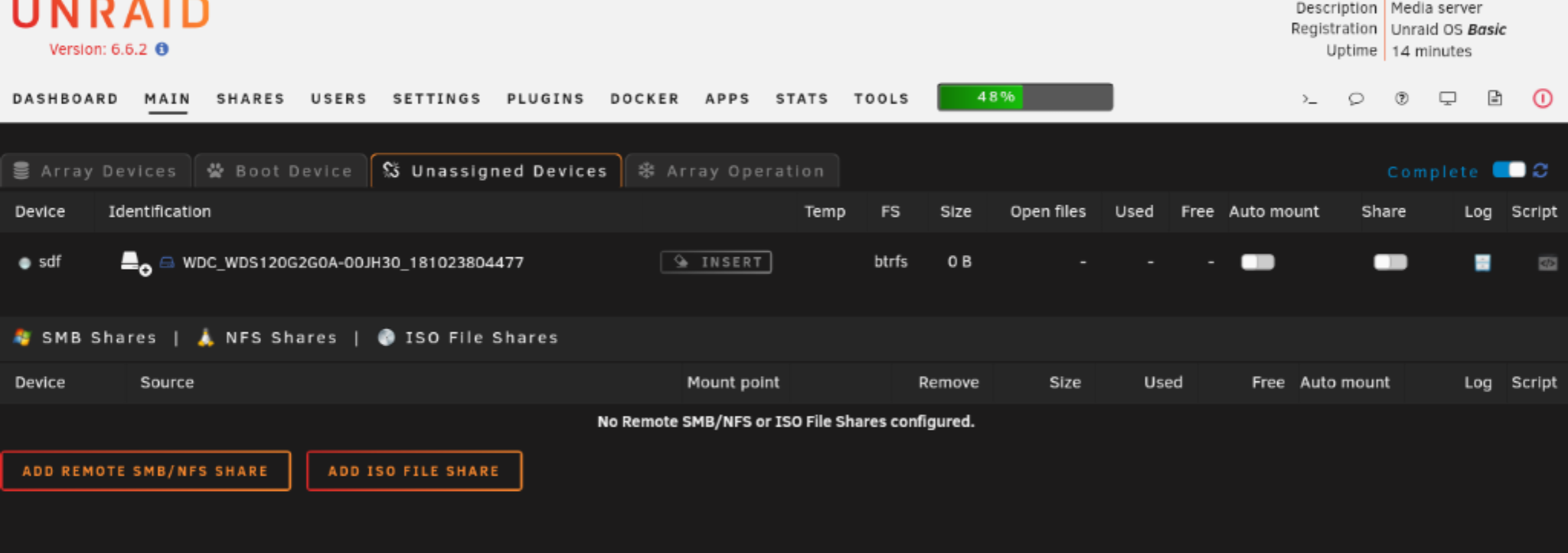

SSD is online, just appears unassigned, next time grab the diags before rebooting or we can't see what happened.
If its online, but unassigned I should see it in the UI correct? Currently the cache tab has no drive present?
If you stop the array, is it assignable?
See attachment below. This is what I see and it is not assignable.
