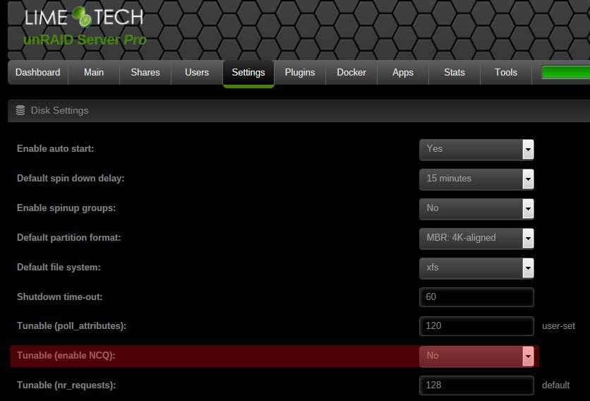

June 11, 20188 yr Author 5 minutes ago, pwm said: NCQ is Native Command Queueing. So you can send multiple commands to the drive. The drive may then reorder the commands and handle in most efficient order. Then send back ack/nack for the individual queued commands. DRM is Digital Rights Management. I don't think this one is relevant here. I think you should see it as a note that if there are DRM-protected content on the drive, then you haven't supplied any encryption key allowing you to access this protected content. I know this - but NCQ is off and i dont use DRM... Edited June 11, 20188 yr by Zonediver
June 11, 20188 yr 4 minutes ago, Zonediver said: I know this - but NCQ is off and i dont use DRM... Have you turned off NCQ? If you use AHCI then NCQ should normally be on without you turning on anything. And I believe that the DRM line is just informational - that the drive supports it.
June 11, 20188 yr Author 1 minute ago, pwm said: Have you turned off NCQ? If you use AHCI then NCQ should normally be on without you turning on anything. And I believe that the DRM line is just informational - that the drive supports it. NCQ is OFF
June 11, 20188 yr 12 minutes ago, Zonediver said: NCQ is OFF Where have you verified this? I only found a very old syslog you had posted from last year. And I don't know if it's from the same system. But on boot, it wrote: Aug 5 02:11:21 unraid kernel: ata11.00: 5860533168 sectors, multi 16: LBA48 NCQ (depth 31/32), AA Aug 5 02:11:21 unraid kernel: ata12.00: 5860533168 sectors, multi 16: LBA48 NCQ (depth 31/32), AA Aug 5 02:11:21 unraid kernel: ata14.00: 5860533168 sectors, multi 16: LBA48 NCQ (depth 31/32), AA Aug 5 02:11:21 unraid kernel: ata9.00: 7814037168 sectors, multi 16: LBA48 NCQ (depth 31/32), AA Aug 5 02:11:21 unraid kernel: ata13.00: 7814037168 sectors, multi 16: LBA48 NCQ (depth 31/32), AA So that system, at that time, did use NCQ.
June 11, 20188 yr Author 5 minutes ago, pwm said: Where have you verified this? I only found a very old syslog you had posted from last year. And I don't know if it's from the same system. But on boot, it wrote: Aug 5 02:11:21 unraid kernel: ata11.00: 5860533168 sectors, multi 16: LBA48 NCQ (depth 31/32), AA Aug 5 02:11:21 unraid kernel: ata12.00: 5860533168 sectors, multi 16: LBA48 NCQ (depth 31/32), AA Aug 5 02:11:21 unraid kernel: ata14.00: 5860533168 sectors, multi 16: LBA48 NCQ (depth 31/32), AA Aug 5 02:11:21 unraid kernel: ata9.00: 7814037168 sectors, multi 16: LBA48 NCQ (depth 31/32), AA Aug 5 02:11:21 unraid kernel: ata13.00: 7814037168 sectors, multi 16: LBA48 NCQ (depth 31/32), AA So that system, at that time, did use NCQ. Its set to "No" - but maybe there is something wrong... Edited June 11, 20188 yr by Zonediver
June 11, 20188 yr OK. But the drive boots with NCQ enabled. The question is how soon the unRAID setting will take effect and turn off NCQ. And what happens with the NCQ state after a link reset.
June 11, 20188 yr Author 1 minute ago, pwm said: OK. But the drive boots with NCQ enabled. The question is how soon the unRAID setting will take effect and turn off NCQ. And what happens with the NCQ state after a link reset. The strange thing is, it only happens at 20:00 when the scheduler shall trim the SSD - i tried to change the time to 19:00 and all was working fine - i am confused... I am not a programmer or code-analyst so i cant understand what this error does...
