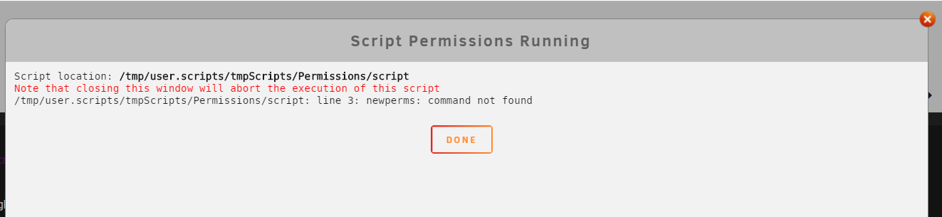

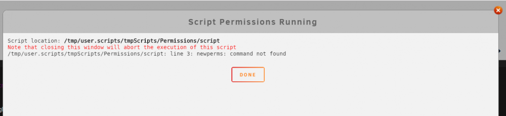

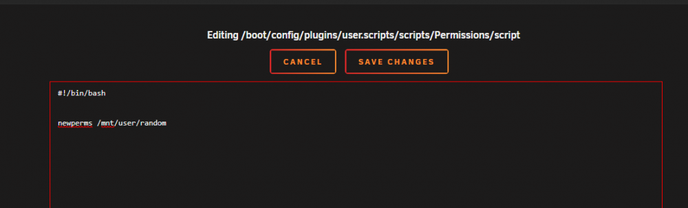

December 29, 20187 yr On 7/12/2018 at 6:56 AM, Squid said: User scripts plugin Script would be newperms /mnt/user/nameOfShare Sent via Tapatalk because I'm either at work or enjoying the summer Hey Squid - when trying to run this script in the User Scripts plugin, I get the error "newperms: command not found" Any thoughts?
December 29, 20187 yr /usr/local/sbin/newperms /mnt/user/nameOfShare But, usually its not necessary to run this on a schedule, unless you've got a container misconfigured and writing the wrong permissions
December 29, 20187 yr 21 hours ago, Squid said: /usr/local/sbin/newperms /mnt/user/nameOfShare But, usually its not necessary to run this on a schedule, unless you've got a container misconfigured and writing the wrong permissions Thanks that worked. Ok I will check my container configurations to see what could be wrong.
