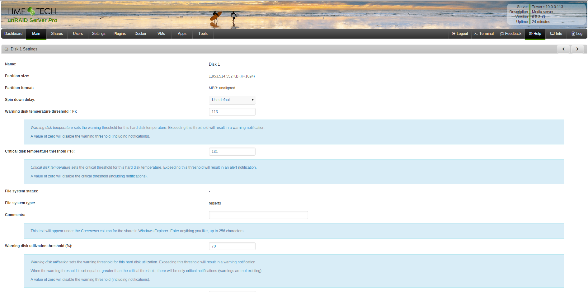

The system is now on 6.5.3 and is error free.  Please let me know the detailed steps for changing the filesystem.
I can see it is currently set to reiserfs but I am not sure how or what to change it to.
Thanks again for your assistance.  Much appreciated.

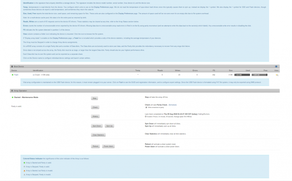

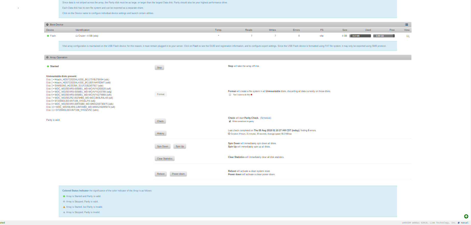

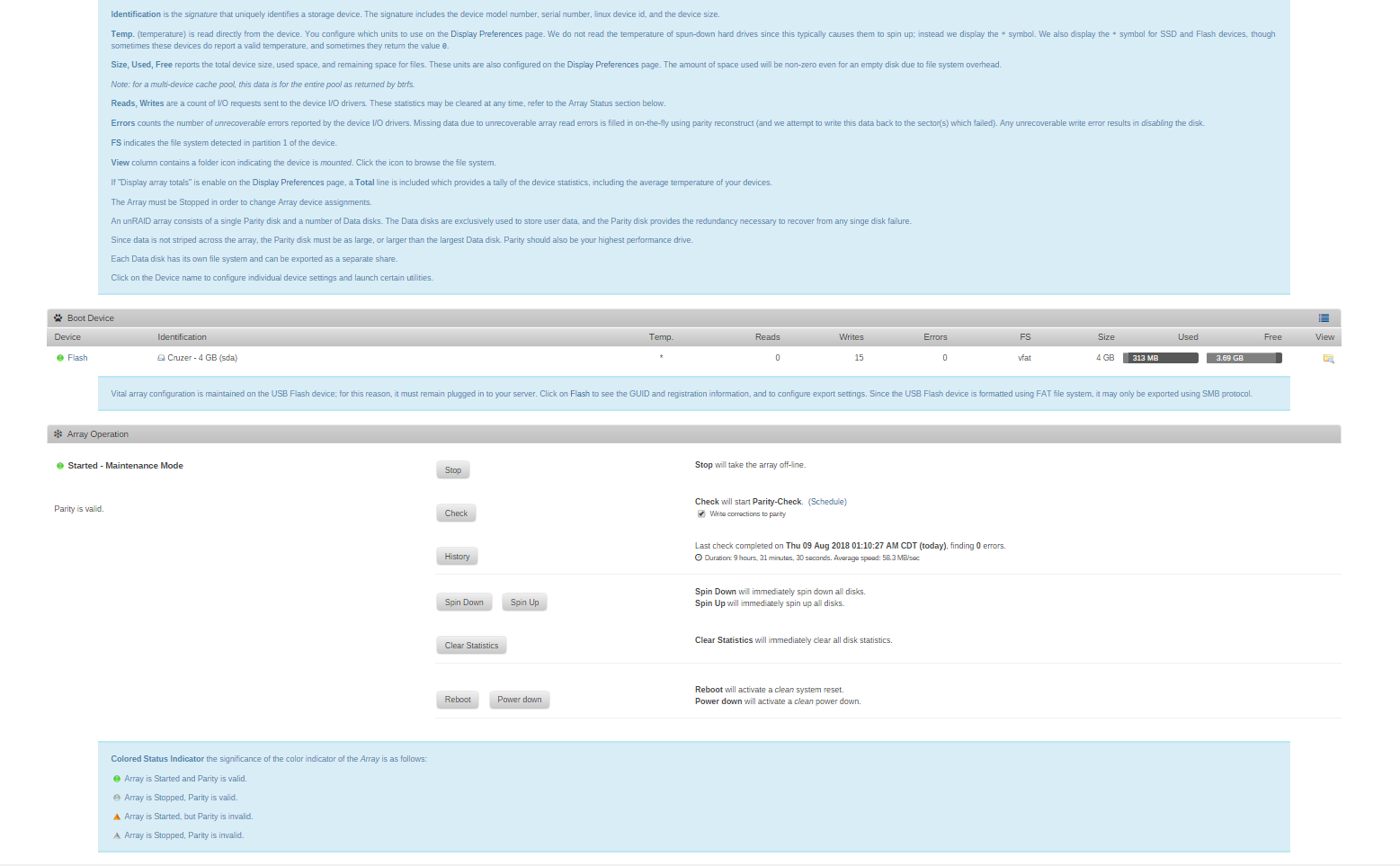

The array needs to be stopped to change the format type. I'd recommend setting them all the XFS. If they were XFS before, and you changed them to reiserfs, you need to check the box that says to format and confirm.
Post a screenshot of the whole main GUI, not just the disks.
Here is a shot of the lower half of the Main GUI.

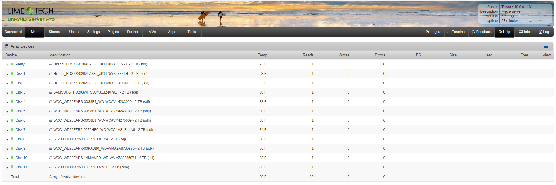

I have changed all the DATA disks 1 - 11 to XFS. The disks were previously format type reiserfs.  I assume the XFS will be a suitable format going forward.  Please let me know if there are any real tradeoffs.

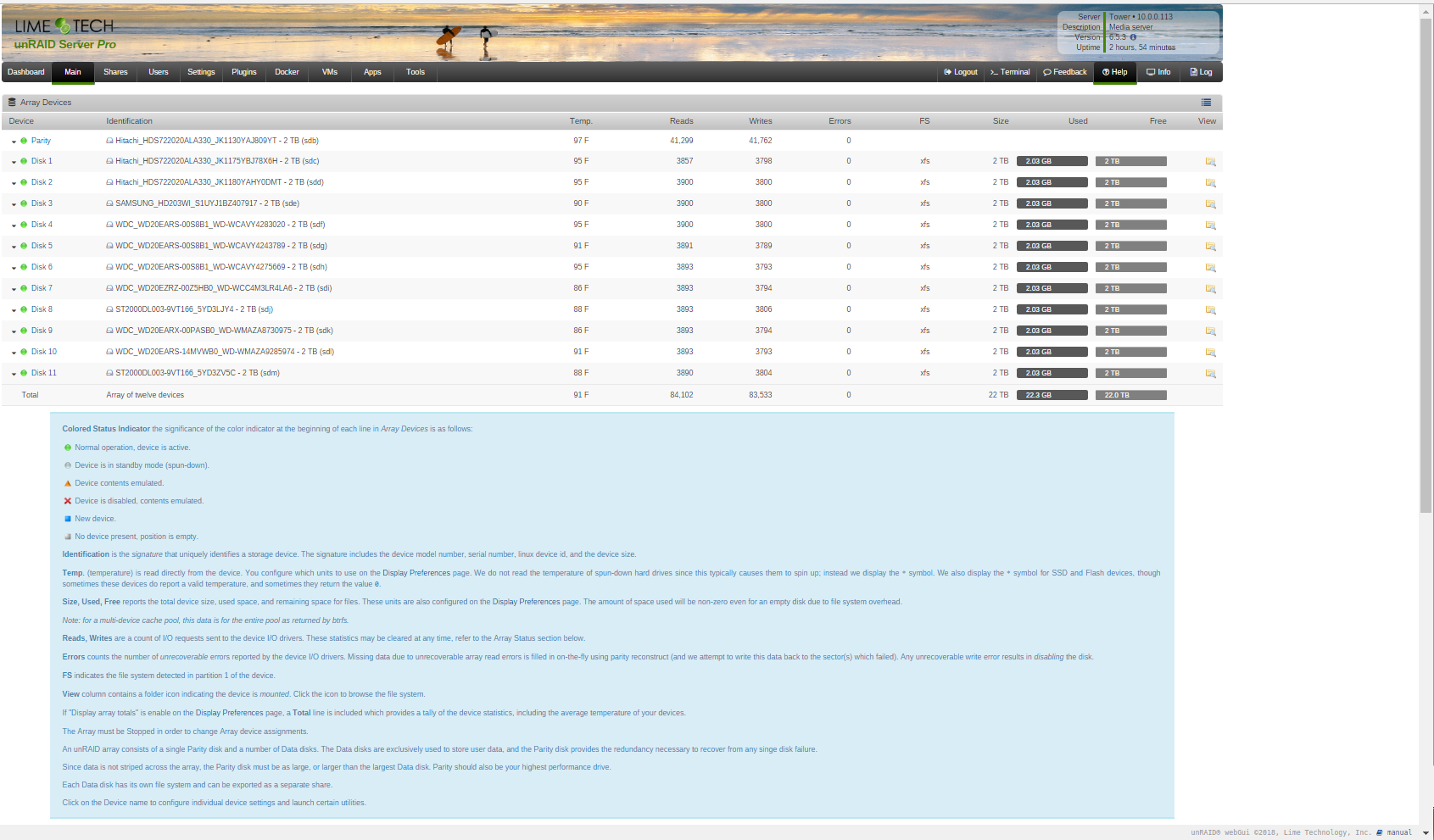

Here is the screen capture prior to submitting them to be formatted.
Yes. In fact, ReiserFS is specifically not recommended any longer.
Looks good. Check the box to format and start the array. It shouldn't take a very long time for the format, since it is only creating (writing) the empty top level folder on each disk. Nothing else gets changed on the disk but all those old bits will no longer be part of the filesystem. And parity will still be valid after the format since it is updated on all write operations.

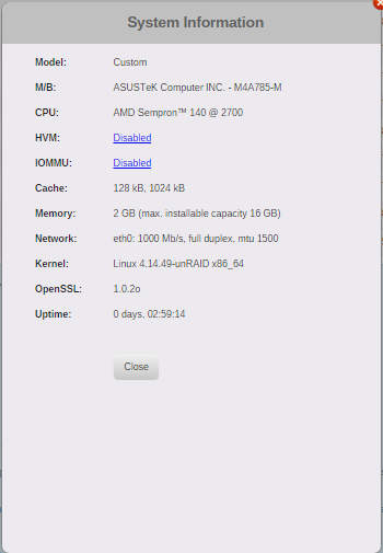

So you weren't even running V6 before now? Since you didn't mention it and didn't post in the Legacy subforum I assumed you were already on V6.

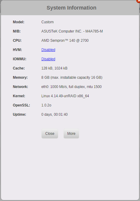

Not really enough RAM for the new features, and maybe not enough CPU for dual parity. Can you add RAM? That is going to be cutting it close for V6.
Larger disks should be fine and you might even consider larger, fewer disks. 2TB is pretty small these days. Newer, larger (denser) disks also perform better. And fewer disks means fewer points of failure

Today I purchased and installed addtional memory for the Tower.  It installed and booted up fine.  Was 2 GB, now 8GB.
