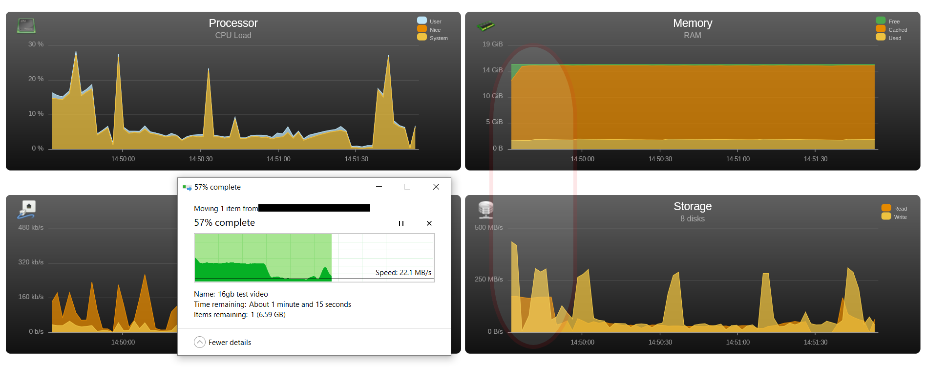

Same speed issue though... 417145450_towerslowdown.PNG.17e923b21f40fa3601ece23145c073ab.PNG

Transfer is going to cache, so nothing to do with turbo write, check that your cache devices are fast enough and are being trimmed.

Still no changes to speed though. But if you look at my screenshot and the red little circle, when the RAM cache gets filled, the drive speeds get hammered. It's like clockwork every time. Is that expected? Or is it possible my RAM has gone bad?

11 minutes ago, Gavin10 said:
Is that expected
Yes, and they can't handle it, hence the problem, enable turbo write and disable cache for that share, then transfer directly to the array, you should get 100MB/s +
