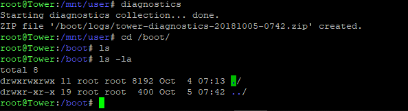

Can't access the boot drive from ssh. I ran the diagnostics and it created the file but unable to see anything in /boot. see attached
Your USB drive went off-line. Try a different USB port, preferably USB2. Reboot required.

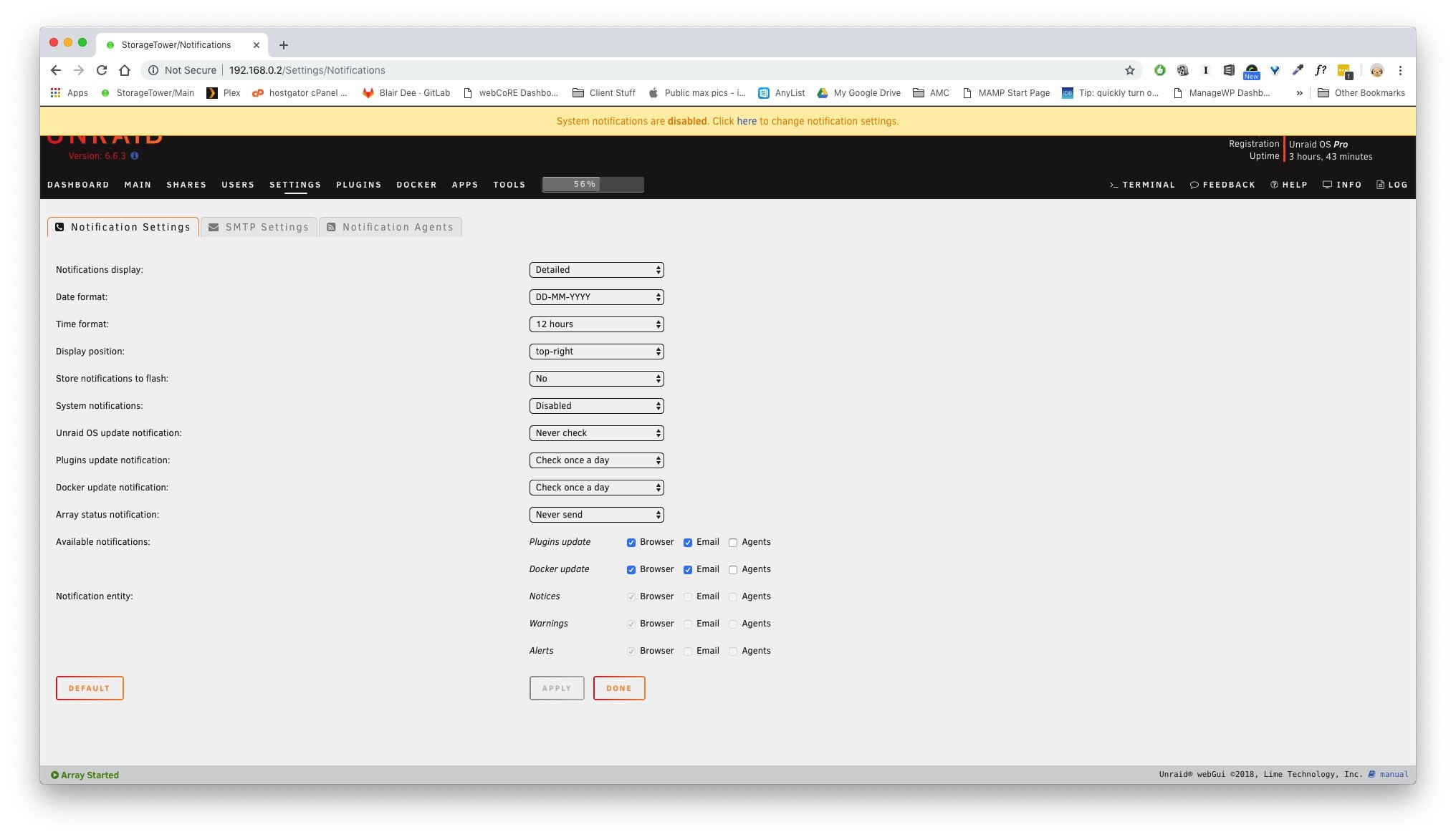

i just update to 6.6.3 and it looks great but I have a banner at the top of the page that says "System notifications are disabled. Click here to change notification settings" but as far as I can tell, I DO have system notifications enabled, and i don't see any way to make this banner go away.  any ideas?
2 hours ago, bdee1 said:
any ideas?

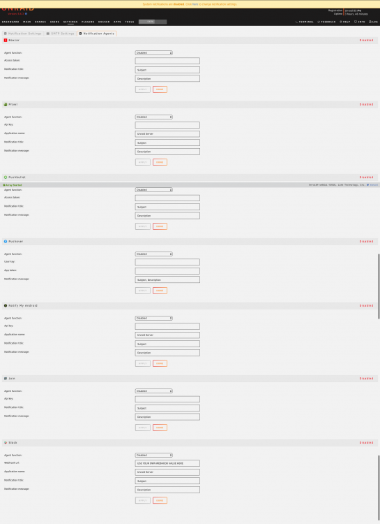

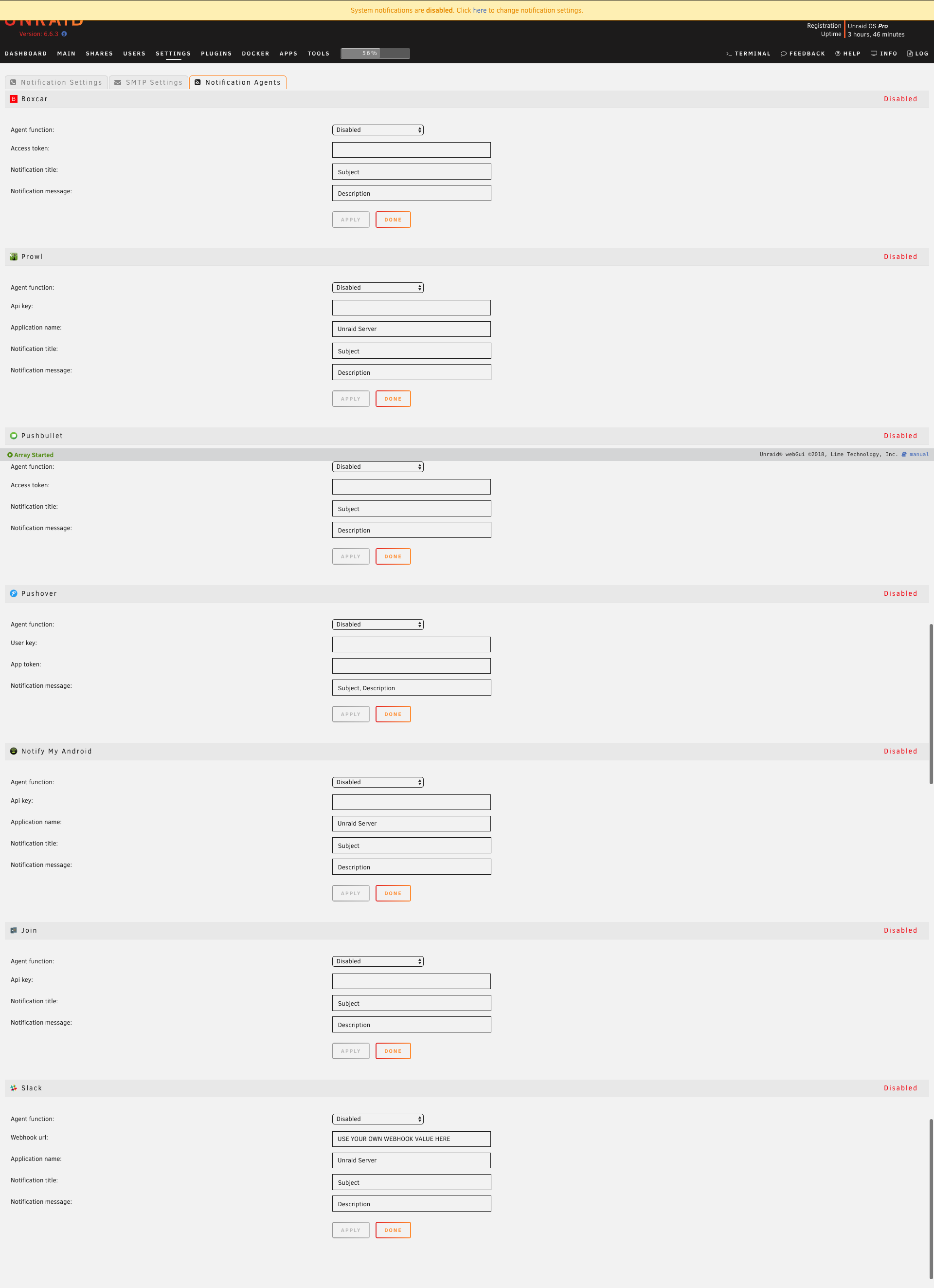

Diagnostics and screenshot of your notification settings
Can't remember exactly the qualifications for that banner, but it's probably talking about system notifications being disabled.
First screenshot, System Notifications, set that to at least 'Browser'.  Prob we should just enable that by default.
ohhh DUH - not sure how I missed that one.  thank you!😳

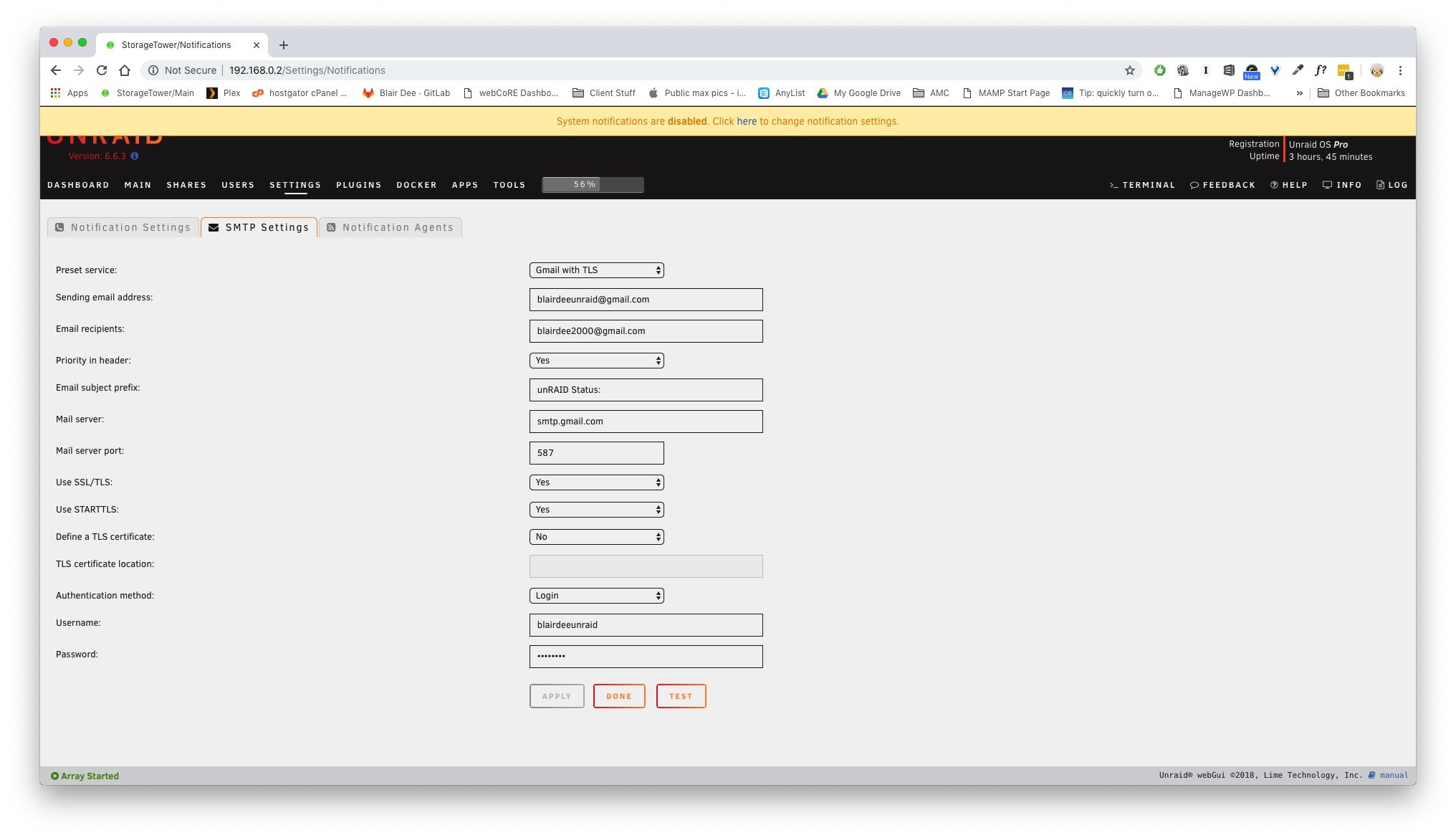

But you really want it set to email or some other agent so you will be notified when you have a problem immediately and not wait until you open the webUI possibly days or more after it happens. Many people have gotten themselves into a situation where they had multiple problems, which put their data at risk, because they didn't know they even had the first problem.
yes that is a very good call - I have done exactly that.  thank you.   After turing this on, I got a few alerts telling me that some of my disks were almost full.  I had several other disks that had lots of free space so I added those to the user shares that were filling up disks.
is there somethign I can do to move the file more evenly across the disks in the user share now that I have added the new disks?

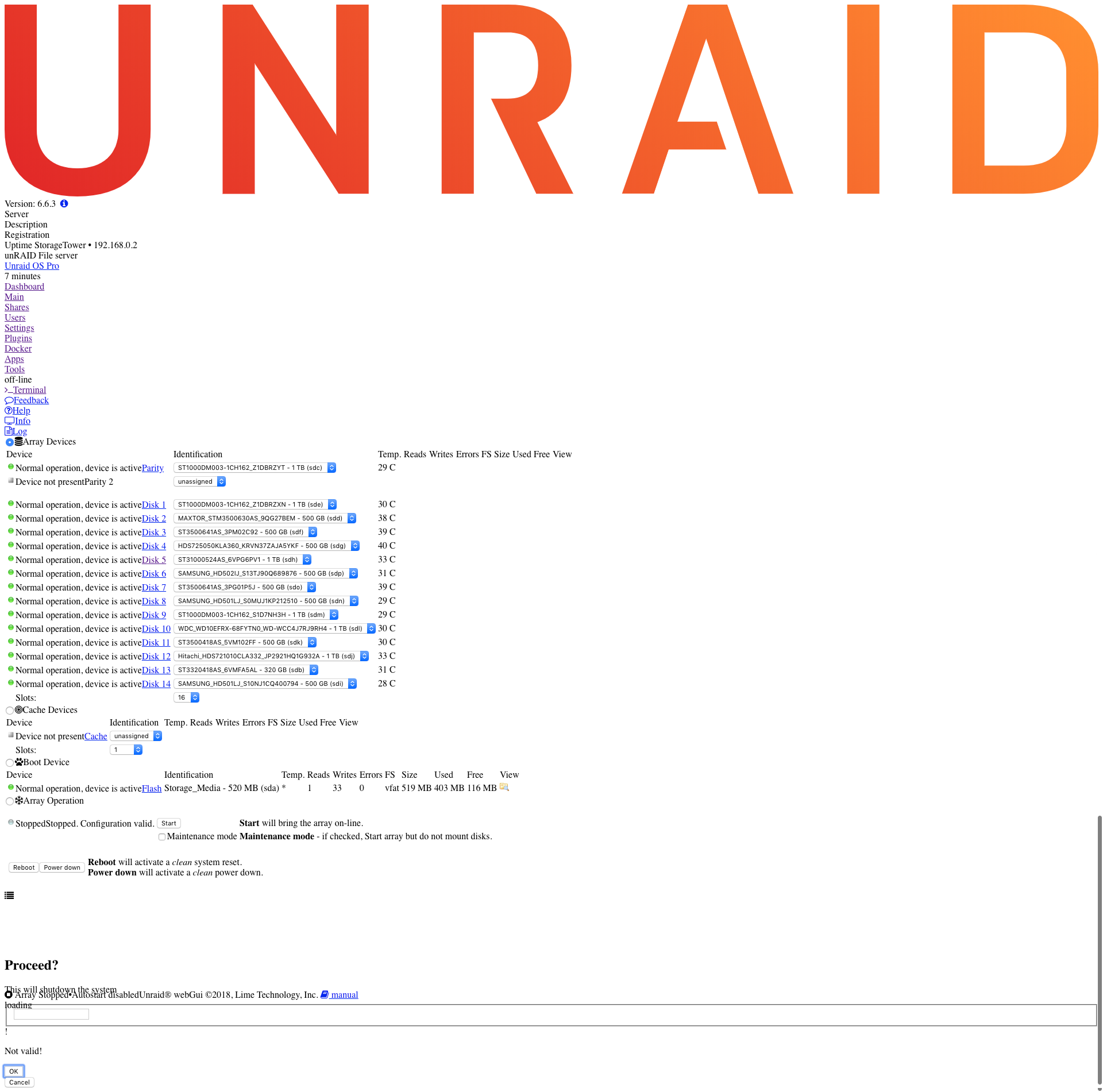

just loaded my GUI and it looks like this.  (see attached) . any ideas?
Looks like a browser problem. Clear browser cache. Whitelist your server in your adblocker. Try another browser.
Yes!  I created a separate email account just for this purpose.  It sends the alerts to my regular email.  But I have a full history of all messages in the dedicated account.
