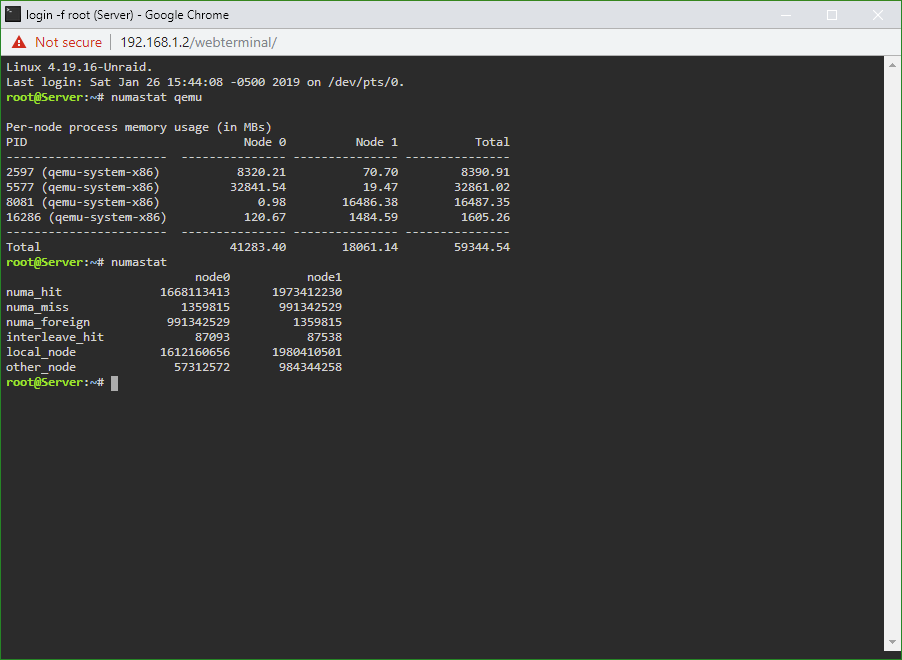

After doing that I get this now when running numastat -c qemu.
I was gonna us the "strict" option but it didn't seem to really work or anything.
After a little playing around I decided to move my 32GB or RAM Plex Media Server VM to my Node 0 which is GPU Accelerated.
I moved my 16GB of RAM Gaming VM to Node 1.
I moved my pfSense 8GB of RAM to Node 0.
My Ubuntu Server VM which is 16GB of RAM which isn't mission critical to have high performance I just have it set the normal without the "numatune" section added to the XML file.
Here it is now.
Some of the VM is getting put in to the other node but I think that's the RAM being used for the QEMU service and the RAM in the Node is equal or larger than the allocated memory.

On 1/26/2019 at 11:14 AM, AnnabellaRenee87 said:
So did exactly what @limetech said to do then rebooted.
I went into my XML file for the VM I'm working with and added this to my XML after the cputune section.
  <numatune>
    <memory mode='preferred' nodeset='1'/>
  </numatune>
Here it is now.
You can read more about how to use this in the following sites/threads.
https://access.redhat.com/documentation/en-us/red_hat_enterprise_linux/6/html-single/virtualization_tuning_and_optimization_guide/index#chap-Virtualization_Tuning_Optimization_Guide-NUMA
https://access.redhat.com/documentation/en-us/red_hat_enterprise_linux/7/html/virtualization_tuning_and_optimization_guide/sect-virtualization_tuning_optimization_guide-numa-numa_and_libvirt
So far everything looks to be good but I need to do some testing on the VMs to see if its fixed any performance issues.

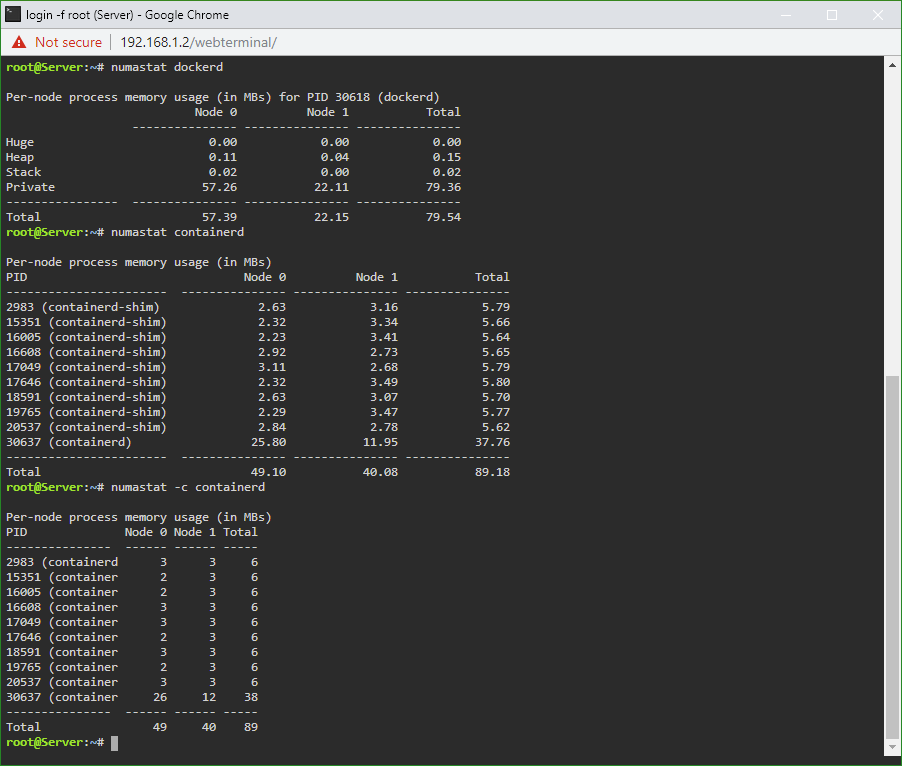

A quick check and everything looks like it's working great.
The point of NUMAD was so we could move VMs to NUMA Nodes vs having them split between NUMA Nodes because it causes lag when something has to go between CPUs or goes from one NUMA Node to the other.
I think all my dockers are going to whichever Node is available. Don't know what the exact process is for docker containers. (docker, dockerd, containerd, etc)
