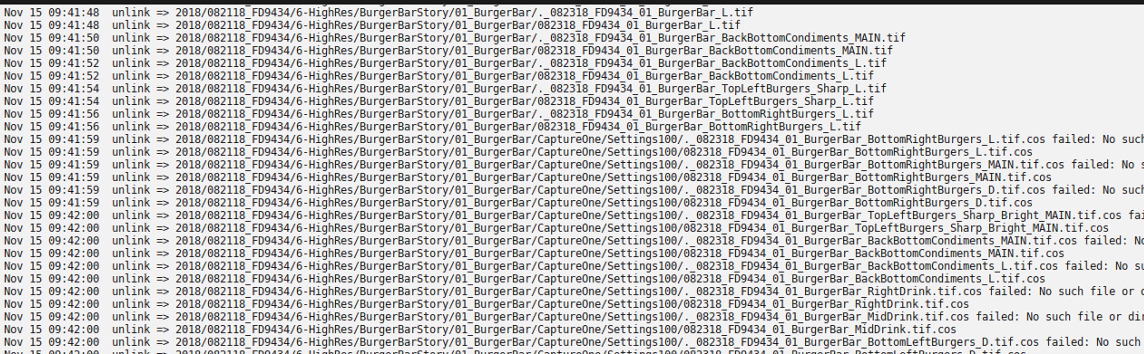

If it helps I am seeing loads of files being Unlinked in the Recycle Bin logs, some say failed: No such file or directory and others say unlinked without any explanation:

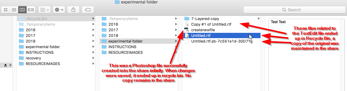

1) the same tests were performed with TextEdit but no matter what I did to the file, it was never deleted. However, Copies of the .RTF file ended up in the recycle bin....
2) I opened up Photoshop CC saved a New photoshop file on the Unraid SMB share and it was able to Save it for the first time initially. When I made a change to the file and saved again, the file once again was deleted (ended up in Recycle Bin)

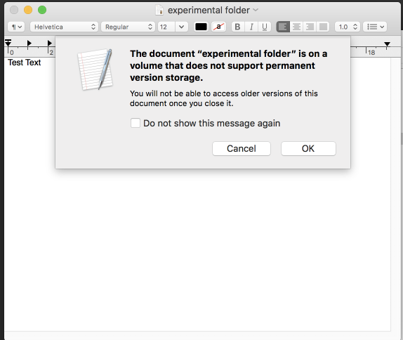

When I went to exit TextEdit, I got this error message. When I opened the file a second time, the filename was changed from Untitled.rtf to experimental folder.rtf. See second attached image.
