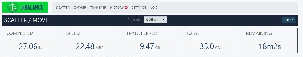

   I've struggled with this issue for awhile, everytime I think I finally have figured it out I'm proven wrong.  Currently I'm using Unbalanced to empty the contents of a drive.  It's plodding along at 22MB/s.  If I transfer that same content to an external USB3 drive and then copy it back to the array I'll get 130+ MB/s, why?  I do not use the cache drive for any file copies, so that isn't it.  I have reconstruct writes enabled, all my drives are connected at sata 6g, I am not cpu/ram limited (96GB of ram, dual xenon) so what gives?  This is the one issue I have with unraid that really bothers me.  I get that I am not going to get the same performance as a raid 5 array but, when I can do a parity sync and average 140+MB/s and a file copy can't manage half that something seems very wrong.  Any one have ideas?

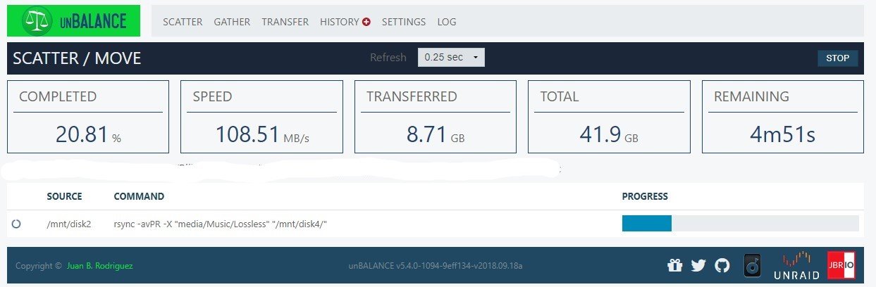

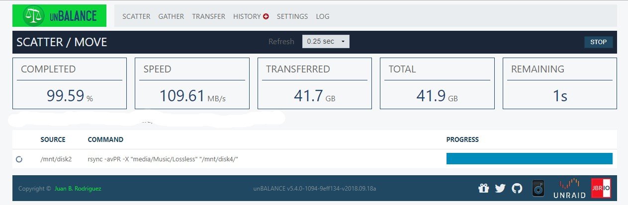

Sorry, real life pulled me away for a bit but I came back to finish moving data off that drive and thought I would give another example of why the randomly crappy writes are sooooo annoying.
Here is another set of screen shots, same exact two drives (Source is a 7200rpm seagate 6TB approx 2yrs old and destination is a brand new 8TB WD White Label Red) and as you can see decent transfer speed and it actually got slightly faster as it went on.  It's this random, can't really explain why its totally slow as molasses one time and about what I would expect another that is really getting to me..  I have the same issue with my monthly parity syncs as well.  One time they will finish in about 15 hours averaging 140+MB/s and the next time they will run for almost 30 hours with a average speed of 77MB/s.

Also, it can vary with file size it's transferring, the smaller the average size, the lower the speed.

Yes actually, I did read them.  Neither of them really explain the massively random difference in transfer speeds that I see.  I mean 22MB/s vs 108MB/s is a pretty wide margin is it not?  You would not be wondering if there was something seriously wrong if you frequently saw a swing like that moving files around?  By the way, that first transfer was my kids movie folder, so all fairly large files.  That second transfer as you can see is music.  Obviously much smaller individual files and yet its FASTER!

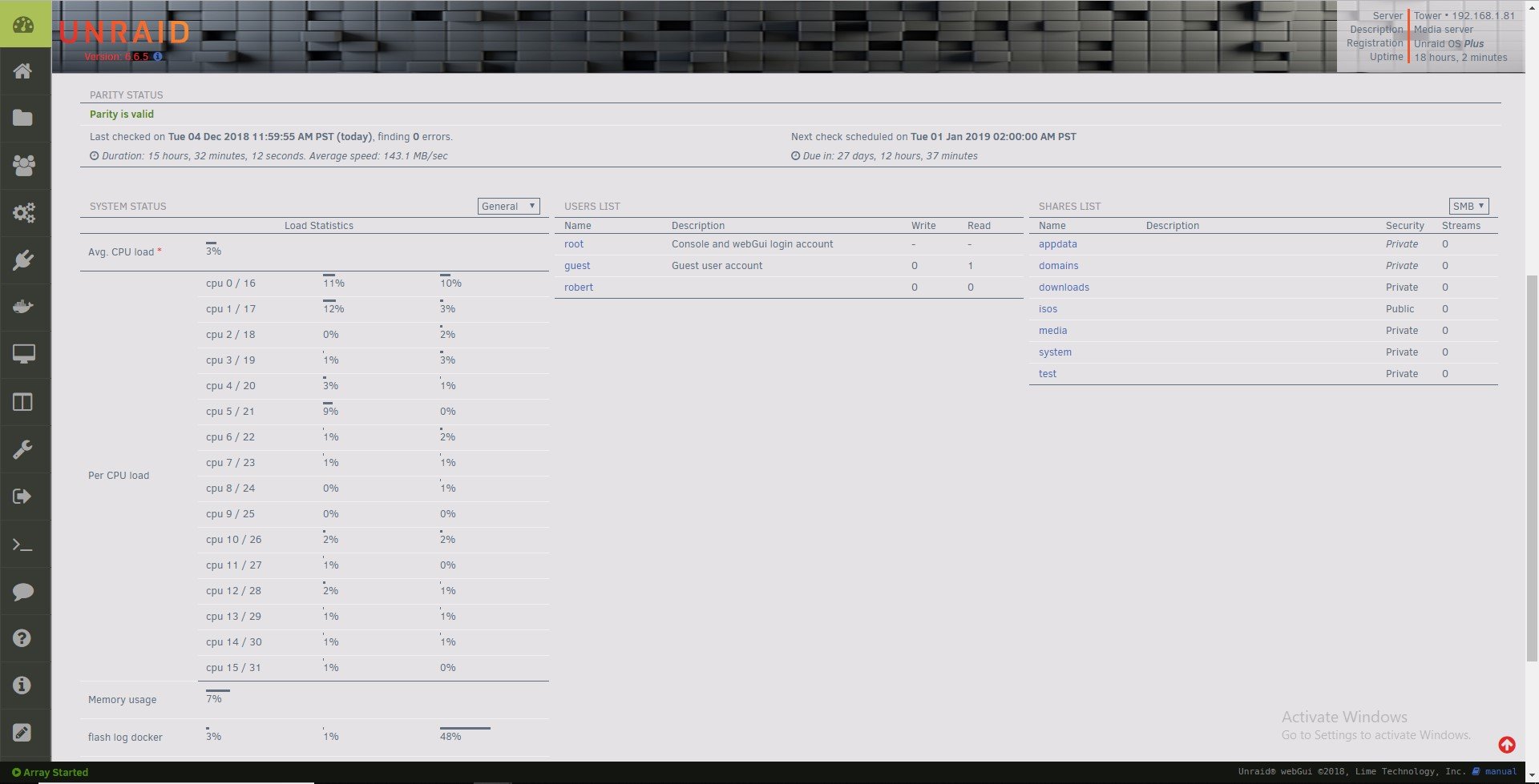

Assuming you mean parity checks, this would be a concern. Perhaps you have some bad cables or bad controllers causing CRC errors. Your diagnostics would reveal any problems like that.
