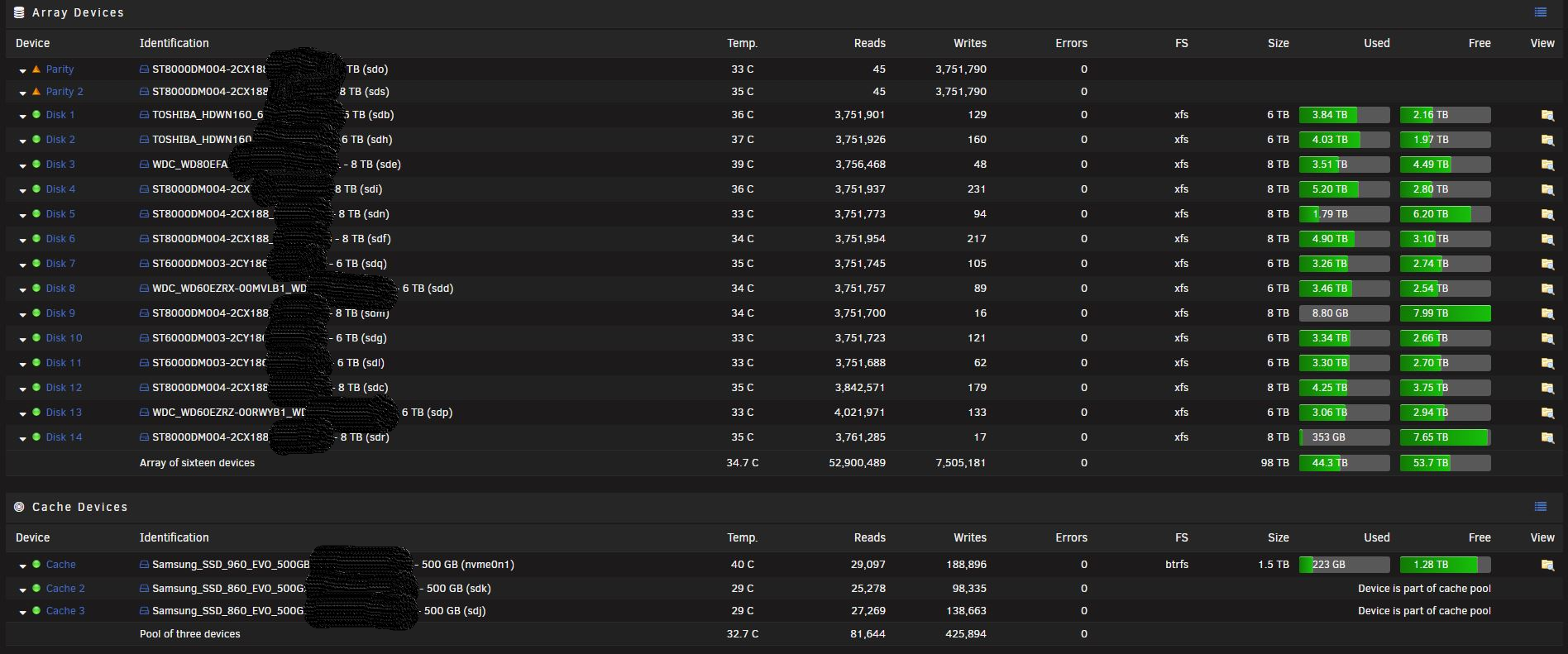

I have a UnRaid 6.6.6 server that I have been having some issues with.  I would like to know if I can just start over?  I have 14 data drives and 2 parity.  I added along the way and didn't know when first started that would make things easier is added drives in order.  I just added them and used drop down.
My case has 16 bays but my drives # don't match.  I would like to get it all matching now.  So start with Data 1-14 in each slot and add the 2 parity in last slots in case.
I am not sure if this is something I can do.  I don't want to copy 60tb of data to something else.  Also at the moment I don't have extra storage laying around to use for this.

Just not sure how to go about this.  All my slots in server have drives.  Not sure how can do this without losing data etc.  I am rebuilding parity right now as I type for next day.
So right now my 2 parity drives are in slot 1 and 2 of server case.  I was going to move them to 15 and 16.  Then get my others to line up so Disk 1 in Unraid would match to slot 1 in case.

  1. make a printout / copy of this snapshot on a standalone system like a phone or laptop
  2. Power down if you need to see the drive's serial# to label them.
  3. Label the physical drives against the snapshot (matching the screen shot)
    • Disk #1 -> Toshiba #1
    • Disk #2 -> Toshiba #2,, etc.
    • etc
  4. Move the disks as you like into the physical slots (Drive#1 -> slot#1, etc)
  5. Poweron Unraid.
  6. Done
Unraid recognizes by serial number, so moving disks around by the slot, connecting cable should not change with how the disk is recognized.
Parity 1 will always valid even disk order change, only parity 2 need rebuild. I would suggest make array from 2 parity to 1 parity and then rearrange slot and add back parity 2 as usual.

So am I understanding this correctly if I drop to 1 drive parity for now. I can then do new config and change drives around in any order.
Yes

  1. pull out array disk 1 - you'll see disk #1 in the screen become marked as missing
  2. pull out disk in physical slot/bay 1 and swap with disk#1 -both disks will then appear in their original logical slots.
  3. repeat for all the drives - until all the drives are in the bays you want them to be in.
  4. start the array
There. done.

If all you want is to move the disks in the case but don't need to change the actual disk (serial number) assigned in the webUI then just move them in the case. Unraid doesn't care, it only looks at the serial number to keep them assigned correctly.
I usually use the word "bay" to refer to a location in the case, the word "port" to refer to the connection, and the word "slot" to refer to how they are assigned in Unraid. If you ever take a look at your syslog you will see Unraid listing the assigned disk inventory by their "slot".
1 minute ago, Benson said:
I think OP also want sd'x' in order, all physical slot and logical slot also match order.
Now you've done it. You dragged sd'x' into the discussion, which is totally irrelevant and not even guaranteed to be consistent from one boot to the next. It is the md# that corresponds to a specific disk serial number.
Also, the very reason you have to rebuild parity2 if you change the disk order is because it must be calculated from the disks themselves in the order they are assigned. If it can be calculated from parity1 alone then how could the order possibly matter?
Sorry OP if this has gotten confusing. Just move them to whichever "bay" you want and forget about it. Unraid won't care if you don't change the actual disk (serial number) assigned to each "slot" in the webUI.
Well thanks all for the info. I dropped to 1 parity drive for now since had to replace parity 2 drive due to failure.
So after rebuild tomorrow I should be able to shut down array and move my parity 1 to bay 15. I’ll use bay 16 for parity 2.
Then move over all my other drive around so disk 1 will match up with drive in bay 1 and so on and on...
