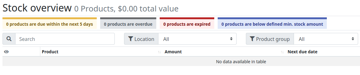

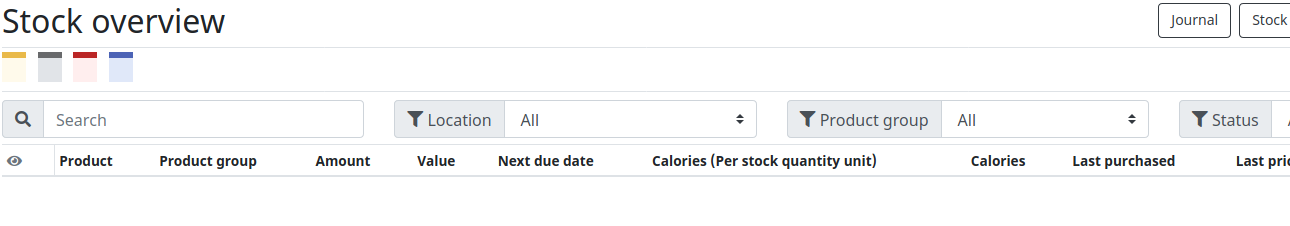

From the deafening silence here, I'm guessing nobody else's container partially broke on the 3.0 update? Apparently there is something incompatible in my appdata, because a fresh pull of the container on a different server works properly and looks like this
But my both my active version and fresh pull look like this after I copy my appdata to the fresh pull.
Shopping list and recipes are similarly borked.
Any ideas what I need to nuke or rebuild from my appdata? I would love to import my items, but apparently backup and restore aren't a thing, unless I dig into the database manually.
It's something in the ./data subfolder.
Tentatively fixed, I overwrote the config.php file with a copy from the fresh pull, and it looks normal so far. Fingers crossed.
