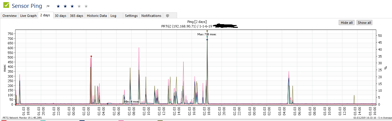

Yesterday i got very high ping ingame, and i also had between 1000-2000 ping to my router internally. So i shut down the unraid box and unplugged it from the network. This fixed the ping issue. I have attached a picture provided by my isp which shows the ping from them to my router. I unplugged the unraid box around 6pm (I replugged the unraid box 4am).
