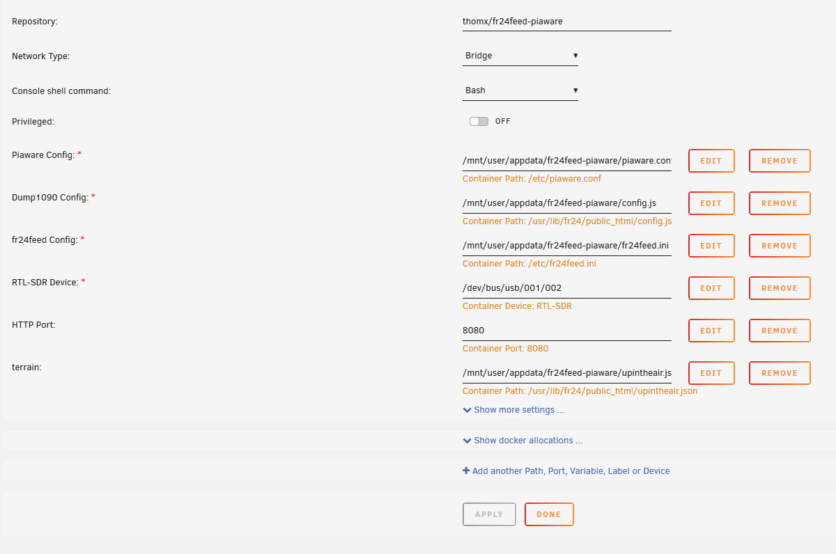

I'm following your stetps as you describe:
Downloaded and edited the config.js changing only the LAT and LON values.
Downloaded and edited the fr24feed.ini adding the fr24 key
Downloaded and edited the piaware.conf adding the user password and ID
Created a upintheair.json.
The binding are host file path to your template defined container path, I didn't change anything.
The port binding are untouched, as you can see at the screen capture.
I attached the container log and the screen captures of what I'm getting. I can't understand what I'm doing wrong, I ust followed your steps one by one.
Thanks

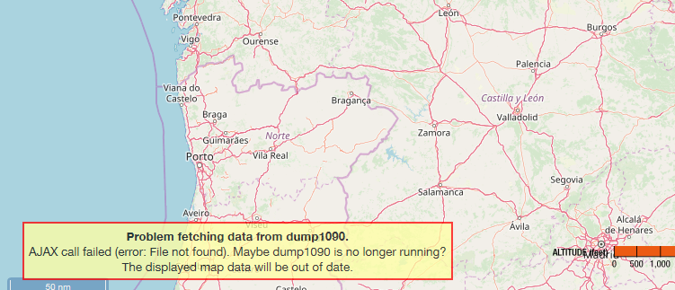

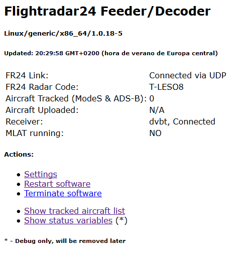

Still having some trouble. The gmap.html gives a 404 not found error, MLAT is not starting and same error getting aircrafts
GET /data/aircraft.json?_=1563474594589 HTTP/1.1" 404 -
code 404, message File not found
I have manually created the file on the /usr/lib/fr24/public_html/data path (by the way, the folder is empty) and the error disapears but the feeder is not writting anything on that file so there is no tracked planes...
I think something is not being configured properly by the initial script....

Apologies because I am quite new to this too, but I've not managed to get the WebUI to work.  I receive;
Error response
Error code 404.
Message: File not found.
Error code explanation: 404 = Nothing matches the given URI.
I know it's working as I am tracking aircraft on both piaware and fr24, and I can view my tracking data in my account on both those websites.  I followed your instructions, but I am not sure how to complete this part (I have already copied the file to the correct location though); "uncomment #COPY upintheair.json /usr/lib/fr24/... from Dockerfile."  Where an how exactly do I do that (I appreciate that may be obvious to most and I have been googling but not managed it)...
On piaware I am also getting no MLAT...
Any pointer would be great, really glad I have this running though, saves me a separate box in the house!  Thank you.
Edited by craig_read

Seems we have the exactly the same issue then... I'm not alone!

Thanks, but I get same results, no gmap.html and no aircraft.json....
I thinks this is something about permissions... but I can't figure it out how to solve it.
