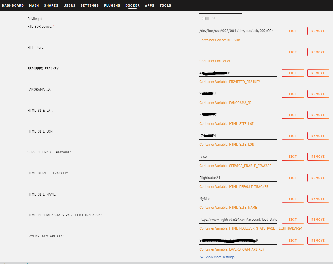

I was able to get this container to work based on @ufo56 comment that the config files aren't used anymore. I removed those from the container variables and only have the following.
Identify the USB port and device ID on your unRAID server from the command prompt with the lsusb command:
# lsusb
Bus 002 Device 004: ID 0bda:2838 Realtek Semiconductor Corp. RTL2838 DVB-T
Variables:
RTL-SDR Device: /dev/bus/usb/002/004:/dev/bus/usb/002/004
HTTP Port: <blank>
FR24FEED_FR24KEY: <own key>
PANORAMA_ID: <optional>
HTML_SITE_LAT: <required>
HTML_SITE_LON: <required>
SERVICE_ENABLE_PIAWARE: false
HTML_DEFAULT_TRACKER: Flightradar24
HTML_SITE_NAME: MySite
HTML_RECEIVER_STATS_PAGE_FLIGHTRADAR24: <optional>
LAYERS_OWM_API_KEY: <optional>
Edited by Jbiss

it can not be done with just this. i have tryied many many things, also "enabled the epprom always active" but to find out it needs the new driver to get it to work.
apt-get install git cmake build-essential libusb-1.0-0-dev
Reading package lists... Done
Building dependency tree... Done
Reading state information... Done
E: Unable to locate package build-essential libusb-1.0-0-dev
E: Couldn't find any package by glob 'build-essential libusb-1.0-0-dev'
E: Couldn't find any package by regex 'build-essential libusb-1.0-0-dev'
if you can help more you are more than welcome :)
That’s a bit odd, my setup was exactly as I noted above and I believe this is the new driver using this Git:
Type in 'git clone https://github.com/rtlsdrblog/rtl-sdr-blog' and hit enter
I can’t recall seeing this lib error (build-essential libusb-1.0-0-dev) on mine but it ran through the settings just fine beyond that part.
can someone please help me in german / kann mir jemand bitte auf deutsch helfen
Ich hatte hier schon versucht Hilfe zu finden:
Es funktioniert nicht und ich weiß nicht wie ich es zum laufen kriege
Dear community, I'm too stupid to get this docker to work and my English is too bad to understand what it takes to make it work. I've tried it 4 or 5 times now with no luck. I had used the German "instructions" by @mgutt here:
I was able to establish a connection to flightaware at least once, but it broke and it hasn't worked since then. According to the instructions mgutt refers to, install the docker fr24feed-piaware and then register with flightaware: https://flightaware.com/account/join/ and then runs the following command lines in Docker Terminal:
docker run -it --rm \ -e "SERVICE_ENABLE_DUMP1090=false" \ -e "SERVICE_ENABLE_HTTP=false" \ -e "SERVICE_ENABLE_FR24FEED=false" \ thomx/fr24feed-piaware /bin/bash
In my case, FlightAware automatically recognized my "transmitter" and added it to my account. Not such a nice side effect, another Docker was created under Unraid with some strange name. and I can neither call up the WebUI over 8080 nor over 8754 to set anything there.
Another user told me I could store the commands directly as a variable in Docker, then I save myself the input via the terminal and don't get such a strange additional docker. So I'm into the guide: https://hub.docker.com/r/thomx/fr24feed-piaware and used FlightAware's variables and entered them as follows:
Since I'm basically not sure whether the way I installed and set it up is correct, I can't rule out that the error is already there. Finally, the instructions are much more complex than what I did.
I don't even know what this FEEDER DASH ID is. Is it the unique identifier I entered there or is it just my FlightAware username.
When I look at your pictures of your setups, it looks fundamentally different and there are values that do not match those I used for FlightAware.
I was able to start Docker with the settings and it is running - although there are a few entries in the log that probably have errors.

This error is displayed to me:
2022-12-17T15:29:33+01:00 Tower /opt/confd/bin/confd[101]: ERROR rename /usr/lib/fr24/public_html/.config.js099368113 /usr/lib/fr24/public_html/ config.js: file exists
and as a warning:
s6-rc: warning: unable to start service confd-html: command exited 1
But I have no idea what that means or how I should correct it.
Needless to say, I still can't access the 8080 or 8754 and with flightaware, no active ads-b "sender" is displayed to me either
So to summarize: How can I get the WebUI over 8080 and the admin page over 8754?
How do I get the transmitter running and connected to flightaware?
What are these errors and above all - how do I have to install and configure it under Unraid so that it works?
IS THERE REALLY NONE OF ME THE VIA PN CAN EXPLAIN IN GERMAN

2023-04-11T12:39:26+02:00 f1ee367061cd /opt/confd/bin/confd[90]: ERROR rename /usr/lib/fr24/public_html/.config.js847656311 /usr/lib/fr24/public_html/config.js: file exists
2023-04-11T12:39:26+02:00 f1ee367061cd /opt/confd/bin/confd[90]: FATAL rename /usr/lib/fr24/public_html/.config.js847656311 /usr/lib/fr24/public_html/config.js: file exists
s6-rc: info: service adsbexchange-feed successfully started
s6-rc: info: service adsbexchange-stats: starting
s6-rc: info: service adsbexchange-mlat: starting
s6-rc: warning: unable to start service confd-piaware: command exited 1
s6-rc: warning: unable to start service confd-fr24feed: command exited 1
s6-rc: info: service adsbexchange-mlat successfully started
s6-rc: info: service adsbexchange-stats successfully started
[dump1090] Tue Apr 11 12:39:26 2023 CEST  dump1090-fa v8.2 starting up.
[dump1090] rtlsdr: using device #0: Generic RTL2832U (Generic, RTL2832U, SN 77771111153705700)
[dump1090] Found Rafael Micro R820T tuner
[dump1090] rtlsdr: tuner gain set to 49.6 dB (gain step 28)
[dump1090] Allocating 4 zero-copy buffers
Has anyone the same issue and knows how to solve this?
