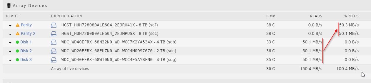

Hello,
I just added new drive to my array, 8TB HGST he8.
Before adding the new drives to expand the array, I added 2 8TB drives for the Parity but the build speed is super slow.
My specs are i7 7700 12Gb Ram and an arrangement of RED + HGST He drives. Everything is plugged into the 6 SATA ports of my motherboard, no SAS card yet.

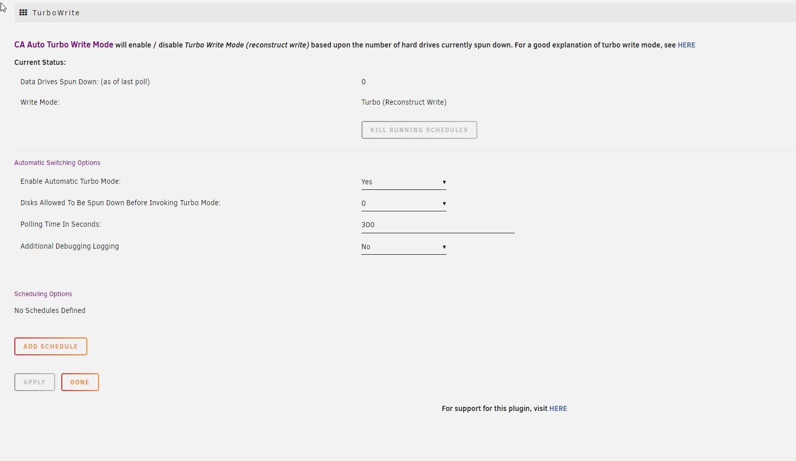

Then I installed the Turbowrite plugin as suggested here
but the speed is not changed at all, exactly the same.

I get that but none of the disk has a read/write speed of ~50mb.
The HGST where around 130mb/s (7200rpm) during the preclear, and the REDs average read/write are 100+
And I am talking about Parity initial build so it should be
read speed of all disk from array --> write speed of HGST (Parity)
I am not writing to the array like copying from my computer to the array...
Edited by yendi

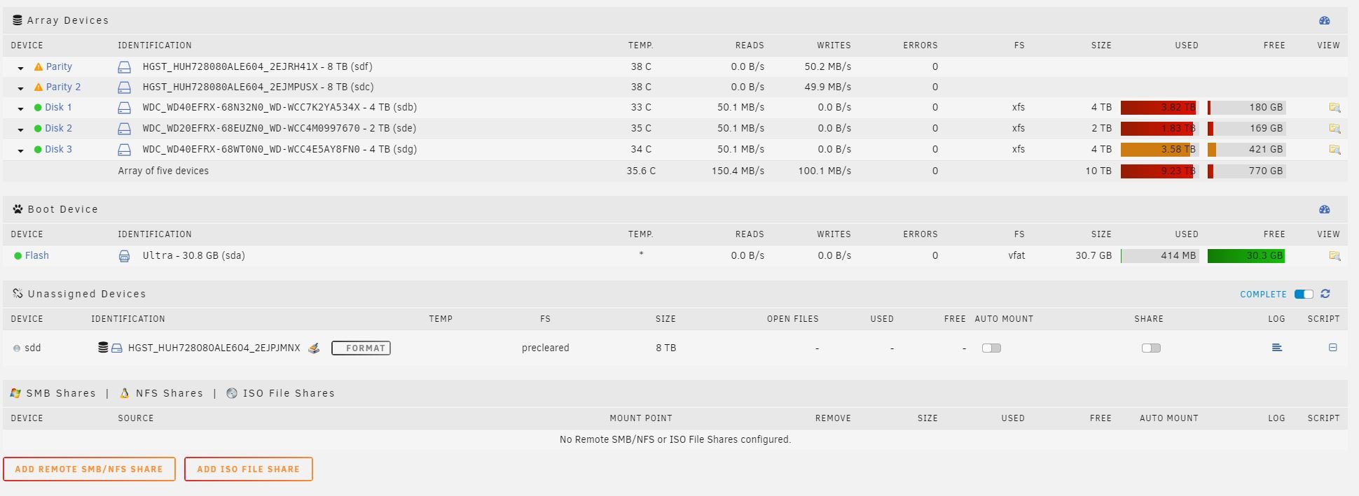

But as my RED are only in storage and the HGST in Parity, as I am doing a Initial parity build, I am not writing on the REDs, right? As a matter of fact I only see read on the REDs and write on the HGST.
Am I wrong?
929802617_2019-05-1212_44_21-unRAID_Main.thumb.jpg.238b26df56b989776022e3366c345bbb.jpg
I don't think this is the issue, I benchmarked it for 110mb/s in write speed, as all others REDs that I have.
When I was copying from Windows to my array, I manage to get way better than 50mb/s without any cache

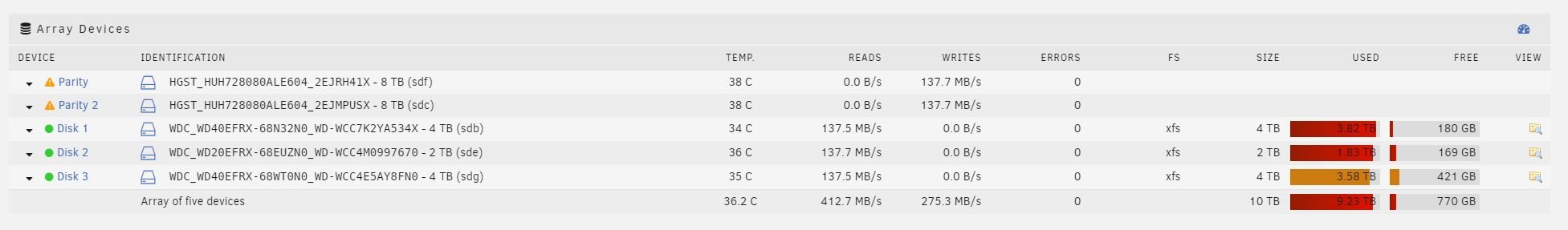

Write cache for parity disks is disabled, you can turn it on with:
hdparm -W1 /dev/sdX
Might go back to default after a reboot.

@johnnie.black You're the MVP !!!
2099533574_2019-05-1213_25_23-unRAID_Main.thumb.jpg.a5b088f54b527ea062e9efa6dc36f5d3.jpg
137Mb/s Write speed!!!
How can I make this permanent?
Thank you so much !!!
