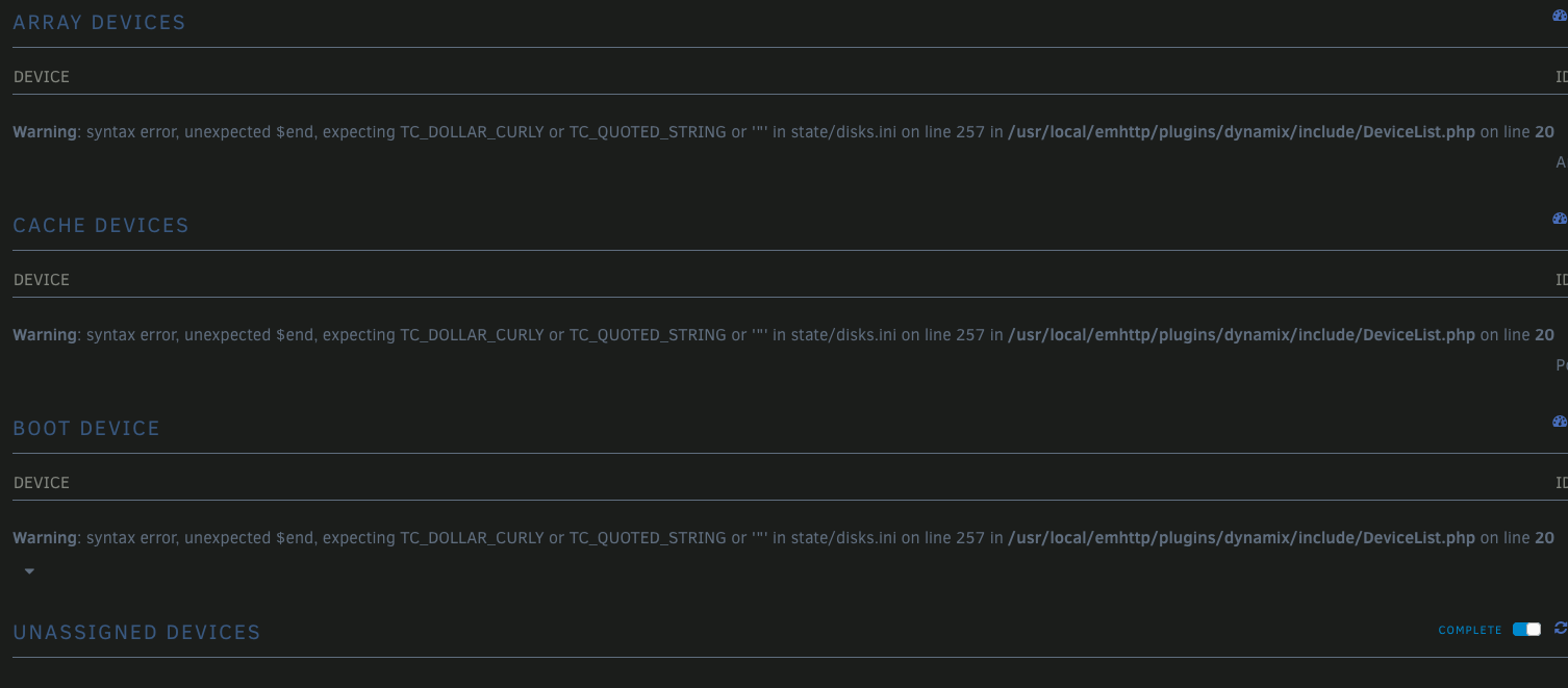

Ok, not really, but it did cause a reboot after making shares unaccessible. I was unable to download diagnostics, every time I'd click the download button this text would flash on the screen and then just return to the same page with no download initiated:
Warning: syntax error, unexpected $end, expecting TC_DOLLAR_CURLY or TC_QUOTED_STRING or '"' in state/disks.ini on line 257 in /usr/local/emhttp/plugins/dynamix/include/DeviceList.php on line 20
Additionally, green "array started" text at the bottom would flash back and forth between that an "array undefined"
and sure enough, it was. Unassigned devices went "nom-nom" on them.
578524691_ScreenShot2019-06-10at7_49_09AM.thumb.png.dfe61556ad317d7590589b264c622aac.png
fix common problems then popped up and said rootfs was full, but I wouldn't know why. nothing had changed really on the server.
