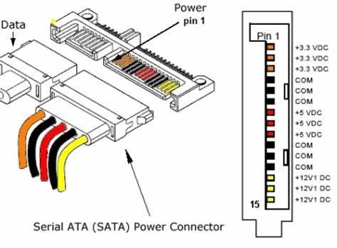

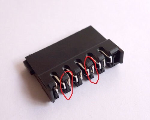

Won't loose cause, most time was SATA plug short the power and cause fire. Many case report that.
In fact, there are some design fault in SATA plug, the insulation between connector pin was too thin.

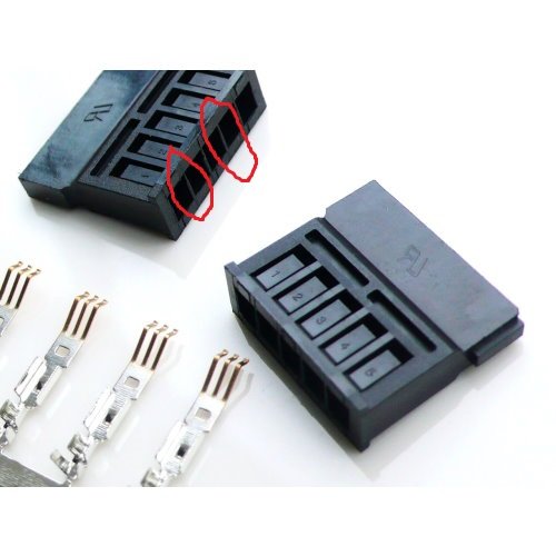

I am not sure which type must better then others, usually you will got 3 types.
I like EZ crimp type more then others, bacause insulation between connector || connector usually thicker and overall have stronger mechanical performance.
- molded type
  You can't see the inside
- EZ crimp type
- pin type
So any pin-to-pin short, means that power short to ground.
Edited by Benson

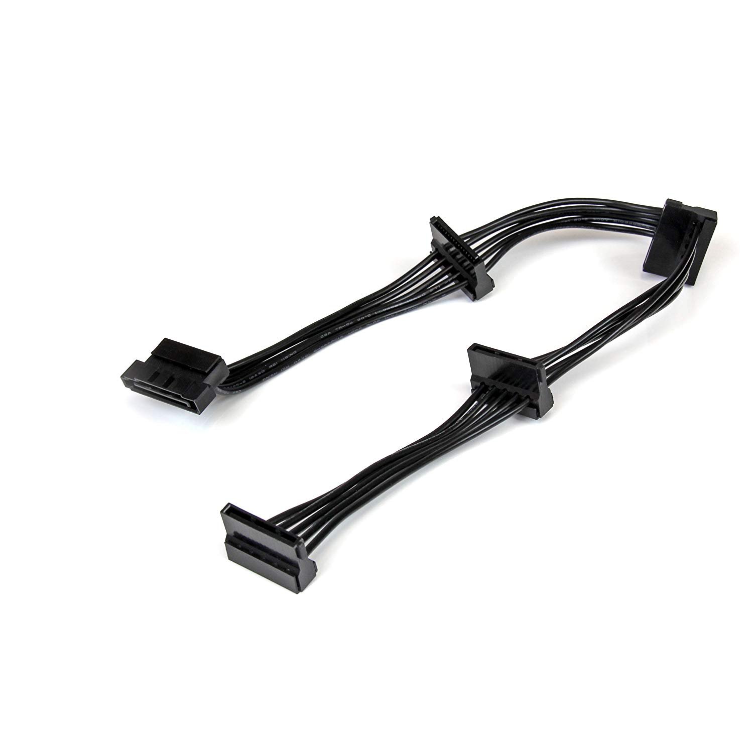

I try to avoid anything molex all together when i can, I used to use a sata Splitter I got from Amazon, seen too much horror on youtube.
Not saying those won't work, but not really recommended, 12V on SATA plug is designed for 4.5Amps maximum, 4 disks can easily require 8 to 10amps during spin up.
barely used the cable, I upgraded the PSU to something that has more sata connectors.
So does this mean that since 2 disks could need 4 to 5 amps during spin up, I shouldn't use any SATA power splitter at all for hard disks? What about 1 hard disk and 1 SSD, or 2 SSDs?
I have no problem using a 1 > 2 splitter for 2 HDDS, but wouldn't use more than 2.
