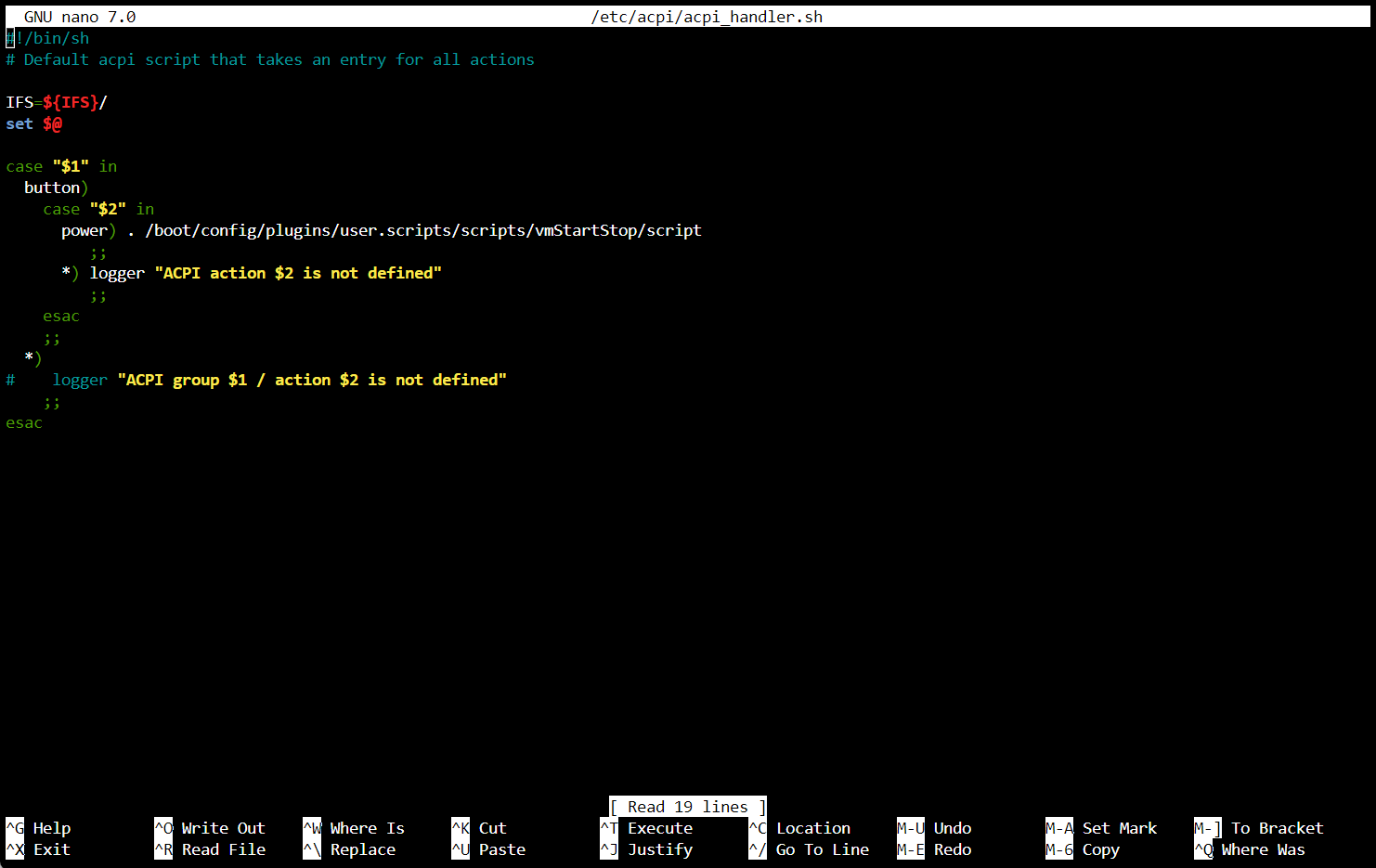

July 27, 20206 yr I know this is a slightly older thread but I thought I'd share what I've done. The power button on my rig will power the system on as normal. I'd imagine holding it once on will force a power off but I don't really want to test this - worst case, I can just pull power. If I want to shutdown the server, I use the web gui. Once unRaid is botoed, the power button will toggle my Windows VM on or off. In Windows power management, I've set it so the power button puts the machine to sleep - this makes it start up faster. First create a script in User Scripts. I called mine vmStartStop and it toggles a VM called Windows 10. #! /bin/bash # if domain is running, shut down if virsh list | grep "Windows 10 .*running" ; then virsh shutdown "Windows 10" # resume domain if it's paused elif virsh list | grep "Windows 10 .*paused" ; then virsh resume "Windows 10" elif virsh list | grep "Windows 10 .*pmsuspended" ; then virsh dompmwakeup "Windows 10" # otherwise start domain else virsh start "Windows 10" fi Than edit /etc/acpi/acpi_handler.sh as per the post above. Change the power line to point at your user script (the path is at the top of the edit script page). Don't forget the . at the start of the line: power) . /boot/config/plugins/user.scripts/scripts/vmStartStop/script Hope this helps someone. Edited July 27, 20206 yr by mtongnz

August 16, 20215 yr On 7/26/2020 at 7:06 PM, mtongnz said: I know this is a slightly older thread but I thought I'd share what I've done. The power button on my rig will power the system on as normal. I'd imagine holding it once on will force a power off but I don't really want to test this - worst case, I can just pull power. If I want to shutdown the server, I use the web gui. Once unRaid is botoed, the power button will toggle my Windows VM on or off. In Windows power management, I've set it so the power button puts the machine to sleep - this makes it start up faster. First create a script in User Scripts. I called mine vmStartStop and it toggles a VM called Windows 10. #! /bin/bash # if domain is running, shut down if virsh list | grep "Windows 10 .*running" ; then virsh shutdown "Windows 10" # resume domain if it's paused elif virsh list | grep "Windows 10 .*paused" ; then virsh resume "Windows 10" elif virsh list | grep "Windows 10 .*pmsuspended" ; then virsh dompmwakeup "Windows 10" # otherwise start domain else virsh start "Windows 10" fi Than edit /etc/acpi/acpi_handler.sh as per the post above. Change the power line to point at your user script (the path is at the top of the edit script page). Don't forget the . at the start of the line: power) . /boot/config/plugins/user.scripts/scripts/vmStartStop/script Hope this helps someone. Hello, this is very helpful! Are you able to provide any recommendations on editing the acpi_handler file on each boot? Is it just a script that runs on startup to modify that line of code? Or replace the entire acpi_handler file each time? Any example of how this can/should be done? I tried googling but am not coming up with anything that's helpful for someone without a ton of experience.
August 18, 20215 yr I have a user script that overwrites the entire file. I have it set to run "At First Array Start Only"
October 13, 20215 yr On 7/27/2020 at 2:06 AM, mtongnz said: I know this is a slightly older thread but I thought I'd share what I've done. The power button on my rig will power the system on as normal. I'd imagine holding it once on will force a power off but I don't really want to test this - worst case, I can just pull power. If I want to shutdown the server, I use the web gui. Once unRaid is botoed, the power button will toggle my Windows VM on or off. In Windows power management, I've set it so the power button puts the machine to sleep - this makes it start up faster. First create a script in User Scripts. I called mine vmStartStop and it toggles a VM called Windows 10. #! /bin/bash # if domain is running, shut down if virsh list | grep "Windows 10 .*running" ; then virsh shutdown "Windows 10" # resume domain if it's paused elif virsh list | grep "Windows 10 .*paused" ; then virsh resume "Windows 10" elif virsh list | grep "Windows 10 .*pmsuspended" ; then virsh dompmwakeup "Windows 10" # otherwise start domain else virsh start "Windows 10" fi Than edit /etc/acpi/acpi_handler.sh as per the post above. Change the power line to point at your user script (the path is at the top of the edit script page). Don't forget the . at the start of the line: power) . /boot/config/plugins/user.scripts/scripts/vmStartStop/script Hope this helps someone. here how i "overwrite" it after first array start with user scripts: #!/bin/bash sed -i 's|power) /sbin/init 0|power) . /boot/config/plugins/user.scripts/scripts/vmStartStop/script|g' /etc/acpi/acpi_handler.sh
March 10, 20224 yr Author I can't believe it's been this long but I have an update. I have a physical power button that will start, stop, and restart my VM. Here is a guide I plan on updating when I get some more time:
May 24, 20233 yr On 10/13/2021 at 9:55 PM, Adem said: here how i "overwrite" it after first array start with user scripts: #!/bin/bash sed -i 's|power) /sbin/init 0|power) . /boot/config/plugins/user.scripts/scripts/vmStartStop/script|g' /etc/acpi/acpi_handler.sh I did this but my power button still shuts down my unraid server. Any tips?
