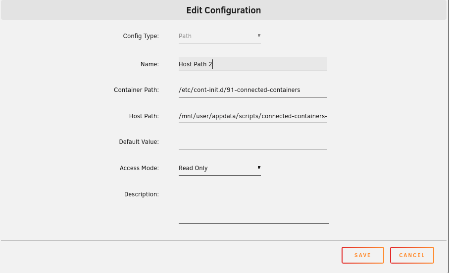

I don't really see any evidence that the script has been loaded/run/whatever in the logs, but it is accessible:
What does the startup log say? You always have to look at the log files from the container.
2 hours ago, Merijeek said:
You can see on the right that it can see the script, and that once I bounced the OVPN container it stayed up with its loopback only.
But is it executable too?
The container is also part from the VPN network correct?

Script wasn't executable, so I fixed that.

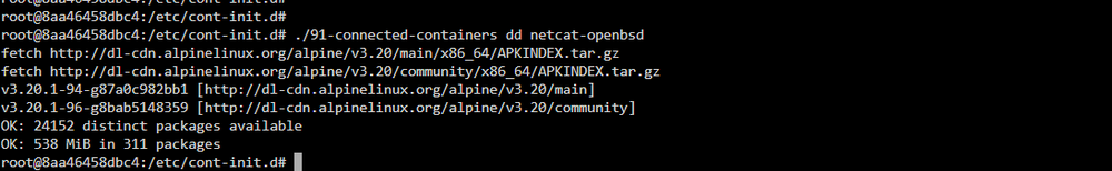

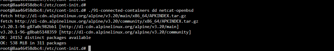

From the container I can manually run the script:
root@8aa46458dbc4:/etc/cont-init.d# ./91-connected-containers
fetch http://dl-cdn.alpinelinux.org/alpine/v3.20/main/x86_64/APKINDEX.tar.gz
fetch http://dl-cdn.alpinelinux.org/alpine/v3.20/community/x86_64/APKINDEX.tar.gz
v3.20.1-94-g87a0c982bb1 [http://dl-cdn.alpinelinux.org/alpine/v3.20/main]
v3.20.1-96-g8bab5148359 [http://dl-cdn.alpinelinux.org/alpine/v3.20/community]
OK: 24152 distinct packages available
OK: 538 MiB in 311 packages
No mention of starting connected containers.

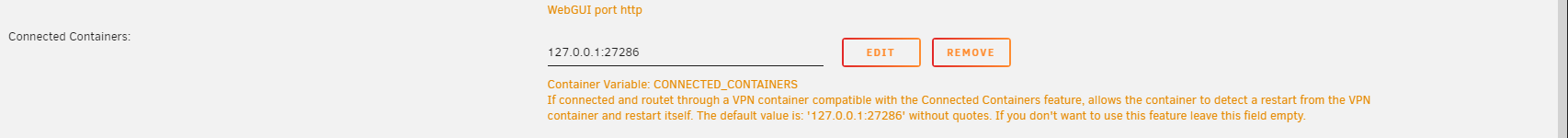

...and to add to the "I have no idea what is going on here", if I stop the OVPN container, the TVH container stops completely. If I restart the OVPN container, the TVH container stops completely.
Silly question...is this (from one of your containers):
Supposed to be added to the non-ich777 containers AS WELL AS the alpine script?
Nice, maybe that was the whole issue.
Because you are missing that line in your script, but that is nothing to worry about.
Good news, this means that it is actually working. The culprit to that is that in the extra parameters "--restart=unless-stopped" is missing, the connected containers function completely relies on that.
If you add that to the Extra Prameters (with advanced view enabled in the template) it will work.

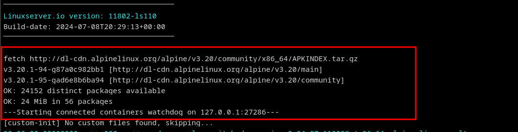

Nope because everything is defined in the script, please change the script to that for the alpine based containers and it should work more reliably:
#!/bin/sh
apk update
apk add netcat-openbsd
echo "---Starting connected containers watchdog on 127.0.0.1:27286---"
(nc 127.0.0.1 27286 && { echo "---Connection to connected container lost, restarting in 15 seconds...---"; sleep 15; kill -SIGTERM 1; } || echo "---Couldn't connect to connected containers---") &
(the changes add the missing line and also increase the restart time to 15 seconds <- this was done to be sure that the VPN container is started and connected)
I think the issue was that the script wasn't executable.

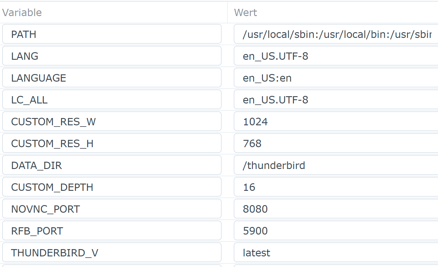

4 minutes ago, Xodarap said:
I got it working once and after a restart I get this.
So it is working once after installing the container, do you mean you restart your Synology Disk station or do you just restart the container?
5 minutes ago, Xodarap said:
The error still occures.
Can you please tell me what Docker version what is used on your Synology box?
What environment variables do you use or even better what docker run command do you use?
I did both several times.
Docker version is 20.10.3-1308, which seems to be the newest version.

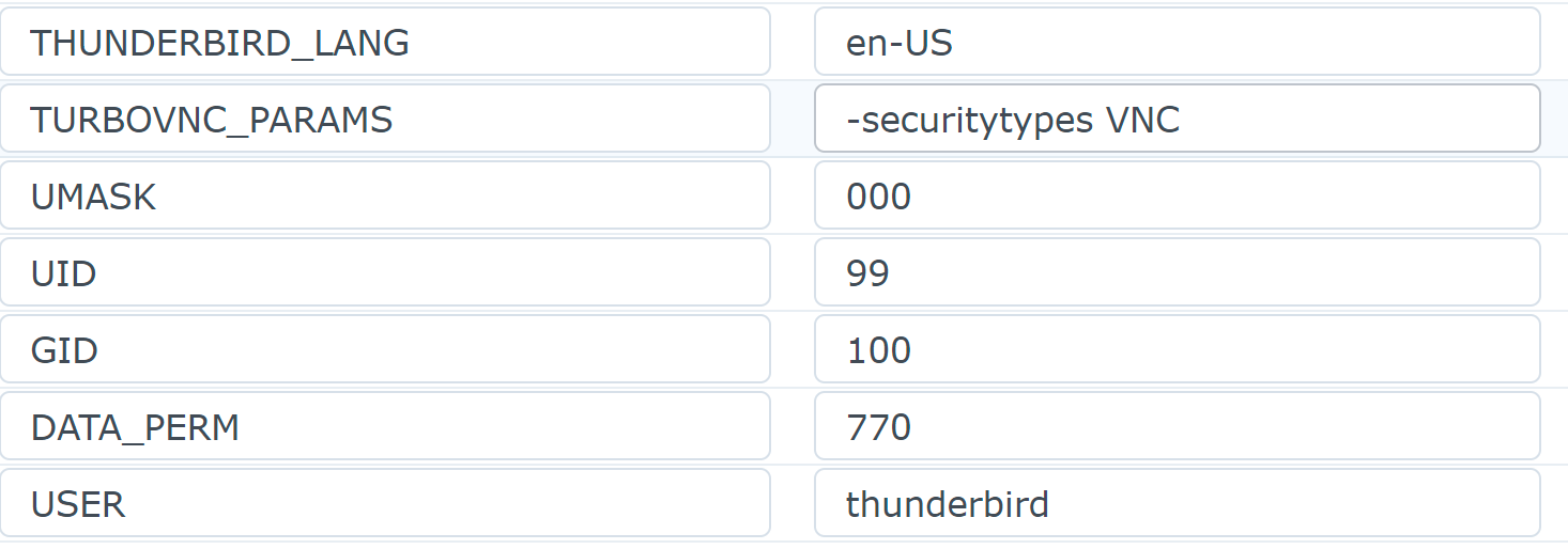

here my env variables:
Run command is /opt/scripts/start.sh
And you are sure that the UID 99 and GID 100 exist on your Synology?
I assume that's why it's crashing because my container tries to fix the permission on container startup and Thunderbird is also started as this user.
Make sure that the UID and GID matches a user that is actually able to write from and to the directories and of course exists on your Synology.

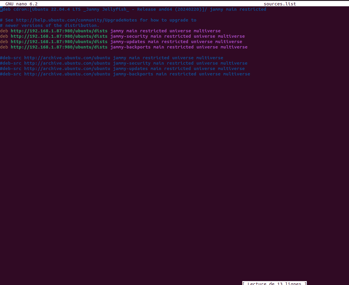

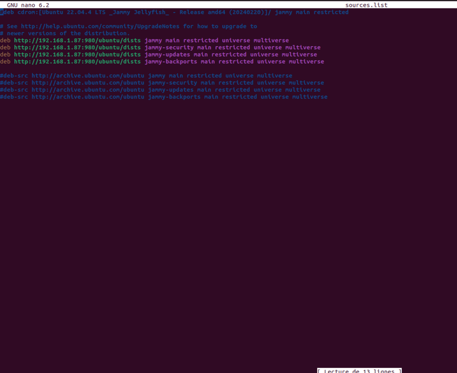

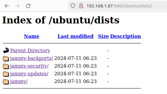

alexandre@alexandre-All-Series:/etc/apt$ sudo apt update
Ign :1 http://192.168.1.87:980/ubuntu/dists jammy InRelease
Ign :2 http://192.168.1.87:980/ubuntu/dists jammy-security InRelease
Ign :3 http://192.168.1.87:980/ubuntu/dists jammy-updates InRelease
Ign :4 http://192.168.1.87:980/ubuntu/dists jammy-backports InRelease
Err :5 http://192.168.1.87:980/ubuntu/dists jammy Release
404 Not Found [IP : 192.168.1.87 980]
Err:6 http://192.168.1.87:980/ubuntu/dists jammy-security Release
404 Not Found [IP: 192.168.1.87 980]
Err:7 http://192.168.1.87:980/ubuntu/dists jammy-updates Release
Err:8 http://192.168.1.87:980/ubuntu/dists jammy-backports Release
Reading package lists... Done
E: The repository http://192.168.1.87:980/ubuntu/dists jammy Release has no Release file.
N: Updates from such a repository cannot be performed securely, and are disabled by default.
N: See the apt-secure(8) man pages for repository creation and user configuration details.
E: The http://192.168.1.87:980/ubuntu/dists jammy-security Release repository does not have a Release file.
E: The http://192.168.1.87:980/ubuntu/dists jammy-updates Release repository does not have a Release file.
E: The repository http://192.168.1.87:980/ubuntu/dists jammy-backports Release has no Release file.

25 minutes ago, AlexON said:
Can you share with me how you configured your /etc/apt/service.list (Your Debian in your case...)so that I can repair my error (I don't see where it could be by the way).
Sure, just as described here:
In your case just remove "/dists", apt finds this path automatically, that's simply how apt works.

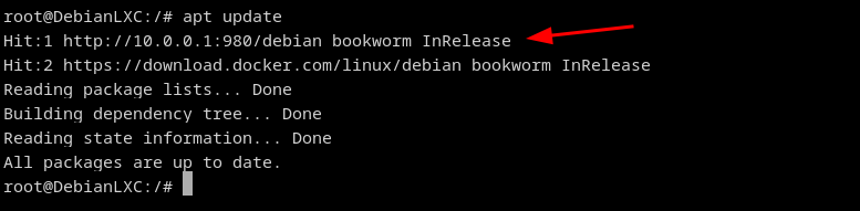

For Debian (which is almost the same) it looks like that:
...and after running "apt udpate" you will get something like that:

Ign :105 http://192.168.1.87:980/ubuntu jammy-security/restricted i386 Packages
Ign :108 http://192.168.1.87:980/ubuntu jammy-security/restricted DEP-11 64x64@2 Icons
Ign :113 http://192.168.1.87:980/ubuntu jammy-security/universe i386 Packages
Ign :118 http://192.168.1.87:980/ubuntu jammy-security/universe DEP-11 64x64@2 Icons
Ign :120 http://192.168.1.87:980/ubuntu jammy-security/multiverse i386 Packages
Ign :121 http://192.168.1.87:980/ubuntu jammy-security/multiverse DEP-11 64x64@2 Icons
Ign :122 http://192.168.1.87:980/ubuntu jammy-backports/main i386 Packages
Ign :123 http://192.168.1.87:980/ubuntu jammy-backports/main DEP-11 64x64@2 Icons
Ign :124 http://192.168.1.87:980/ubuntu jammy-backports/restricted DEP-11 64x64@2 Icons
Ign :125 http://192.168.1.87:980/ubuntu jammy-backports/universe i386 Packages
Ign :126 http://192.168.1.87:980/ubuntu jammy-backports/universe DEP-11 64x64@2 Icons
Ign :127 http://192.168.1.87:980/ubuntu jammy-backports/multiverse DEP-11 64x64@2 Icons
Ign :12 http://192.168.1.87:980/ubuntu jammy/main DEP-11 64x64@2 Icons
Ign :40 http://192.168.1.87:980/ubuntu jammy/restricted i386 Packages
Ign :45 http://192.168.1.87:980/ubuntu jammy/universe i386 Packages
Ign :47 http://192.168.1.87:980/ubuntu jammy/universe DEP-11 64x64@2 Icons
Ign :52 http://192.168.1.87:980/ubuntu jammy/multiverse i386 Packages
Ign :55 http://192.168.1.87:980/ubuntu jammy/multiverse DEP-11 64x64@2 Icons
Ign :5 http://192.168.1.87:980/ubuntu jammy/main i386 Packages
Ign :62 http://192.168.1.87:980/ubuntu jammy-updates/main i386 Packages
Ign :64 http://192.168.1.87:980/ubuntu jammy-updates/main DEP-11 64x64@2 Icons
Ign :71 http://192.168.1.87:980/ubuntu jammy-updates/restricted i386 Packages
Ign :73 http://192.168.1.87:980/ubuntu jammy-updates/restricted DEP-11 64x64@2 Icons
Ign :78 http://192.168.1.87:980/ubuntu jammy-updates/universe i386 Packages
Ign :83 http://192.168.1.87:980/ubuntu jammy-updates/universe DEP-11 64x64@2 Icons
Ign :87 http://192.168.1.87:980/ubuntu jammy-updates/multiverse i386 Packages
Ign :92 http://192.168.1.87:980/ubuntu jammy-updates/multiverse DEP-11 64x64@2 Icons
Ign :95 http://192.168.1.87:980/ubuntu jammy-security/main i386 Packages
Ign :100 http://192.168.1.87:980/ubuntu jammy-security/main DEP-11 64x64@2 Icons
Err :12 http://192.168.1.87:980/ubuntu jammy/main DEP-11 64x64@2 Icons
Err :64 http://192.168.1.87:980/ubuntu jammy-updates/main DEP-11 64x64@2 Icons
Err :100 http://192.168.1.87:980/ubuntu jammy-security/main DEP-11 64x64@2 Icons
Err :123 http://192.168.1.87:980/ubuntu jammy-backports/main DEP-11 64x64@2 Icons
654 kb received in 2s (332 kb/s)
E: Unable to retrieve http://192.168.1.87:980/ubuntu/dists/jammy/main/dep11/[email protected] 404 Not Found [IP: 192.168.1.87 980]
E: Unable to retrieve http://192.168.1.87:980/ubuntu/dists/jammy-updates/main/dep11/[email protected] 404 Not Found [IP: 192.168.1.87 980]
E: Unable to retrieve http://192.168.1.87:980/ubuntu/dists/jammy-security/main/dep11/[email protected] 404 Not Found [IP: 192.168.1.87 980]
E: Unable to recover http://192.168.1.87:980/ubuntu/dists/jammy-backports/main/dep11/[email protected] 404 Not Found [IP: 192.168.1.87 980]
E: Some index files failed to download, were skipped, or old ones were used instead.
Finally, things are finally moving forward but from what I can understand, he hasn't downloaded all the packages. Do you know how I can recover them? Because at the moment, I cannot do an apt-upgrade if necessary...
Edited by AlexON
I just checked this. When I use my standard user it says uid=1026 and GID=100.
I am not sure which user i should check the ids. Or do i define the user with entering the uid? In this case maybe the UID99 was wrong.
But somehow today everything is working again.
Just by using securitytypes=none instead of vnc.

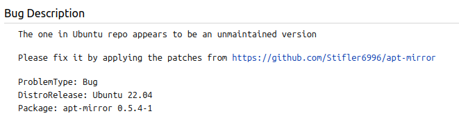

I think I understand that is a bug in apt-mirror witch dates back several years. The problem here and the solution here is that there is a script to issue via docker (probably) to correct this problem. If anything, what can we confirm?
https://github.com/apt-mirror/apt-mirror/issues/102
Sorry I adding a new links...
https://bugs.launchpad.net/ubuntu/+source/apt-mirror/+bug/2044556
and the fix https://github.com/Stifler6996/apt-mirror
EDIT : @ich777Yep.. If you continue the github conversation, someone offers their own apt-mirror docker with the fix integrated. I don't know if you would be interested in doing the same on yours just in case. This also affects Debian apparently. Afterwards, no wonder, it's the same source code.
Edited by AlexON
What problem, I really don't understand. What is missing?
My mirror is working perfectly fine, I even can install Debian from scratch with my mirror.
Please note that I use the Debian apt-mirror package which has to patches applied IIRC (yes, even for the Ubuntu container).
I declare that there is a bug not fixed for several years which affects the apt-mirror command when you want to create a mirror. Latest posts on github are from 2023 and also at https://bugs.launchpad.net/ubuntu/+source/apt-mirror/+bug/2044556. Afterwards, when I use a Debian LXC to do tests, I don't encounter any problems. But if you are using Debian/Ubuntu as your main system, you will definitely encounter this problem. I can always try via a Debian VM or whatever, but again, Debian/Ubuntu, it's the same thing chosen. In any case, I fixed (at least I think) the problem with the github that I gave you if you want to see and integrate it. I'm just waiting for docker to update (because I can't do it manually) and see if that permanently fixes the problem or not. To be continued
EDIT: I'm looking through a Debian VM (I have your 2 dockers) to see if I encounter the same problem. Logically yes, but in any case, I come back to you because I myself want to understand what is happening.
Edited by AlexON

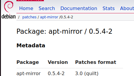

The apt-mirror that I use is from Debian itself not from GitHub and they apply these patches:
https://sources.debian.org/patches/apt-mirror/0.5.4-2/
I use my Debian Mirror on a daily basis and it is working fine for me, it downloads the packages on the schedule that I created in the container template.
28 minutes ago, ich777 said:
Can you please declare the bug more in detail?
When I create the mirror it immediately starts to download what I configured at full blast.
What I do is:
  1. Deploy the container
  2. Configure mirror.list how I need it
  3. Restart the container
After step three it starts to download the things that I've configured.
You always talk about a "problem" what is the exact problem?
What kind of tests? Do you install the mirror there or do you try to download packages?
You haven't even posted anything how you configured the container itself? What network do you use for your container, is host access on?
I use Debian Bookworm as my main system and also on my Notebook and I can pull updates as usual.
ahhh now I understand... Debian fixed the bug under apt-mirror and not Canonical Ubuntu. The version changed from 0.5.4-1 to 0.5.4.2. This explains why you don't see what I'm trying to explain.
This also confirms that there is an unfixed bug in your docker without you knowing it. And which is not your fault but the Ubuntu editor. You have the fix now, if you are interested in fixing this bug.
look by yourself.
image.png.ef362a7ea50609a5f5ad4a9ab9a981f5.pngimage.png.33974fce592371dd2d532ffbd7654b52.png
Edited by AlexON
14 minutes ago, AlexON said:
ahhh now I understand... Debian fixed the bug under apt-mirror and not Ubuntu. The version changed from 0.5.4-1 to 0.5.4.2. This explains why you don't see what I'm trying to explain.
I really don't understand... Here you say that the bug is fixed...
And here you say that the bug isn't fixed...
What?

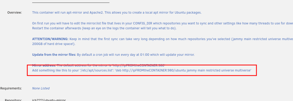

In case you think I use the package from Ubuntu for the Ubuntu-APT-Mirror you are wrong.
As I explained above, I use both for Ubuntu-APT-Mirror and Debian-APT-Mirror both the same package from Debian.
In other words both containers use:
http://deb.debian.org/debian bookworm/main amd64 apt-mirror all 0.5.4-2 [18.8 kB]
Ok, I understand that English is not my mother tongue but despite the sources I give you, you still don't understand. I seriously don't know what to do anymore by leading me to believe that you don't consult any sources... I don't see anything else. Seriously, I understand that you use apt-mirror from Debian to create your containers but for the version 22.02 of Ubuntu that you made, the bug is persistent and not corrected. I documented them and gave you the solution to fix it. Concerning myself, I think I managed to patch the problem on your docker but I must confirm it when it does its update at the time you gave it, i.e. 10 p.m. (home time) but as long as I don't I haven't checked, I'm not sure of anything.
Edited by AlexON
Just now, AlexON said:
Ok, I understand that English is not my mother tongue but despite the sources I give you, you still don't understand. I seriously don't know what to do anymore.
Have you read my post here:
I even tried the Ubuntu-APT-Mirror in that post and it is working fine, please look at the screenshots.
well yes, you are not reading what I am telling you and by the way, I am not from France. If this is how you deal with your problems Honestly, forget it!
@AlexON btw, the bug that you are talking about is it related to this one here.
I even posted a workaround in the linked GitHub issue.
EDIT: I now deprecated the Ubuntu-APT-Mirror since I have no use for as I did this container on request and it is really hard to test for me.
It is of course still functional if you want to use it and you can of course fork and customize it to your likings.
Maybe you can bring it back to Unraid in a working state. :)
