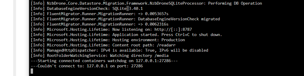

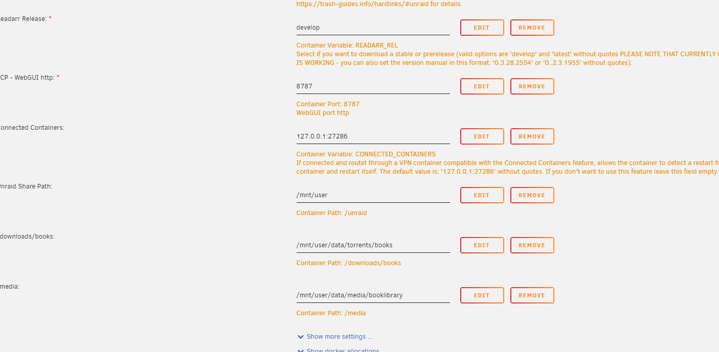

@ich777 -The good news, it seems like all the restarts are working. The bad news, "all" seems to be an overstatement.
I've got a pile of stuff working just fine. However, one of your containers (readarr) isn't restarting with the others.
image.thumb.png.4ab7db5d73725ce6f456e196a7f82643.pngWhat I've noticed (again, still nowhere near an expert on Docker stuff) is that this particular container, once it's dropped off can't even run ifconfig:
Oops. Windows habit:
Yes, because you usually don't need ifconfig or any network tools in such a container, that's why it's not installed and to safe space on users machines.
The logs are what real important <- since it will display everything there too and the above tools aren't needed anyways.
Does the Readarr container say that the Connected containers service is started? Does it also display a message that the connection is lost and the container does restart?
But just to confirm, everything else is working correct?

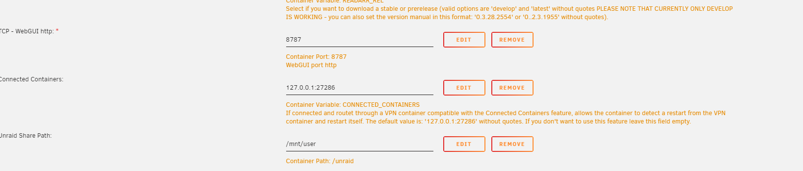

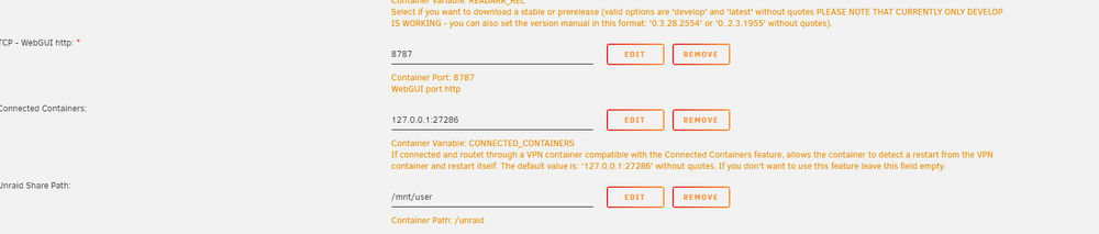

Everything else is working. Readarr is showing this:
image.thumb.png.a96b1ab20ec3ca2b6ac16137dca49c65.pngThe config in the container for that is identical to that in all the other containers:

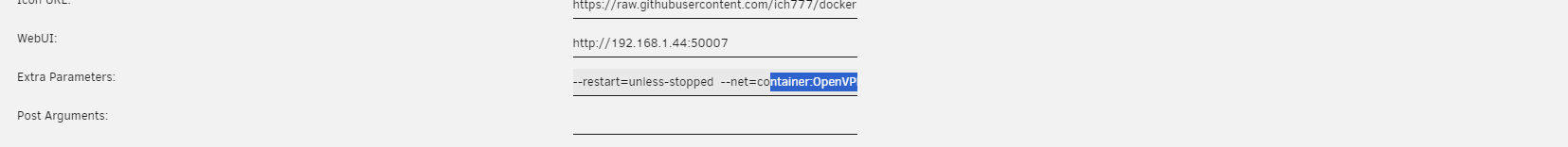

Sorry for the maybe dumb question but are you sure that it is using the OpenVPN network?
If yes, the only thing that I could recommend, since I see something with IPv6 mentioned in the logs is to disable IPv6 on your server entirely (of course if you don't need it).
Yup, thought of that:

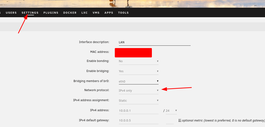

Please try to disable IPv6 on your server entirely in the network settings.
Maybe that will help. In the meantime I'll take a quick look in the source from my Readarr container if I made a mistake there.
I think the point is I don't know HOW to disable it entirely. The only way I can see to add or remove IPv6 is if I have an interface that is set for both.
Go to Settings -> Network Settings -> Network protocol -> IPv4 only:

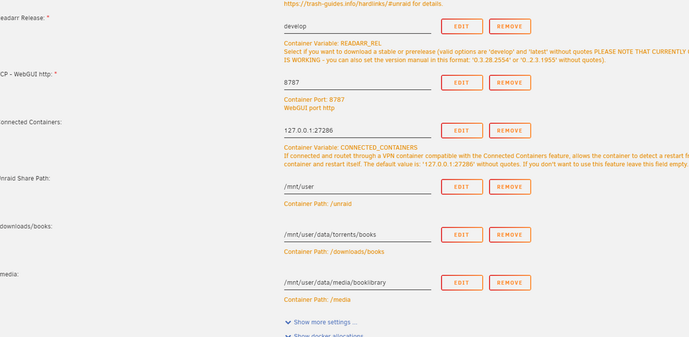

My bad in terms of Readarr, I was missing a dependency, now it should work fine, just force a container update.
Yeah, that's how I've always been set on my NICs.
Isn't there an advanced command switch in Docker that can be added to a container that says no ipv6?
Right now I've got them all disabled except OVPN. And OVPN upon start is giving me a veth interface.
Did you already update the container? It should now work.
I did, and the restart piece seems to be working since it's got an uptime of about 10 seconds, along with my other connected containers. Figuring out why the OVPN container seems to crap out so often would be nice, but isn't all that important as long as containers are rebooting correctly.
