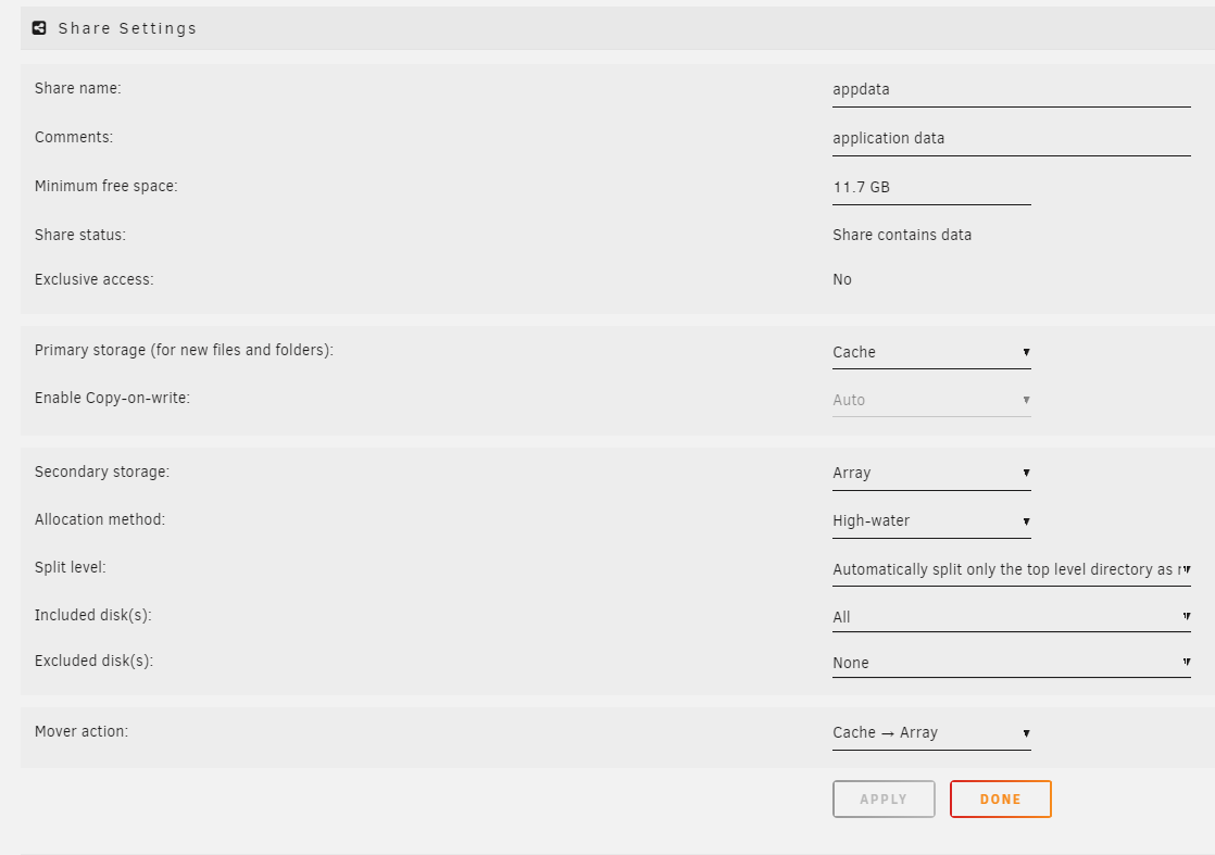

My TeamSpeak3 container seems to have reverted to default. There are no channels and and my TS Client no longer recognizes me as the owner.
Is there a way to recover my old state? I have my original privilege key but the client tells me that key is not valid.
Edited by Siege
if you have a backup ... yes.
may also show your docker run command, shouldnt happen as your appdata should be persistent
What path is set in the Docker template?
If /mnt/cache/appdata/... is set make sure that your appdata share is set to stay on the Cache and is not moved to the Array, so to speak as primary storage set the Cache and at Move you have to make sure that it takes no action or even better move the data from the Array to the Cache.
That's most likely what's causing your issue here.
yeah my mover action is moving from cache to array.
 I am still new to unraid. thanks for the help. I will try out changing my mover action to Array => Cache and let you know how it goes.

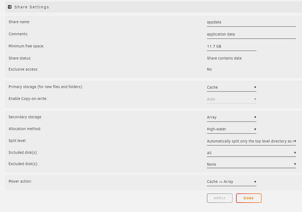

Prechange setting attached. I am kind of of new to this so If there are any changes I could make here to improve this set up please let me know.
@ich777 Well, after the mover did its thing. I was not able to get back to previous state. but it sounds like with the new settings I should not have a problem any more.
I ended up removing the docker and deleting the folder and reinstalling the docker to get a new admin key. It's not like my ts server was overly complicated so this wasn't really a big deal.
thanks again
In my opinion the appdata share alongside with system and domains share should always stay on the Cache and should be therefore configured to stay on the Cache since with this you reducing overhead by avoiding the FUSE filesystem (/mnt/user/...) and with that also be sure that your applications have fast and quick access to the files in your appata.
This is maybe because it can't move all the data properly back and maybe mixed up some of the old and new data.
Anyways, glad to hear that you are now up and running again! :)
