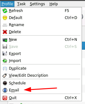

4 minutes ago, justintas said:
Is there a way to have an email when it runs each time ?
Sure:
And do something like described here:

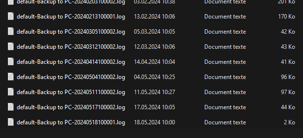

FWIW I only rarely get logs saved in the destination, even if it runs just fine every day

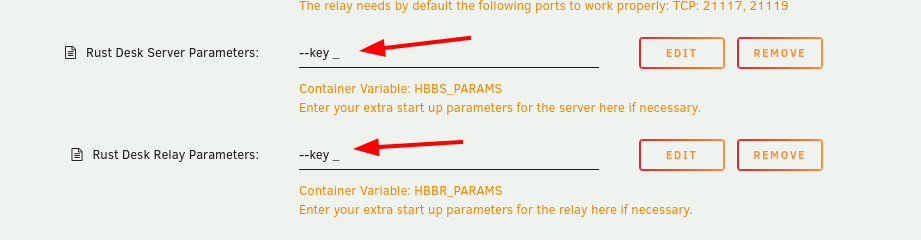

anyone know whats wrong with rustdesk? Was working fine for a long time now, but now it says "schlüssel stimmen nicht überein" "keys dont match" - what keys? Internet said, update client, which we did, nothing changed...?
edit:
we found the problem, we had to enter the public key (found under logs when server starts) into every client under security "Key:"
Was never needed... i dont know.
Edited by unread
That should be always be needed if you start the container with that parameters (should be the default) :
I would not recommend running it without the public key since otherwise anyone can user and connect to your machines (of course ID and Passwords are needed).
