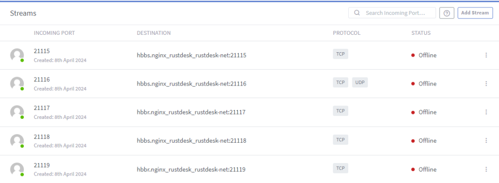

I use the Rustdesk AIO container by ich777. It works good in my home network.
I want to use it remotely but dont' know how to config NGINX proxy manager.
I tried Step 5 here https://gist.github.com/Lvdwardt/707d9c3fb4581d38102399f91a21c9c6 but I don't understand what to write in the "yout_stack_name".
my domain is rustdesk.mydomain.com what should I place in the streams as the "Forward Host"?

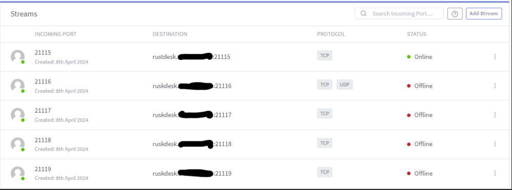

I tried the below but although the 1st one shows Online the remote connection doesn't work.
The blacked out part is "mydomain".

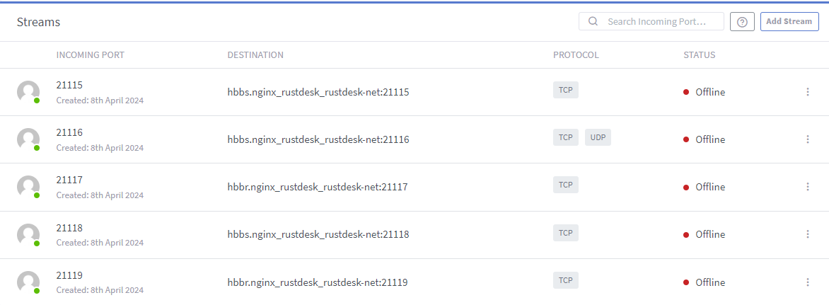

and also this
But still not working.

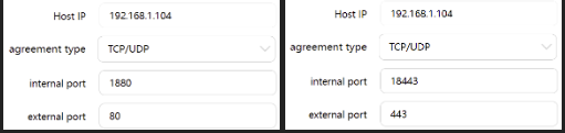

I have port forwarding defined on my router 80 --> 1880 (NGINX port), 443 --> 18443 (NGINX port)
What am I don't wrong or missing?
You don't use NPM, that's only for web/http(s) which rustdesk toesn't have, you forward the ports directly from your router to the container.
As @Kilrah already pointed out, don't use NPM.
NPM is only for http/https traffic, sure if you are using streaming ports it will work but what is the benefit because you would have to also open up ports and a streaming port in NPM is basically the same as if you directly point to the container IP address.
My recommendation is: simply forward the ports in your Firewall from the RustDesk container and that's it. After that you can connect with your domain name to your RustDesk Sever.
What you are doing in NPM can't work because you are streaming the ports which would also involve opening the ports but I would not recommend doing that because you are overcomplicating your set up for no reason.
