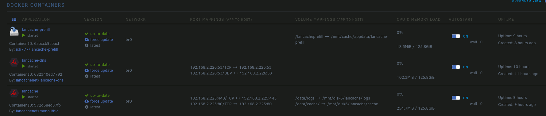

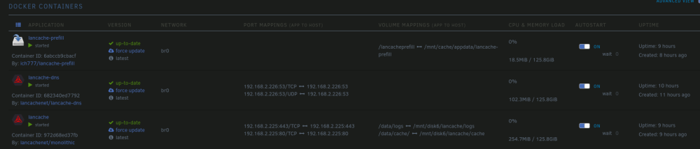

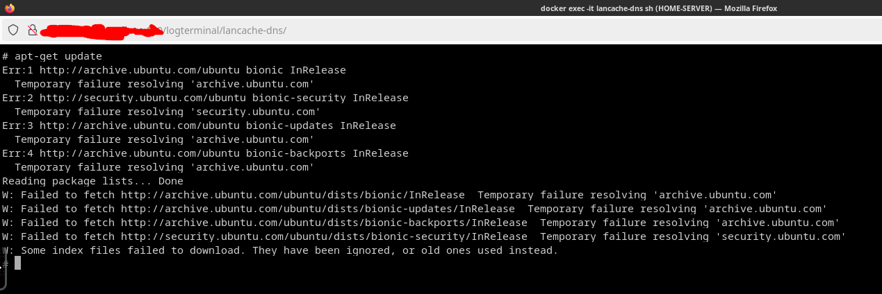

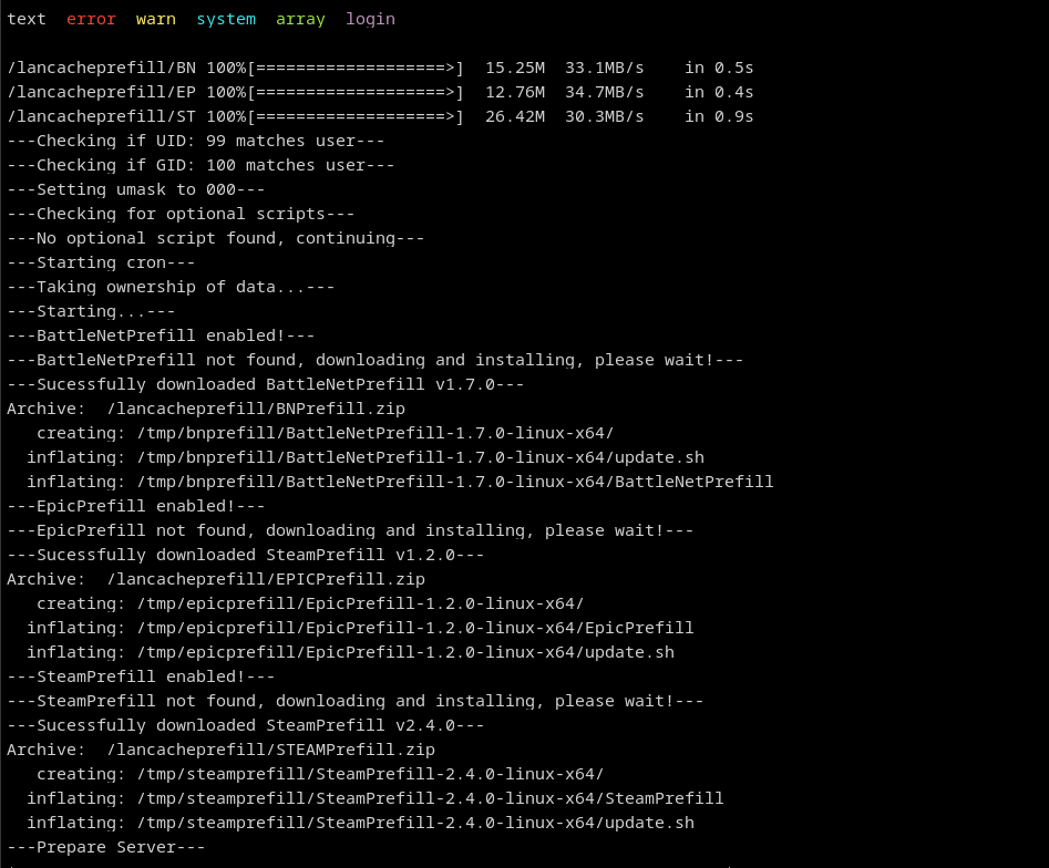

Hello,
I'm having issues with container lancache-prefill. It doesn't start properly and goes to sleep mode.
Here's the container log:
---Checking if UID: 99 matches user---
usermod: no changes
---Checking if GID: 100 matches user---
usermod: no changes
---Setting umask to 000---
---Starting cron---
---Taking ownership of data...---
---Starting...---
---SteamPrefill enabled!---
---SteamPrefill not found, downloading and installing, please wait!---
-----Something went wrong while getting the latest version!-----
---Please try again later, putting container into sleep mode!---
Anybody experienced the same and knows how to solve it?
Thank you!
Do you have any Unifi network gear on your Network or AdBlocking?
The version is pulled from the GitHub API and if that is blocked then it can't pull the version numbers.
I've tried a new container and it is working just fine:
I do have an Unifi Network Application (in docker on the same Unraid) and one AP on my network. I also have pfBlockerNG on my pfsense. I have tried to spin this container on another server in another network, also behind similarly configured pfsense and it worked just fine.
I have noticed in Unraid that this container doesn't get the IP address.

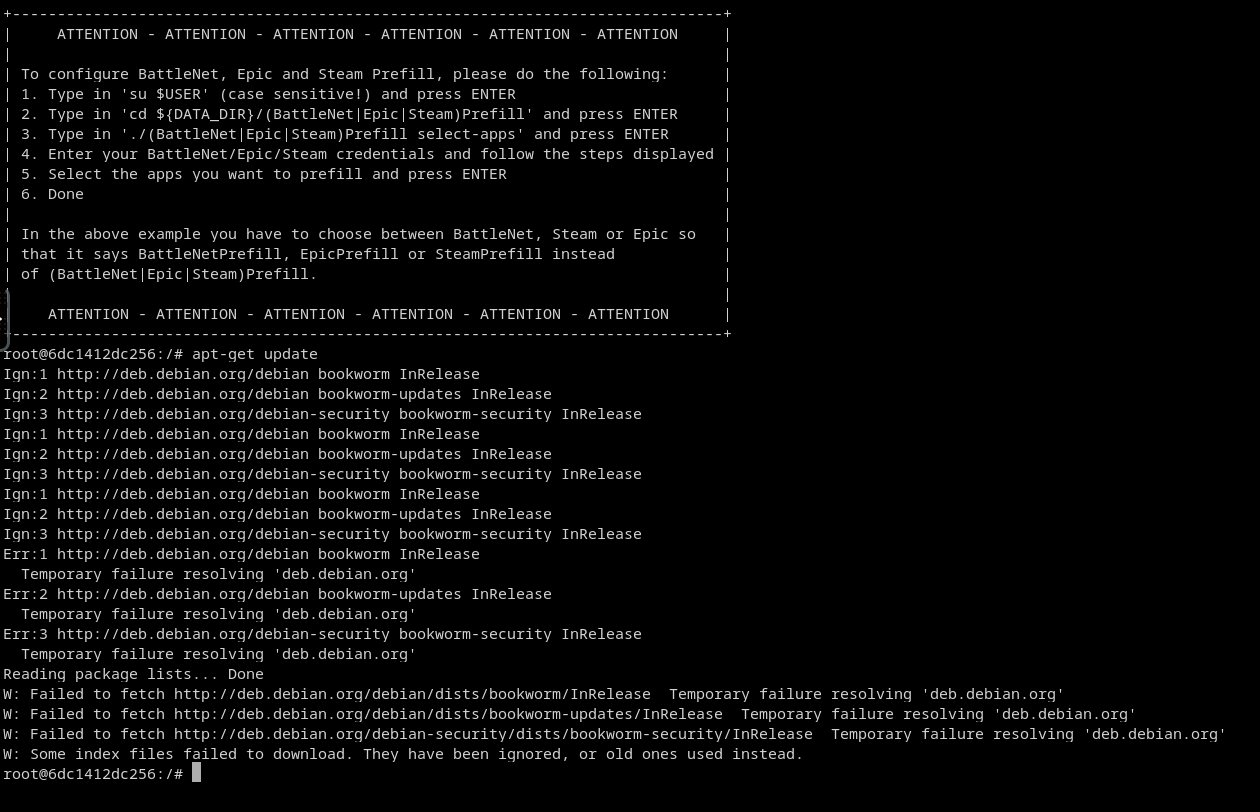

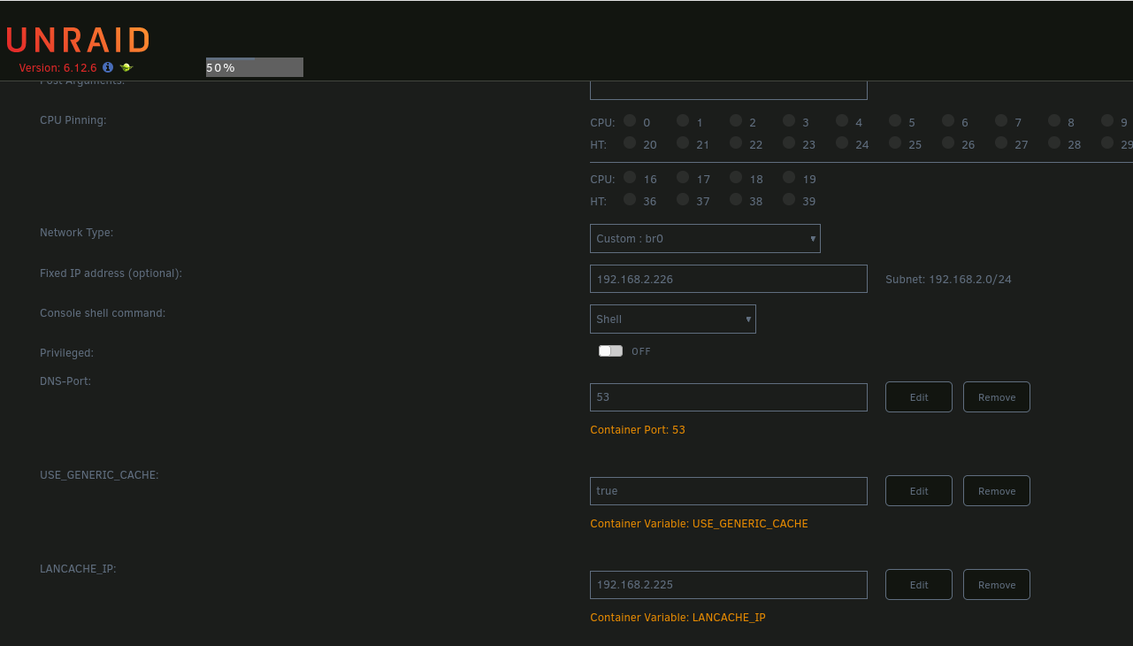

That's not true, if you use br0 then Unraid will only list exposed ports on the Docker page which I don't do for this container because you don't need any exposed ports.
If the container would have no network then it wouldn't be able to download the applications on start. You've said that it works on another network? I assume something is blocking the GitHub API since it seems to not being even able to pull the versions.
I think the problem is not the container lancache-prefill. It seems to be something with DNS server (lancache-dns).
Configuration of lancache-dns:
lancache-dns cannot reach the internet too:
I apologize for wasting your time. I found some old rule in my firewall, blocking traffic to internet from certain IPs. Including those used for lancache. Disabling the rule fixed the problem.
I appreciate your support. I wouldn't figure it out if you haven't pointed me in the right direction.
I'm using quite a few of your containers and they are great. Keep up good work!

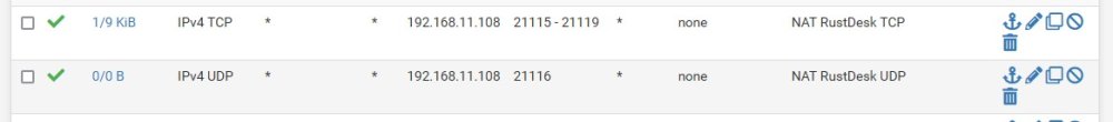

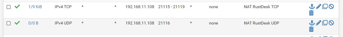

Thanks to @ich777's kind help, I've made good progress in setting up the rustdesk container, but I'm not quite there yet...
At this point, I have the container installed and running, and all ports are forwarded in my pfsense device and confirmed open.
I've installed rustdesk clients on my desktop PC and phone, as starting points for testing.  If I keep everything on my local LAN (input my local server IP as the ID and relay servers in rustdesk), I can connect no problem, and control my desktop from my phone.
However, that's no use to me, as I need to be able to access all my devices remotely.
I've set up duckdns through my pfsense box, and confirmed that it's working, since I can access by BlueIris server from outside using my domain name.  Let's call it <myhomeserver.duckdns.org> for this example.
Here's where I get lost...
If I put <myhomeserver.duckdns.org> in the rustdesk network fields, it seems to want to work on my phone, but my desktop just says "Not ready. Please check your connection".
I'm not sure what to do from here.  The rustdesk docs don't really say much about this type of config, or at least I haven't found it.  They say to "Enter the hbbs host or IP Address in the ID Server input box (local side + remote side).", but not how to determine what those should be, or what's meant by that "local side + remote side" thing.
I'm afraid I'll need a bit more hand-holding, sorry! :)
Have you yet tried your public IP for testing purposes (even if it is changing from time to time)?
If you even can't reach your server with your IP then it has something to do with the connection itself, please double check your port forwarding and if the protocol is set correctly for each port.
In my OPNsense NAT it looks like that:
I've tried my IP directly, and I get the same result.  My phone tries to connect, but immediately says "connection error - remote desktop is offline".  I take this to mean that it has connected to the relay server, but there's no one on the other end, because if I have it configured differently, then it just spins for a while and gives a different message, something like "connection timeout".
My pfsense rule looks pretty much like yours...1227794676_rustdeskNAT.thumb.jpg.08592e929e18d03153b0a8f7312d412e.jpg
EDIT:  I'll add that I'm confused about what server info should be put into the desktop client for rustdesk.  It doesn't seem right for it to be the external IP (or FQDN if using ddns), since that would be sending the traffic outside the LAN, then back in, but maybe that's exactly what happens?
Edited by Elmojo
