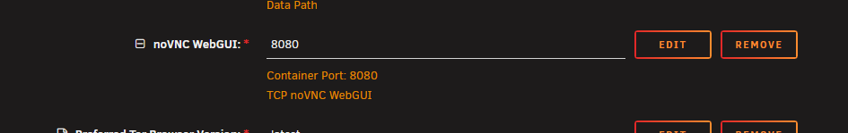

Please update the container itself and add a variable to the template:
Key: NOVNC_TITLE
Value: Your .-_ Title
(Only alphanumeric, numeric, spaces and . - _ are allowed)
Looks like that:
