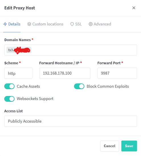

Hey i just installed your TS3 App...
and have some questions.. i just created a Cname ts3.host.com and in NGNIX Proxy relinked it like it shoud  (maybe like it Should :D ) it doest work.
Which port ist the right to forward to in NGINX and what do i have to put in ts3 ?
Havent got it to work..
Networktype is Bridge
And in Teamspeak3 i just put the ts3.host.com for Serverip ?
also tried ts3.host.com:9987
could this be the Problem?
Edited by eLpresidente
The main question is why?
You usually create to a TS3 server via your hostname and port like host.com PORT
You have to forward all ports since one is the query port, then there is one for the voice channel and one for data transfer.
As said above you have to forward all ports because this is not a web server that proxies http/https traffic...
Sure you could use streaming ports but the benefit from this is non existent and you are overcomplicating your setup.
It is fine to forward the ports in your Firewall like it is for a game server (game servers are also not using http/https).
You can read a bit more here where I write and rant about it a bit more :D (it's another application but it applies here too) :

oh i see, that was my mistake, i don't know why i wantet it to proxy via NGINX <--
Just Openend the Ports in my Fritz.Box and created a CNAME without Proxy in cloudflare. now it works.
Thanks for your help.
Usually such containers are safe to expose to the Internet and forward the ports directly and as said above, there is not much benefit to route it through a reverse proxy (which is in general possible) since you are overcomplicating and maybe also introducing other weird behaviour or other issues.
