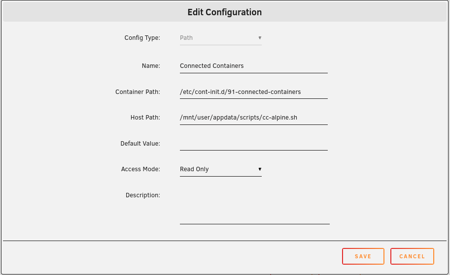

Hey @ich777 questions for you continuing from a few pages back (and again, thanks for all your work on this)
I did a rebuild on my *arr setup.
Contains
ich777/openvpn-client
ich777/lidarr
ich777/sonarr
ich777/radarr
lscr.io/linuxserver/qbittorrent
lscr.io/linuxserver/prowlarr
All these guys are routing through the OVPN client. All your dockers are set to use the connected containers setup. The problems I'm still having probably come down to...
The qbittorrent and prowlarr aren't yours so the connected containers setup isn't part of their build. Have you got a workaround for  that? Or intend to release your own versions of qb and prowlarr?
The only solution I've found is to reboot them. And since they're both single points of failure in all this, well, having them go and not get bounced automatically kind of kills the value on the rest of the containers auto-restarting.
What do yo think?
These are both alpine based and you can of course mount this script into the containers (put it somewhere on your server) and mount it in both containers like:
(in this example the script is located at /mnt/user/appdata/scripts/cc-alpine.sh on Unraid itself <- of course you can put it somewhere else)
With that the containers should also auto restart, you wont see the message when starting the containers like in mine but it should work too.
This method should work with all alpine based container from Linuxserver, I think I also have a script somewhere for Debian/Ubuntu based containers.

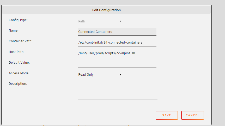

OK, done. I've got it set like this:
The part where you seem to have a path in the container path but a file in the host path doesn't make sense to me, but I'm going to go out on a limb and assume that you know when you're doing since I certainly don't.
No no, Docker actually recognizes that this is a file on the host and creates a file inside the container and just because the file inside the container has no file extension doesn't mean that it is not a file. ;)
Docker will only create a directory if it doesn't exist on the host.
I did notice it created the folder when I forgot to put the .sh the first time I did the path.
Yes, but that's only if you don't point to a file on the host, however is it now working?
