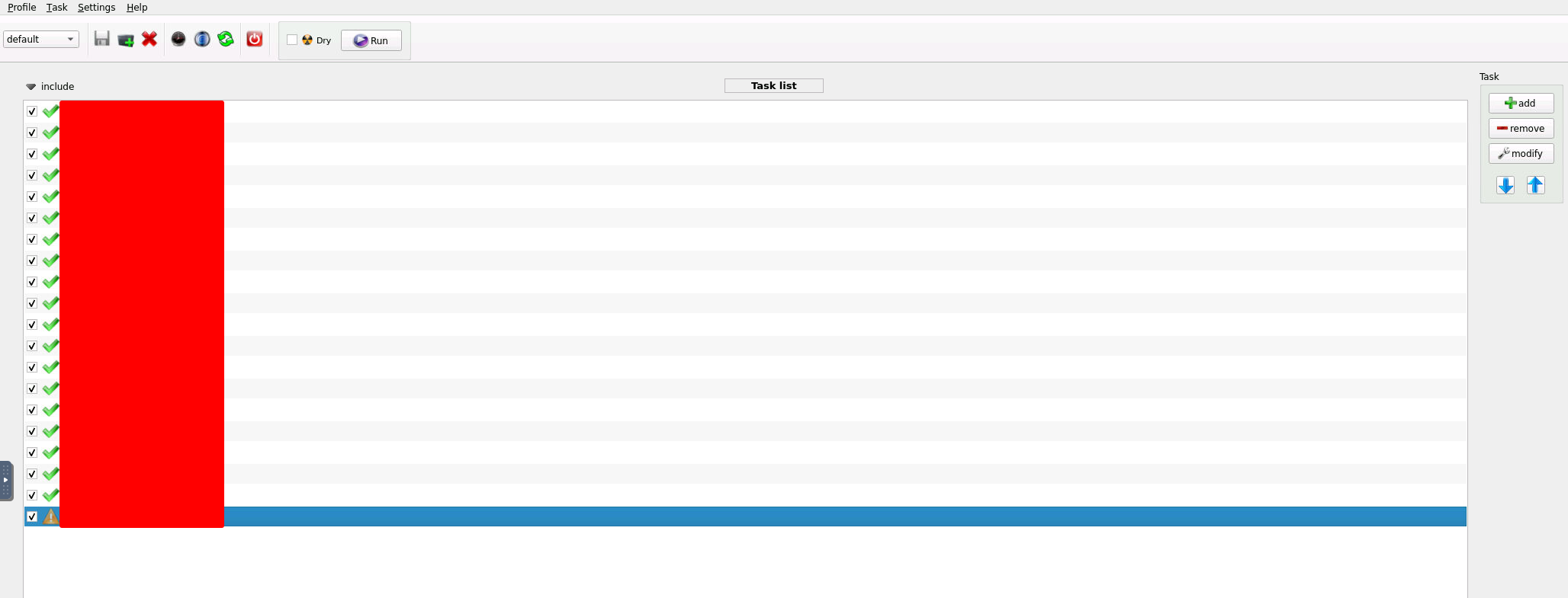

Using Luckybackup very good Docker but the scheduling is confusing me. All works perfectly manually but will not run as a cron job as per schedule. I'm sure I've missed something simple so any help appreciated.
Below is container setup, backup setup, crontab and schedule.
Where have I gone wrong ???

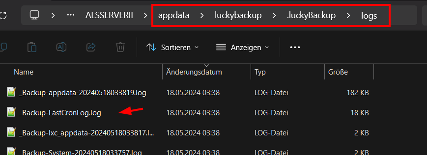

are you sure ? the UI wont update the last runs ... therefore you need to restart lucky ;)
may 1st take a look at your logs ... or restart lucky to check.
log to check is here

how is your default profile looking ?
here is my default profile plus command, can't see anything wrong with it ?

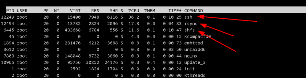

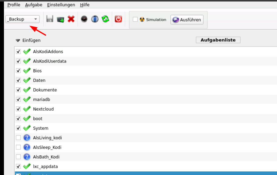

@justintas a backup over here was just triggered via CRON and is working as it should.
As you can see here there is nothing running in the GUI while the job is running:

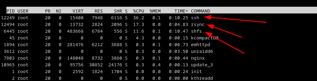

But as you can see from the output from top it is indeed running:
