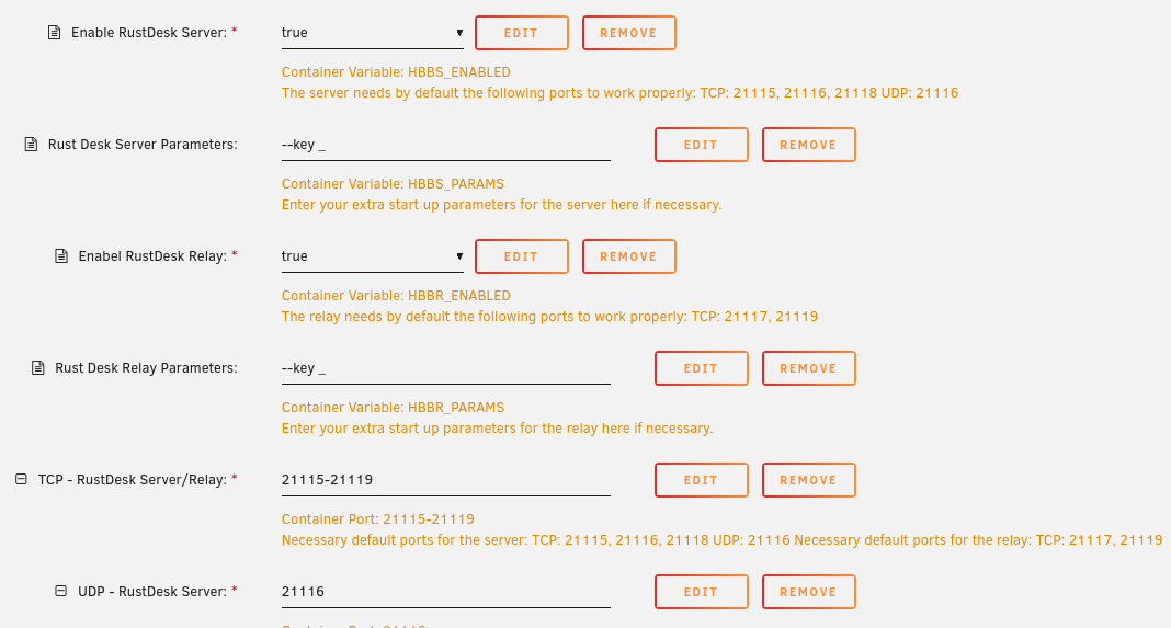

42 minutes ago, odje said:
For Rustdesk, does the -r rustdesk.example.com:21117 parameter need to be added "Rust Desk Server Parameters"?
Are you using Unraid? If yes, just use the template as is and it will work, you don't need to pass through any other variables, everything is preconfigured and nothing needed.
The default configuration will work OOB:
("--key _" ensures that your server requires clients to use the key which is generated on first start)
Please also keep in mind my container is not the one that you've linked since my container contains both the Server and Relay.

I'm so confused with my setup i just added it and not sure how to get anything else. it keeps crashing
does rustdesk has a webgui in this version? Maybe this is what is confusing me
Me too.... What keeps crashing? Did you change anything in the template?
A bit more information would be really helpful.
No, this is not the commercial version this is the version for private use.
What does the log say?
I sort of figured it out i kept looking for a a web gui in the docker. And for logs well i wiped the whole docker and started from scratch and it worked this time.
Also installed the client and manually added the host settings and key. It that how is supposed to work all the time?
I would recommend that you read the documentation, especially this section.
For Windows you can make a executable like linked above, but yes, that's how it's supposed to be done, you can also start the server without a key so to speak to let anyone connect to the server but that's up to you.
the first time that started without the key it didn't work at all, that was my mistake. But well I'm fine with manually adding devices with key :)
Question, after the key gets generated i assume i should edit the docker and add it in there in case i have to redo the docker or something happens, right?
No, the key is stored in your appdata directory and you don't need to add it, the parameter "--key _" will ensure the key from your appdata directory is used.
Nice nice :)
