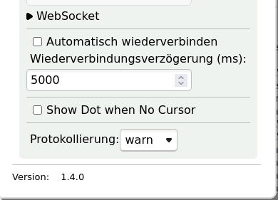

What browser are you using? Is it possible that you are using a Chrome based browser? Chrome is notorious for closing tabs or at least put them to sleep and that's what might cause this.

On 1/17/2024 at 3:59 AM, ich777 said:
By default it shouldn't disconnect you at all.
Vivaldi which is Chromium like 98% of things.
There is not settings putting it to sleep etc. Would say it kicks me back to the noVNC connect button in a few minutes.
This is even when the tab is active and you don't interact with it.
10 hours ago, mavaros82 said:
I want make backup everyday after reboot then i select @ reboot delay 5 minutes as well
Since this is a Docker container reboot won't work, you can only set up a schedule with a time.
I don't have this issue on Firefox at all, are you sure that you are using my container?
1000% your container.
I also found the problem, WebSocket.
After a few minutes of inactivity (i.e. not clicking on anything) the WebSocket is closed.
I have no such settings in NGINX for this but I found a workaround.
In the noVNC setting is WebSocket automatic reconnect
The default is no tick and 5000.
Once I set that and watched it time out it counted to 5 seconds and then connected.
Guess you could set it to 1 if you really wanted.
Can't confirm this over here, mine looks like that:
As said, on Firefox I can leave the tab in the foreground, background whatever without moving the cursor or interacting with the window at all and it won't disconnect.
My suspicion is still Vivaldi or some energy saving feature that they might have built into their browser.
