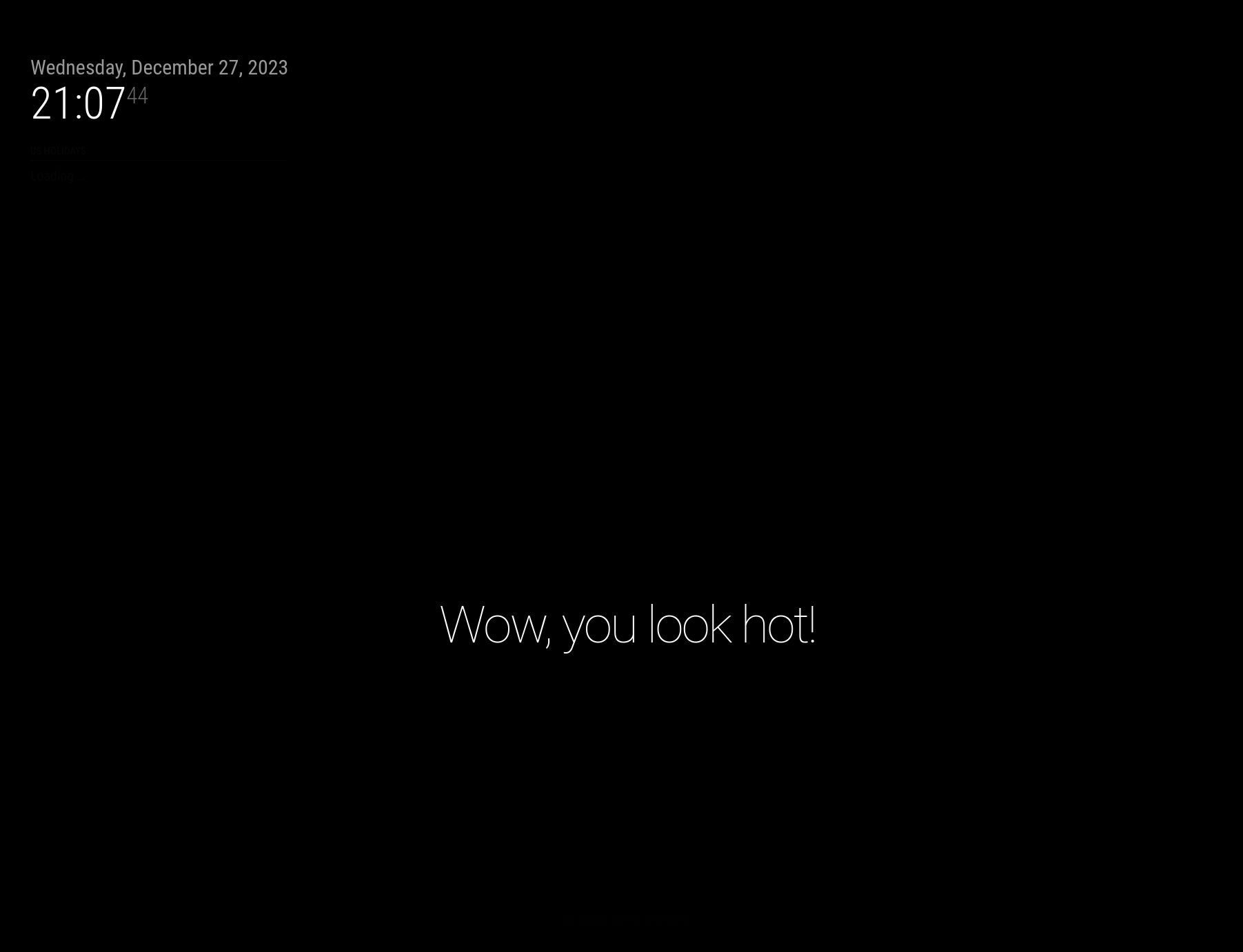

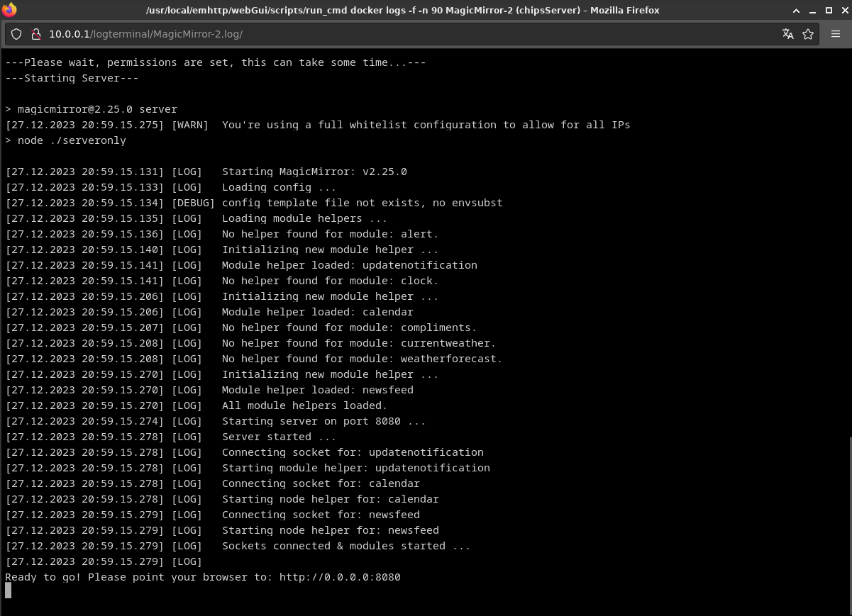

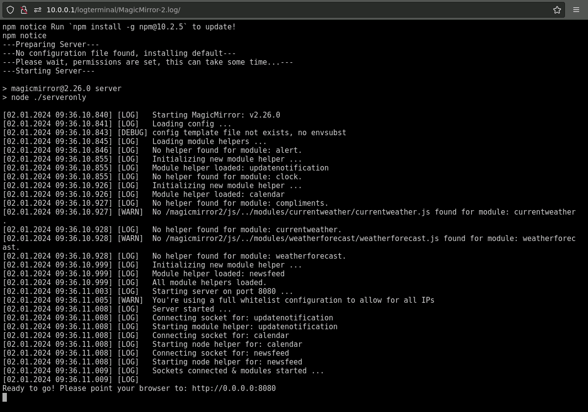

I've been trying to get the Magic Mirror 2 docker running and have yet to get the web interface working. Unraid 6.12.6, MM2 2.25.0, node.js 18.17.1. Running in bridge mode. I've forced updates, added the DATA_PERM 770, and the logs show it in a boot loop. Please help me troubleshoot this. Log snippet attached.
The live log cuts out with each loop, so it's hard to get a full collection of logs - are the logs stored somewhere in ./appdata/macgicmirror2/?
MM Loop.txt
Can you please give me a bit more details, is this a existing installation that you try to upgrade? Have you yet installed any modules?
However it seems that something is wrong with your modules, what path's have you set in the template and so on?
You can extract the logs from a Unraid terminal if you do something like that:
docker container logs MagicMirror-2 > /mnt/user/appdata/magicmirror2.log
This will write the log to /mnt/user/appdata/magicmirror2.log you maybe have to set the container name which is in the above command MagicMirror-2
I tried it now on a fresh set up version and it seems to work fine:

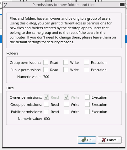

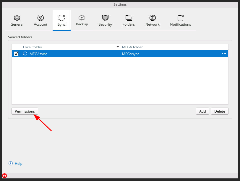

Hello!, I am using the ich777/megasync container in unraid, it works well except that everytime I download something, I need to run the "New Permissions" tool before I can access the files over my regular SMB shares.
UID GID & Mask are set to 99, 100 & 000, the same as other containers that do not have this problem.
Any help appreciated but since this is the only Mega container on the unraid appstore, I will continue to live if this can't be fixed.
-rw-rw-rw- 1 nobody users  737351153 Dec 31 06:05 "File After Running New Permissions.mp4"
-rw------- 1 nobody users  737351153 Dec 31 06:05 "File BEFORE Running New Permissions.mp4"
I assume it is setting permissions for the Root account only, based on the above.
Thank you :)

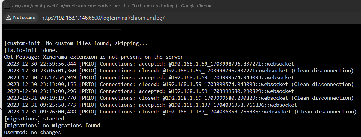

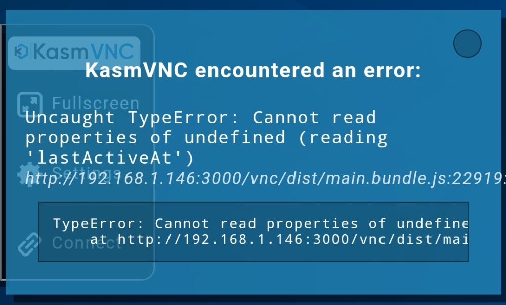

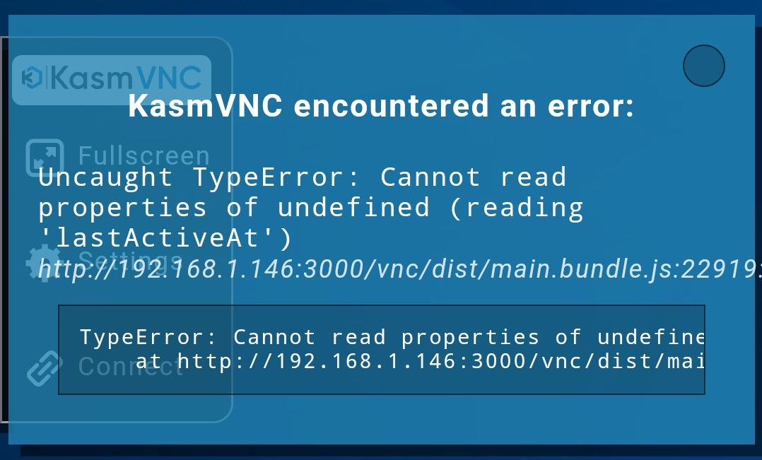

Having issues with OpenVPN. It has worked flawlessly until this evening. Chromium has stopped working properly.  I'm now getting this  error. If I run the browser outside of OpenVPN it works fine
[custom-init] No custom files found, skipping...
[ls.io-init] done.
Obt-Message: Xinerama extension is not present on the server
 2023-12-30 19:07:02,212 [INFO] websocket 0: got client connection from 127.0.0.1
 2023-12-30 19:07:02,217 [PRIO] Connections: accepted: @192.168.1.137_1703984822.212248::websocket
 2023-12-30 19:08:46,400 [PRIO] Connections: closed: @192.168.1.137_1703984822.212248::websocket (Clean disconnection)
Nothing changed in terms of OpenVPN, the last update that I pushed to it was about two months ago and if it was working in that timeframe then something else must have been changed.
Are you sure that Chromium isn't the culprit? The log that you've attached it not from my container.

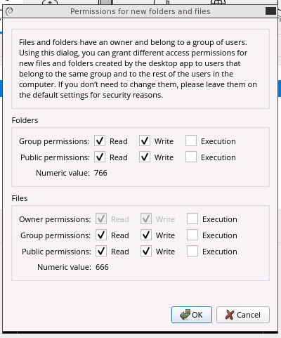

Have you seen this button in the Settings:
With that you can change the default permissions from:
To:
However this applies only to new files and that you upload to Mega with the client.
The main problem is if you upload the files as root and have these permissions from above the client won't change them so you have to ensure that the permissions are correct when uploading.
Thank you so much, I don't upload, I just use it for downloading linux isos
Here is a snapshot of the log fileimage.thumb.png.2a6e29f187ed1d1087f0be9843828ab8.png
But that is not my container. I really can't help here since you have to ask in the support thread for the chormium container that you are using.
Maybe you have to forward another port, I'm not that familiar with KasmVNC.
As already said, nothing changed in the last two months for the OpenVPN container.
Thank you for the reply. I've installed the MM2 docker image from the unraid APPS tab. In attempting to get it to work, I ran the update commands (didn't work prior or after for me).  I did try adding some modules. My docker setup is in a screenshot below.
The terminal command you proposed returned error that look like they're in the calendar module (error: Cannot find module 'fetch') see MM2 Log Output.txt attached. I commented out all my modules and reran the command and got a shell error with the same terminal command:
"Session terminated, killing shell.../opt/scripts/start.sh: line 29: kill: `': not a pid or valid job spec"
I might wipe all the docker data and start fresh unless you have something else I might try...
Sorry my bad. too many things going at one time, thanks
That is maybe the best idea, I had to update the container since there was a slight change to the GitHub API where (which the container is utilizing) it wasn't able to grab the latest version number but that is now fixed.
However I've tried to install it again and it is working fine, please keep in mind the first start might take a bit longer than usual since it installs dependencies:
