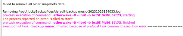

I have an old Unraid server as my backup catcher, this machine sits turned off all of the time.  From the Unraid console I can issue the command etherwake -D bc:5f:f4:86:57:73 and wake the system up.  But, when I add the same command or etherwake -D -i br0 -b bc:5f:f4:86:57:73 from within the LuckyBackup Also Execute Before command it fails because it cannot find etherwake, same from the LuckyBackup console.
I assume this is due to the fact that LB is running in a container that does not have etherwake installed and the container is not able to run commands on the OS directly.  How do I get around this?
39 minutes ago, dataslayer said:
I’m up to date - 6.12.4
This is really strange, have you yet tried to completely remove the container and then reinstall it from the CA App, it seems like your Docker layers for this container became corrupt.

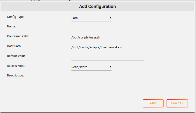

You can write a script on the host that you can name however you want, lets name it "lb-etherwake.sh" with the following contents:
#!/bin/bash
apt-get update
apt-get -y install etherwake
...after that go to the template, click on "Add another Path, Port, Variable, Label or Device", as config type left it at Path, the container path must be: /opt/scripts/user.sh and on the host you have to go to the path where the script is located and you then have to manually append "lb-etherwake.sh" to the path, this will mount the script in the container.
It should look something like that:
Click on "Add" and then on "Apply", by doing all of that the script should pull etherwake on container start and it should be available in the container after you did all of that.
Please keep in mind that you maybe also have to change the network type from the container to Host since otherwise etherwake will most certainly not work (I have never tried that but if you set the network type to host in the template it should work because if you leave it on bridge your WOL package will be only be sent into the Docker subnet and never reach anything outside that network).
Trying to make sense of this section...  so is the script that I create located within the container or do I create it in the console of the main server in the cache directory?

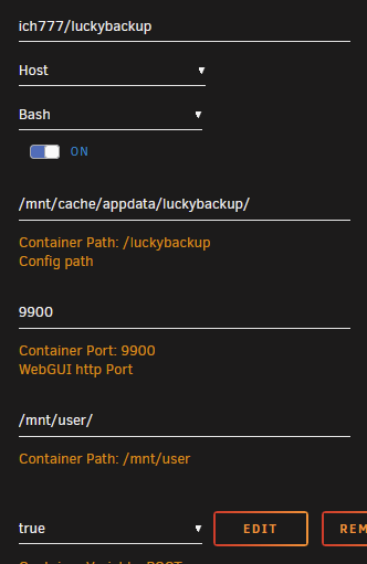

So, in the process of trying to convert the container to host based, I have found what I think is a problem...
Here are my settings:
Have also tried the default of Privileged: off.
When I try to browse to the webgui, LB tries to take me to this address:
Notice the URL, wrong port.  Log indicates the wrong port as well and I cannot get it to change.
when running in host mode, your port mappings are obsolete as you run in host mode ;)
if you want to change the Port, may search this thread for howto ... been posted 1 - 2 pages back (again)
also, mapping in bridge 9900 <> 9900 wont work without changing the nativ app port ... consider this like a router port forwarding (when in bridge), but just changing the forwarding wont change the nativ listening port ... thats why you fail when you change back to bridge with this setting, port 9900 is just not listening ... there are 2 Variables you can add to change the nativ ports ... but then also you need to match your mappings ...

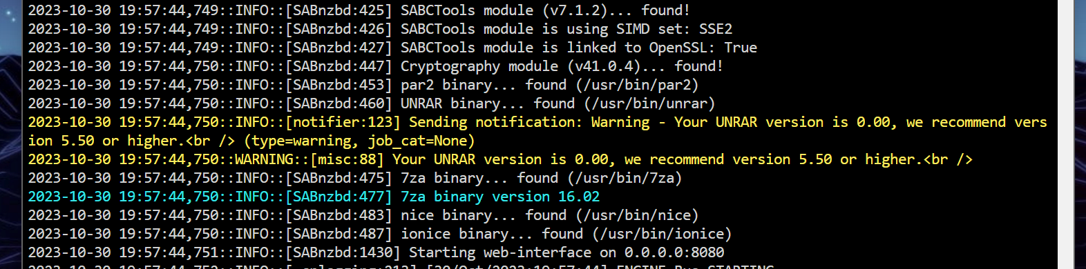

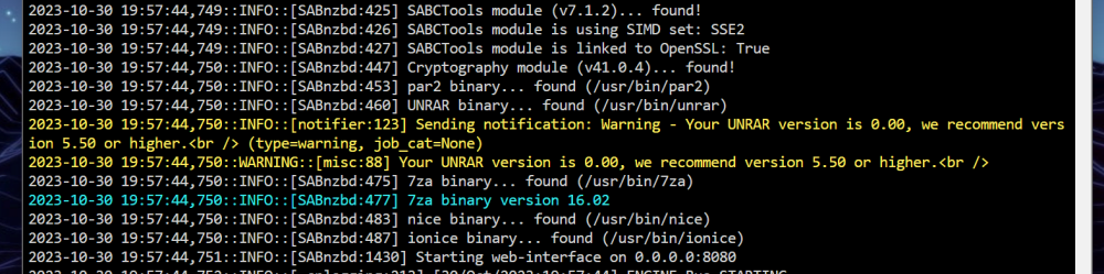

i updated your container for SABnzbd to the latest version today.
i get following error and no file gets unpacked:
Your UNRAR version is 0.00, we recommend version 5.50 or higher.<br />
What can i do about that?
Thanks and good evening
Are you really sure that you are using my container and that you are on the latest version from the container itself? I don't see that over here, actually I see that:
Yeah, dont know what happened?
Do you have custom scripts installed or something like that?
Please try to click force update and see if the issue is persists.
