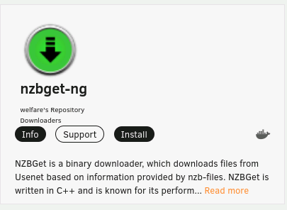

@ich777 I do have problems with German Umlauts in the NZBGet Container. Filenames containing äöü, etc. are cut off in front of these characters. Sometimes these files become deleted - don't know why.
In the NZBGet forum I found old threads about UTF-8 vs. UTF-16 and the NZBGet creator hugbug wrote that NZBGet has no problems.
So my idea is, perhaps the "old" (5.7) unrar in this container has a problem. I'm using NZBGet since many, many years and I don't remember that I always had any problems with these characters in the past.
Is it possible to update unrar in the NZBGet container? It would be a first step to eliminate any problems with unrar. If this doesn't help I need to dig into the preprocessing scripts of NZBGet. It's a long time ago that I wrote those ...
Thanks in advance.
P.S: If you are interested I can PM you a NZB file to show my problem.
NZBGet is deprecated by the main developer and I'm not sure if NZBGet-ng is actively maintained or better speaking if the developer can keep up.
So to speak I've also deprecated the container and it is no longer maintained by me (I know it is currently listed in the CA app and @Squid is investigating why).
You can try to use this container instead:
But as said above I'm not sure if the maintainer can keep up.
I know. I tried sabnzbd in 2023/Q1 but came back to NZBGet. Ressource (e.g. CPU) usage of sabnzbd was way above NZBGet. And the GUI - whow, what a difference between the clear interface of NZBGet compared to sabnzbd. sabnzbd looks to me like a prototyp v0.1. Just my personal opinion.
Will try. Thanks for pointing this out.

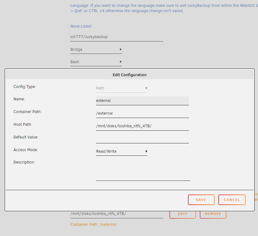

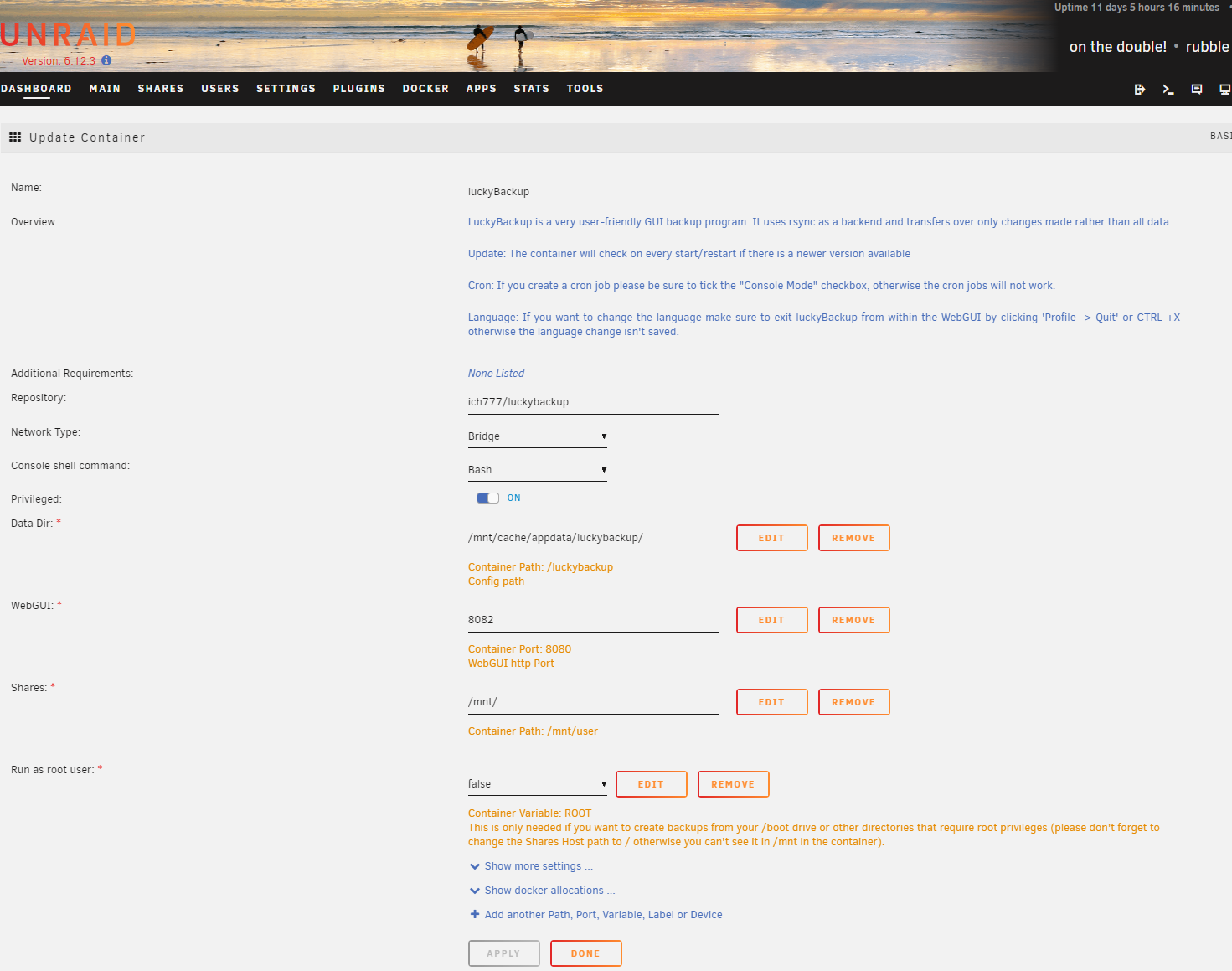

luckybackup write errors to Unassigned Devices USB drive
I'm trying to use Luckybackup in setting up an rsync connection with some recursive folders on my array to an external USB drive mounted via Unassigned Devices. I can send the files to a different spot on the array no problem, but when trying to write to the external USB, I get write errors. Not sure if I'm mounting it wrong, or setup the Luckybackup template incorrectly?
Luckybackup Docker > Console can read and write to the USB drive.
You can see I've passed the /mnt/ to the Docker. Paths are relative in the luckybackup Docker
source
/mnt/user/user/nextcloud/username1
dest
/mnt/user/disks/TOSHIBA_EXT/username1_nextcloud
rubble-diagnostics-20231119-2209.zip
Edited by rutherford

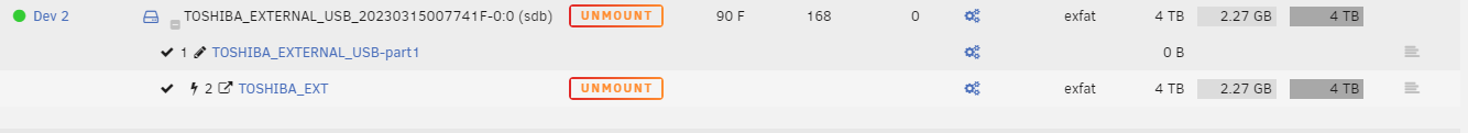

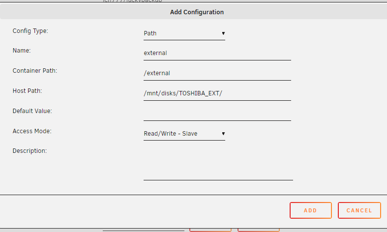

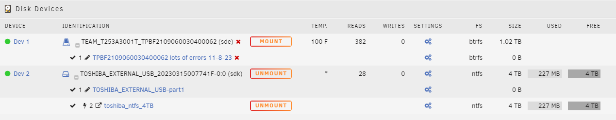

5 hours ago, rutherford said:
dest
i guess its rather /mnt/disks/... and not /mnt/user/disks/...
also, which filesystem does the drive have ?, you run luckybackup as root ?, ...
besides that, NC is critical to backup, are you stopping your NC istance while backing up ... will also provide errors it not, just as sidenote once you have the write issue solved ;)
@alturismo thanks for getting back. Double checking these settings here. I have made no progress :(
luckysync details
source: /mnt/user/nextcloud/username
destination: /external/username_nextcloud
DOCKER settings
Shares: /mnt/user, to /mnt/user
(added Read/Write) /external, to /mnt/disks/TOSHIBA_EXT/
I did add a Port/Path/Variable, I'll include a screen shot. This also depends on Unassigned Devices working, the drive I'm trying to go to is a USB external drive.
on the server, /mnt/user/nextcloud is a user share on xfs drives. The attached USB drive is exfat. Hmmm this might be the issues, need to format it to something more usable.
Got that done: we're on NTFS now on the external drive. Still weird stuff happening. It still creates all the folders, but copies no files.
I'm not running luckybackup as root.
I tried manually stopping the Nextcloud container, same behavior.
before with exfat
reformatted external drive to NTFS2039614574_Screenshot2023-11-20212214.thumb.png.e44e8d229983a4bc18b406f003684080.png
This does need to work. I could return the drive, get another internal drive, and use that as backup. Just keep it out of the array. I like the idea of a separate device though. But it does need to work first!
