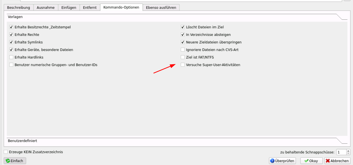

6 minutes ago, rutherford said:
I'm not running luckybackup as root.
that would be the next try
also, there are advanced features in the backup settings
sample
Oh nice! I think that did it. I saw that option in there you pointed at "destination is FAT/NTFS." Seems to be flying over there now. Worked!
