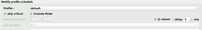

And another Luckybackup question...  I think I know why this is not working, but would love to know if there is a solution to the problem.  I use WOL to wake my backup Unraid server and want LB to wait a few minutes and then run the default profile.  I have LB set up as follows:
This is in the container crontab file:
# ~~~~~~~~~~~~~~~~~~~~~~~~~~~~~~~~~~~~~~ luckybackup entries ~~~~~~~~~~~~~~~~~~~~~~~~~~~~~~~~~~~~~~
@reboot    sleep 300;    /usr/bin/luckybackup -c --no-questions --skip-critical /root/.luckyBackup/profiles/default.profile > /root/.luckyBackup/logs/default-LastCronLog.log 2>&1
# ~~~~~~~~~~~~~~~~~~~~~~~~~~~~~~~~~~~ end of luckybackup entries ~~~~~~~~~~~~~~~~~~~~~~~~~~~~~~~~~~~
I have LB set to start on boot as well.
So, the profile never executes... I suspect it is because the crontab in the docker container never executes.  If this is the case, is there a way around it?
Logs from LB after attempt.

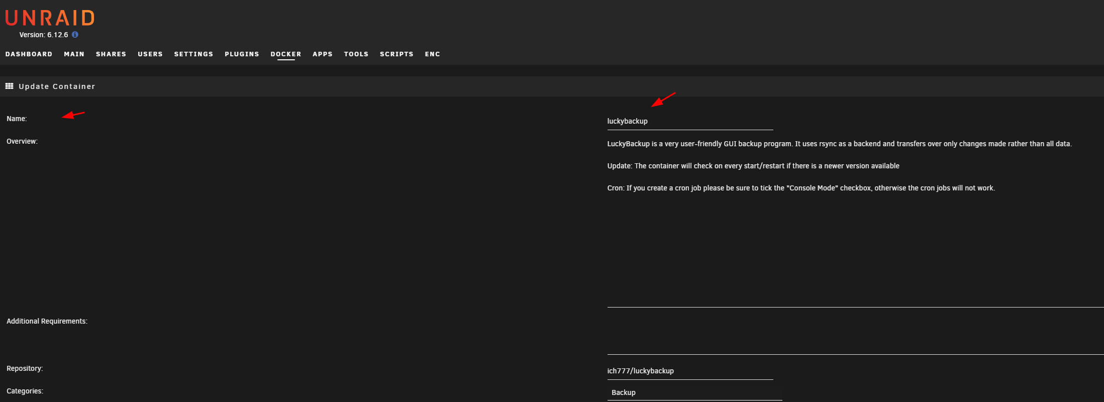

How do I find the real container name?  Is it the prompt on the container console?
the name you setted while you did setup your container ;) case sensitive ...
Hell, that is to easy!  Thanks will test this out.

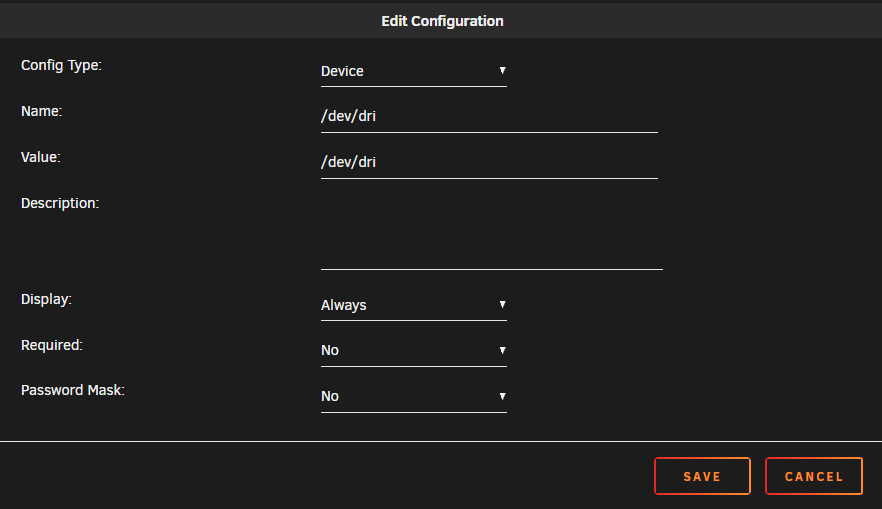

Hi, quick question about Owncast. I'm using a intel IGPU and I was wondering where I should point Owncast to /dev/dri. The container description states the following:
At 'Device' at the bottom here in the template add '/dev/dri'
but I don't see any  Device variable. I tried adding it to Nvidia Visible Devices, but that doesn't seem to work. Do I need to add it to Extra Startup Parameters with a key?
Am I not seeing something or is this Device key missing?
Thanks in advance.
then may just add one ... ?
Container Setup, bottum, add path, device, ...
Name .. doesnt matter, just the value ;)
