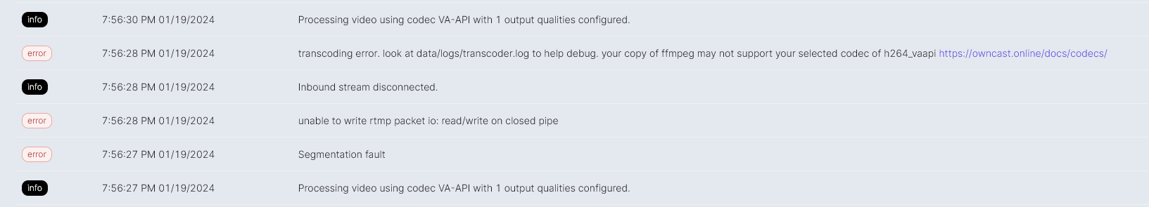

Have this problem when im changing the video codec to use my IGPU. when i use the default then i don't have this issue. But i would and want to try and hit my iGPU.
Please give me a bit more details on what hardware are you using, can you maybe upload your Diagnostics?

31 minutes ago, Paddeh said:
I included my diagnostics. Using an Intel Nuc 13 pro i5 version.
Is HW transcoding working in other applications?
I assume it‘s because you are using a 13th gen CPU.
I just tried it and on 10th gen everything is working so far.
 For Plex its working, but some other services like youtube-dl i can't seem to get it working.
The I assume it's the same for this container, maybe some dependencies are outdated or the Kernel module (driver) is not 100% compatible with the container.
Please wait for a newer Unraid version so that we can test this a bit more in depth, for the time being please don't use VA-API.
