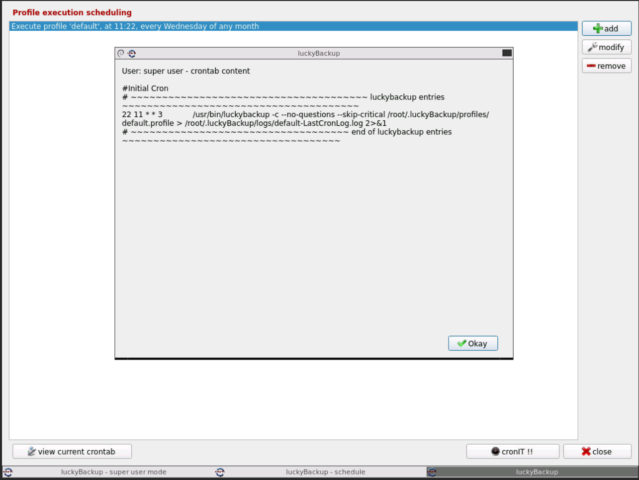

@Mattaton when you ran the 5 minute test yesterday, where it worked, was that a newly schedule job? I am wondering if you need to perhaps remove and recreate the cron entries now that you made the TZ change?
Yes, it was a new test profile and task.
I could try that, but as far as I understood, the entire cron file gets overwritten each time you click CRON it. So, when I added the schedule for the new test profile, it overwrote the original, and then again when I removed the test profile and schedule.
I'm all for giving it a shot, but I'd think the text within defining the schedule would, in a sense, be fresh if the file had been rewritten.
@cybrnook
11am just came and went and the schedule didn't fire the job. So, it's not the 6-hour offset issue.
I removed the schedule. did the cronIT, checked that the entry was now blank. Then I set the schedule up again with console mode enabled as it was before. cronIT and the text for the schedule looks the same. Let's hope it works this time!
6 minutes ago, Mattaton said:
@cybrnook
Create another job in there to run in just a couple minutes, see if that works. Would verify if we're close to something or not.

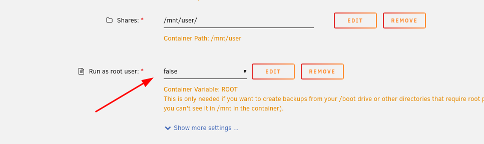

Just now, mjeshurun said:
I'm not sure if I'm using the container as non root.
Go to your Docker page and edit the container in the template you should see this:
If set to false = non root | if set to true = root
There is also a indication on the bottom from the WebUI from the container where it says "luckyBackup - superuser mode" I think.
I did so and it did not run. I don't understand why since the test yesterday ran fine.
I have nuked all schedules and recreated. Cron now looks like this with the test schedule for a couple minutes ago:
User: super user - crontab content
#lnitial Cron
luckybackup entries
0 5 * * * /usr/bin/luckybackup -c --no-questions --skip-critical /root/.luckyBackup/profiles/
daily-5am.profile > Iroot/.luckyBackup/logs/daily-5am-LastCronLog.log 2>&1
15 11 * * * /usr/bin/luckybackup -c --no-questions --skip-critical /root/.luckyBackup/profiles/
daily-5am.profile > /root/.luckyBackup/logs/daily-5am-LastCronLog.log 2>&1
end of luckybackup entries
That looks correct, doesn't it? Should run at 5am and 11:15am according to that, right?
Thanks for the explanation.
My container is currently set to root.
Is it more advisable to run the container as non-root?

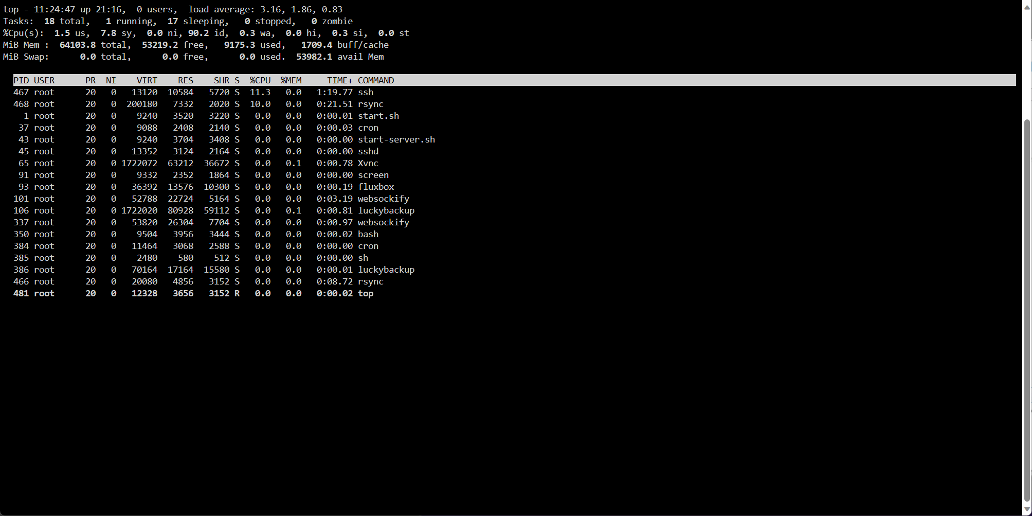

Sorry. Pump the brakes. I just restarted the container and checked the status of each task. Turns out it DID run at 11am, it just hadn't updated the status until I restarted. So, it still ran it at 6 hours after 5am.
Checked the timezone and it still looks right.
root@d841cef0c6d7:/# su - luckybackup
luckybackup@d841cef0c6d7:~$ date
Wed Jan 10 11:24:37 EST 2024
This is annoying, because this just worked with my test yesterday. 😕
#lnitial Cron
luckybackup entries
#lnitial Cron
luckybackup entries
This does not look right? Why "I"root and not /root
Edited by cybrnook
Just now, cybrnook said:
This does not look right? Why "I"root and not just root.
Sorry...using Windows Power Toys Text Extractor to pull the text from the VNC session since I can't copy and paste. It just swapped in an I for the /. It's correct I just missed that when I posted.
