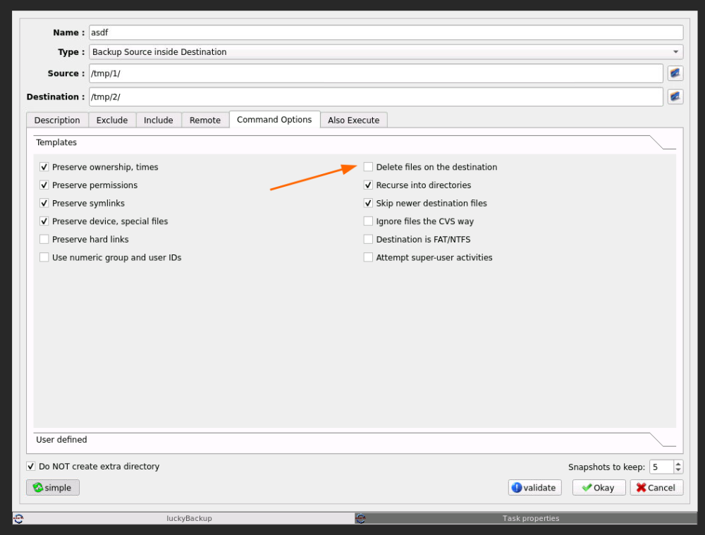

LuckyBackups:
I recently went through and changed my file structure for how i was housing media.  I went through Luckybackups and updated the source/target paths and everything seems to be working now, but i've been going through and upgrading older low quality versions of movies to new high quality ones and i'm wondering if its possible for Luckybackups to remove the old copies that had previously been backed up.
The top is my main server, and bottom is my backup.
My backup is onsite, so its not the end of the world if i have to just trash and re-backup, but i'd rather not have to write about 40tb of data if i dont have to.
Edited by danimal86
Hope that helps:

1 hour ago, ich777 said:
Hope that helps:
strange, i enabled that "delete files on the destination" but it appears that it just copied but didn't remove the old one.
does rsync go through and delete at the very end after copying?
Hmmm, thats strange…
Depends on how you‘ve set up the job but in general yes.
On my system this is working just fine…
Ok.  I'll let it run and then see what it does.  I just didn't want to have a bunch of duplicates
I can only tell you from the backups that I create with luckyBackup it is working as expected and it deletes the files in the destination which are not existing in the source.
Just following up....it does in fact delete all the files that weren't on the source at the end of the transfer.
Thanks for your help.
