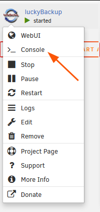

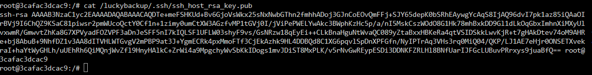

Then I clicked console:

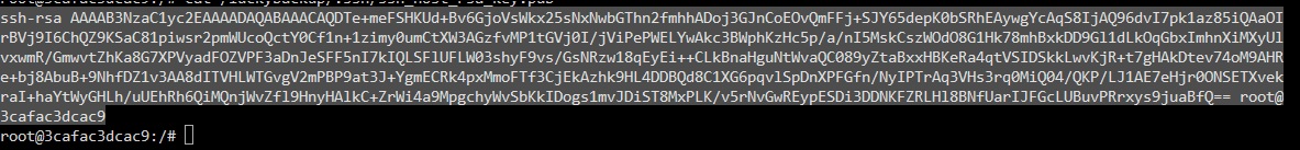

There I typed in: cat /luckybackup/.ssh/ssh_host_rsa_key.pub
and got this:
There simply mark the whole lines starting from ssh all the way to the last line and click the right mouse button once and click copy from the context menu to copy the contents:
Mark only until the end and then close the window.

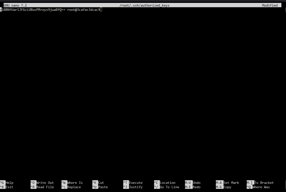

Then open up a terminal from you main server with this icon: grafik.png.0a073948eb621ef049622f7a48eb5497.png
There type in: nano ~/.ssh/authorized_keys
In nano right click somewhere on the black free space and select past from the contextmenu:
Next you have to press on your keyboard: "CTRL + X" followed by "Y" followed by "ENTER" <- this will safe the file

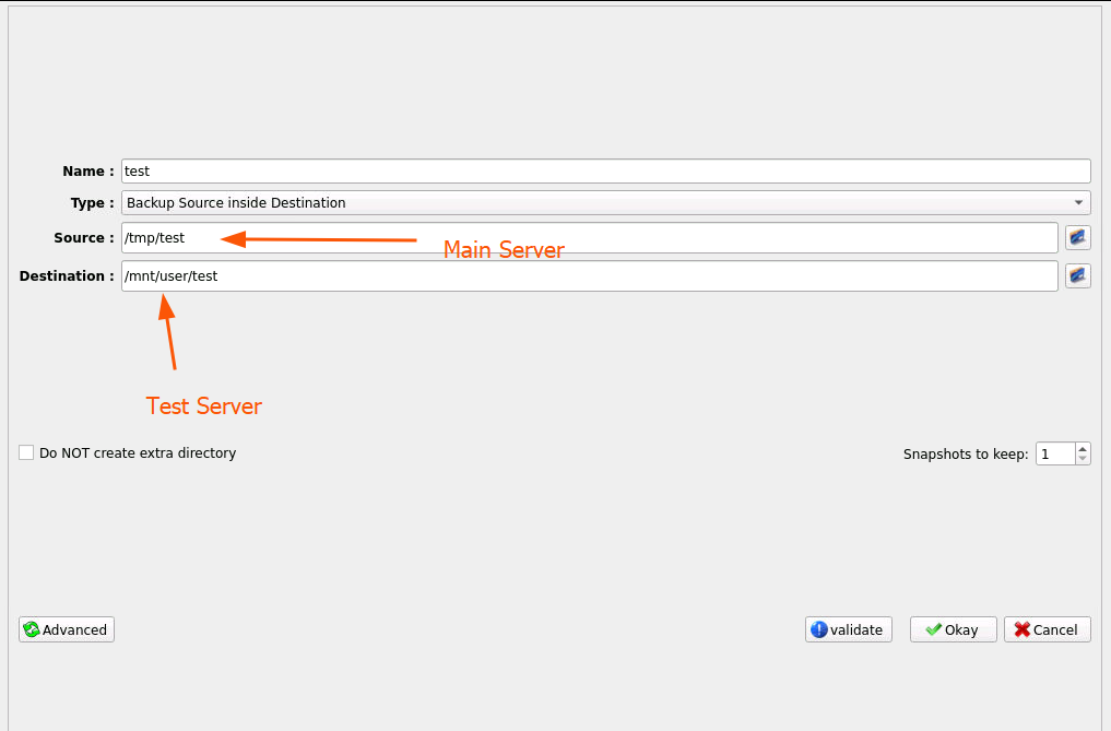

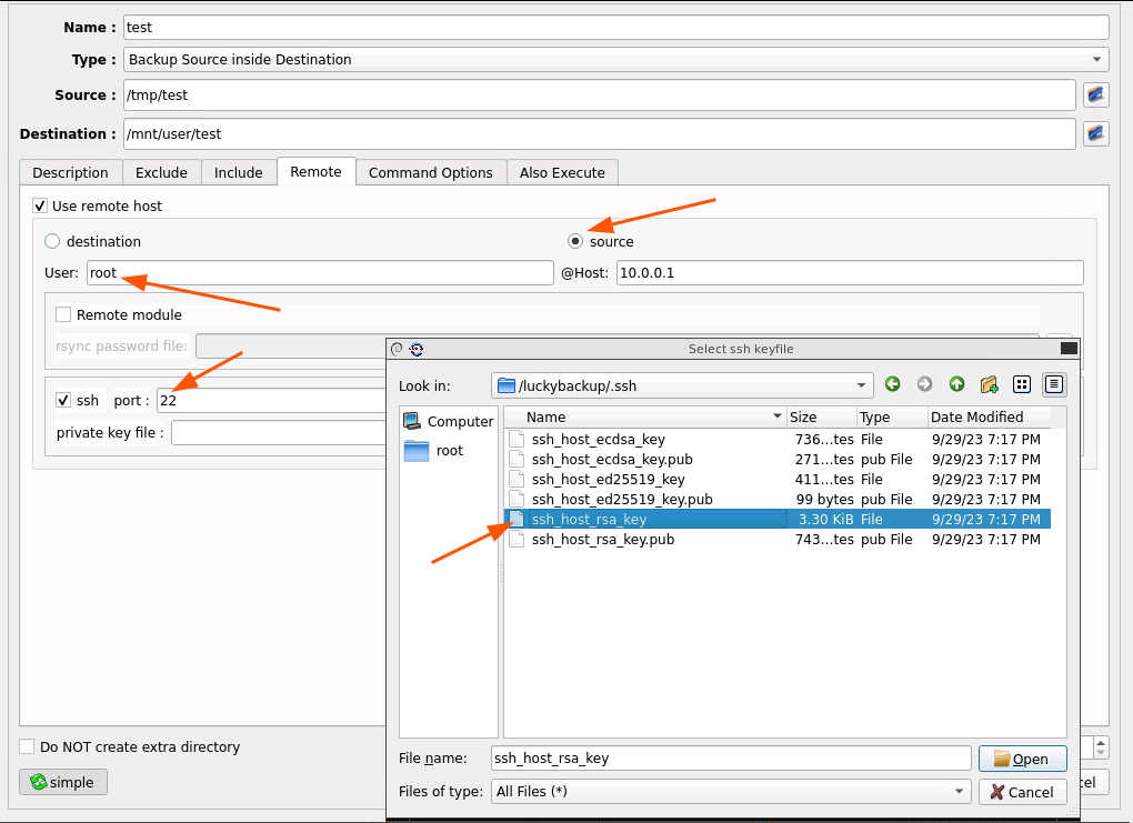

Then I opened the WebUI from luckyBackup on my test server and created the test sync:
(please note that you have to create the folder on the destionation if it not exists! <- I would also recommend to click "Do NOT create extra directory" which I did afterwards, otherwise you will end up with another folder called test)
The I clicked on Advanced and set up the key file:
(please be sure to select this exact file and set it up as source)

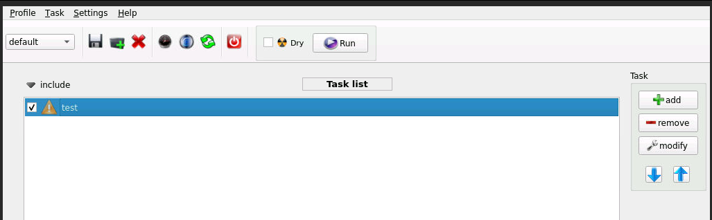

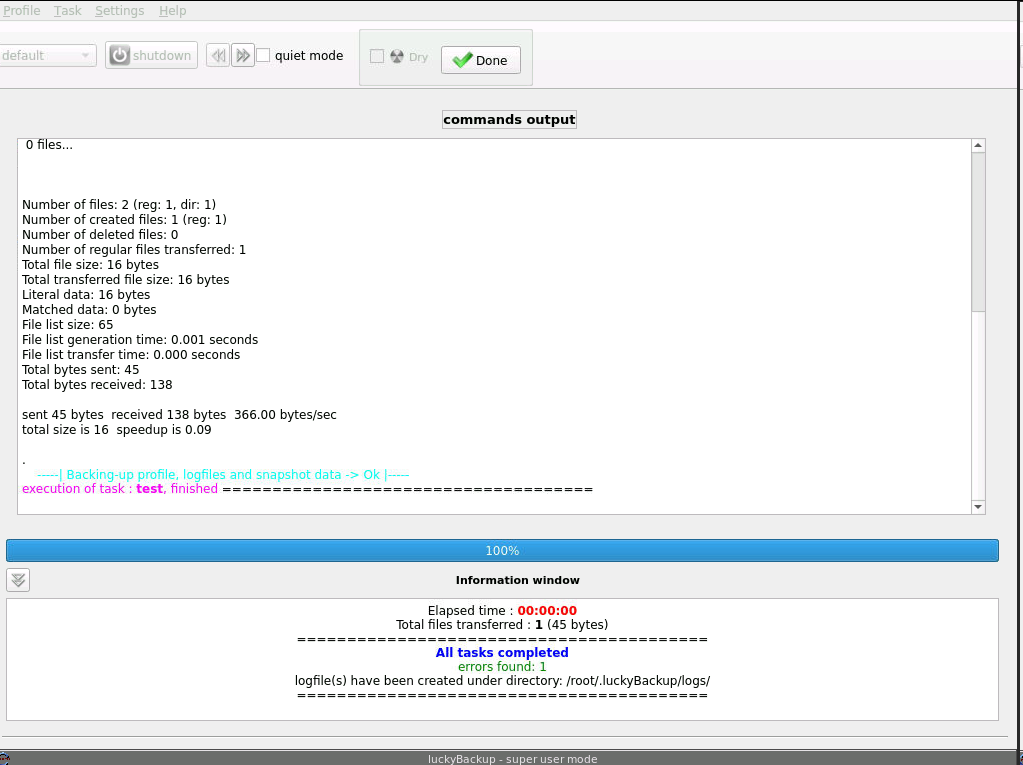

Then I selected the sync and clicked start:

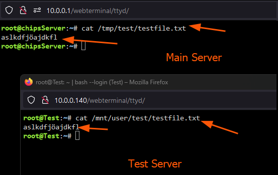

Here you can see that the sync from my main server to the test server was successful:
Here I made also a screenshot where you can see that the test file is now also available in the correct directory on my test server:
