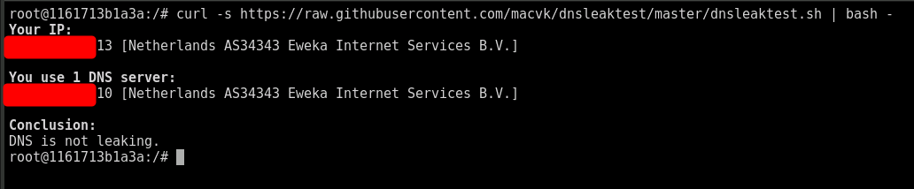

16 minutes ago, Merijeek said:
So then I tried this:
Then try this (just copy paste all):
cd /tmp
curl -s https://raw.githubusercontent.com/macvk/dnsleaktest/master/dnsleaktest.sh -o dnsleaktest.sh
chmod +x dnsleaktest.sh
./dnsleaktest.sh
rm dnsleaktest.sh

OK well, some progress!
root@b43d57320d68:/# cd /tmp
root@b43d57320d68:/tmp# curl -s https://raw.githubusercontent.com/macvk/dnsleaktest/master/dnsleaktest.sh -o dnsleaktest.sh
root@b43d57320d68:/tmp# chmod +x dnsleaktest.sh
./dnsleaktest.sh
Your IP:
181.214.153.146 [Canada, AS174 Cogent Communications]
You use 1 DNS server:
162.158.145.99 [Canada, AS13335 CloudFlare Inc.]
Conclusion:
DNS may be leaking.
root@b43d57320d68:/tmp# rm dnsleaktest.sh
Note: The above was actually from the OpenVPN container itself.
I had to add some packages to get it working from another container, but finally got there:
./dnsleaktest.sh
Your IP:
Conclusion:
DNS may be leaking.
Edited by Merijeek

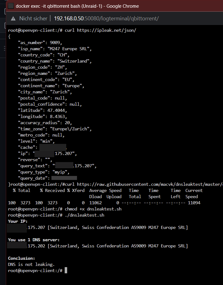

I can't reproduce this with privado.io
  % Total    % Received % Xferd  Average Speed   Time    Time     Time  Current
                                 Dload  Upload   Total   Spent    Left  Speed
100  3273  100  3273    0     0   3561      0 --:--:-- --:--:-- --:--:--  3557
# ./dnsleaktest.sh
Your IP:
<REMOVED> [Switzerland, Swiss Confederation, AS9009 M247 Europe SRL]
Conclusion:
DNS is not leaking.

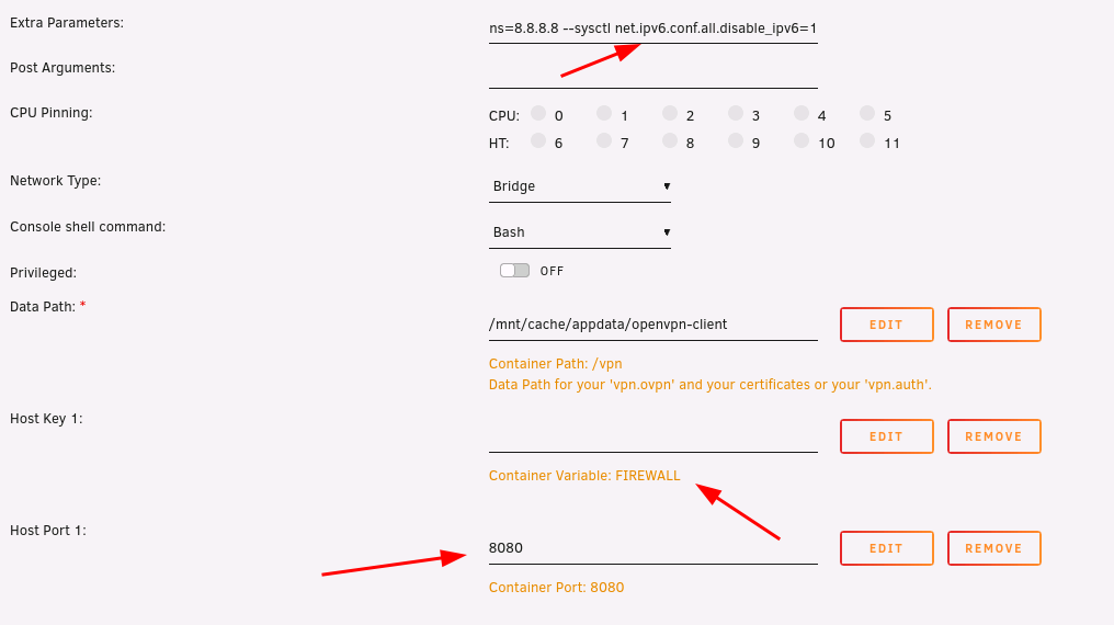

if i had a question about routing while using the Open-VPN client where would you like my question to go. I have an existing post on this forum  --
and JorgeB suggested i go through the support route for the Container... which leads me here.
I've done a quick read on the other thread but the OpenVPN client is not designed what you want to do here.
It is designed to connect to a OpenVPN server which then can be shared with other containers so that they can use the VPN connection but not a site to site connection.
However what you can try is that you install a Firefox container along side with the OpenVPN container and share the network from the OpenVPN container with the Firefox container and connect through to the Firefox browser with the remote Unraid system.
Please keep in mind that you may have to set up proper routes so that your remote server can communicate with your local network which can be complicated and I can't help with that.
Do you have a second Unraid machine at home? If yes, why not create a site-to-site connection with the built in Wireguard Tunnel.

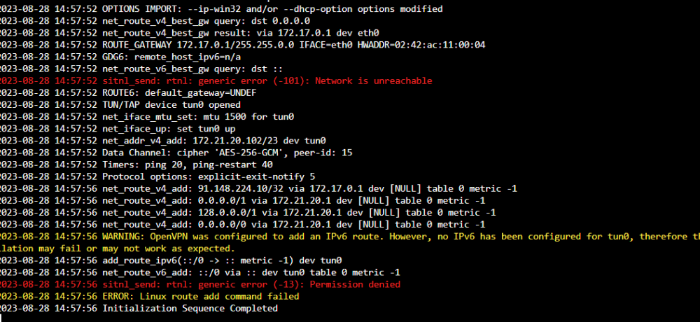

1 hour ago, ich777 said:
I think you are doing something differently because I asked a second user and he also had no issues at all.
Why? This is pretty easy if you follow the steps from the description.
I don't know. I appear to have broken it via all the experimenting I was going.
As far as me doing something differently, anything is possible, but I don't know how. So this is from scratch

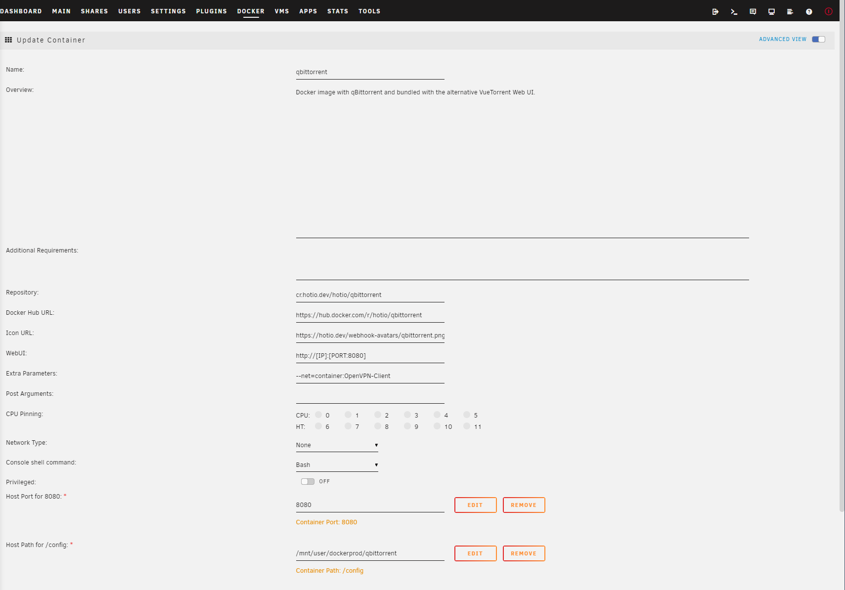

Completely basic setup:
docker run
  -d
  --name='OpenVPN-Client'
  --net='bridge'
  -e TZ="America/Los_Angeles"
  -e HOST_OS="Unraid"
  -e HOST_HOSTNAME="UnRAID"
  -e HOST_CONTAINERNAME="OpenVPN-Client"
  -l net.unraid.docker.icon='https://raw.githubusercontent.com/ich777/docker-templates/master/ich777/images/openvpn-client.png'
  -v '/mnt/user/dockerprod/openvpn-client':'/vpn':'rw'
  -v '/mnt/user':'/unraid':'rw'
  --device='/dev/net/tun'
  --cap-add=NET_ADMIN
  --dns=8.8.8.8
  --sysctl net.ipv6.conf.all.disable_ipv6=1 'ich777/openvpn-client'
3e6f00443e5eb78367d475fc7c85ac77abce767e3cec71323b901fe137c34c64
The command finished successfully!

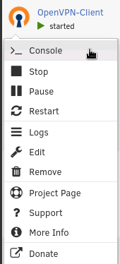

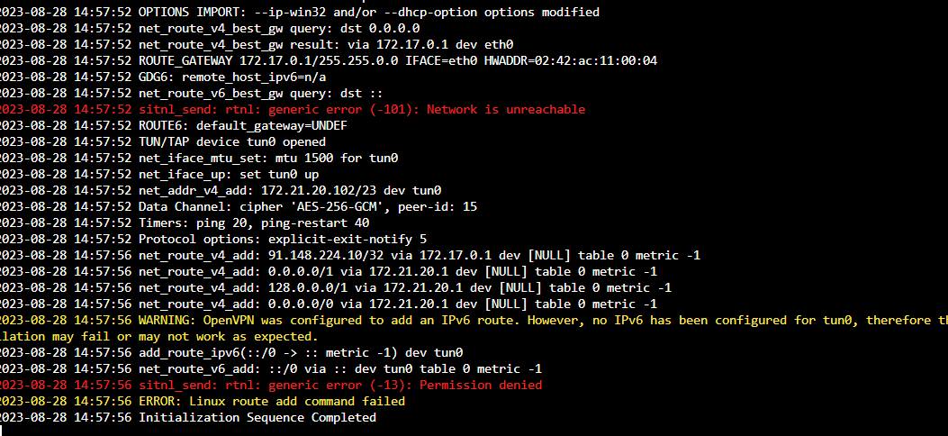

Created an OVPN file over at PIA, then put it and creds in the right spot:
And it looks like it's up after a restart:

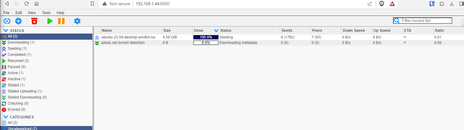

My QBT and OVPN containers can both ping the outside world via DNS.

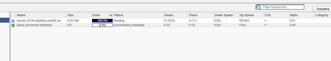

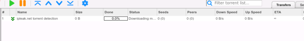

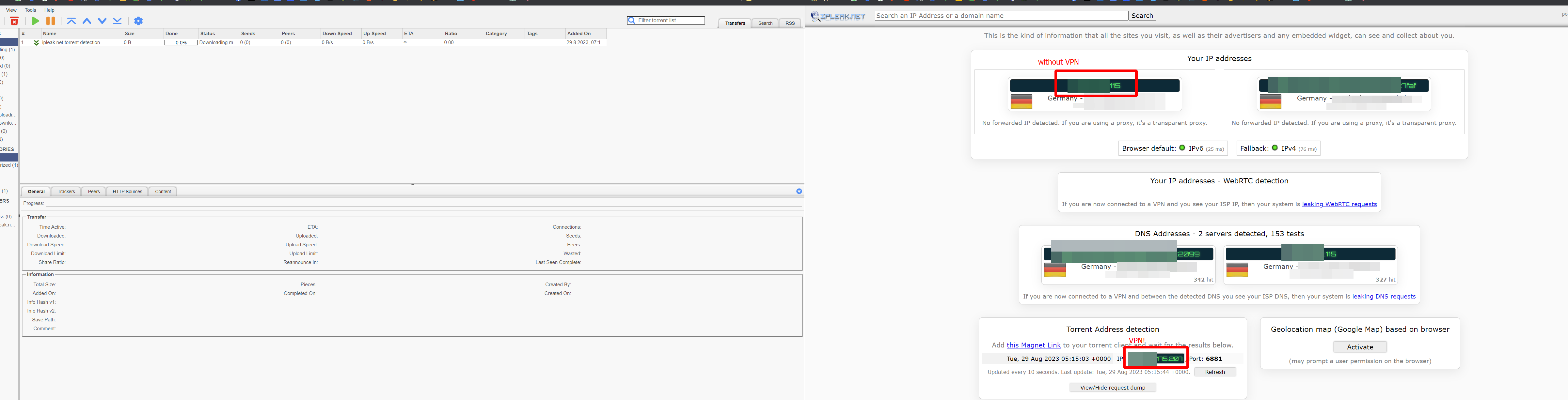

I've got this happy and good and completely legal torrent that finished a few minutes ago:

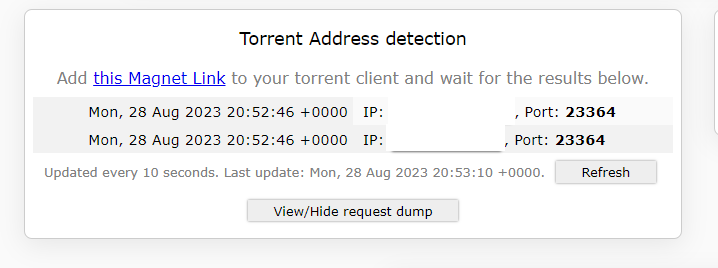

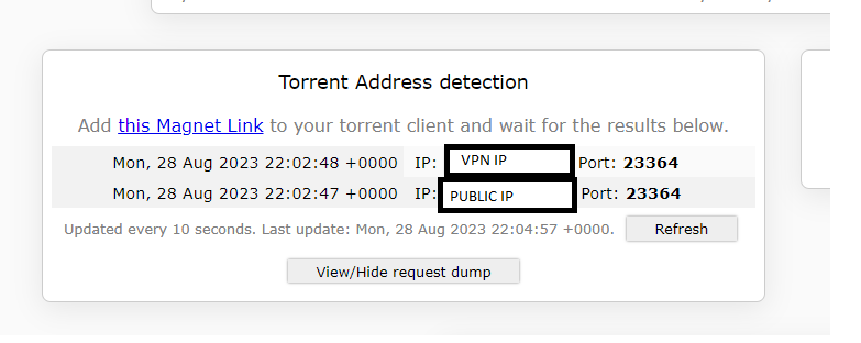

And I go and visit this site: https://ipleak.net/ and choose the "Torrent Address Detection" button, and then grab the magnet link and pop it into QBT:
And when I go back to ipleak, I see:
The top one being the VPN address, the bottom one being my own public IP.

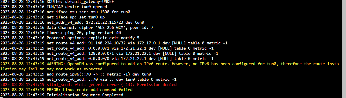

....so then he goes ahead and does the same thing. Shuts down all dockers and changes the ovpn.vpn and auth.vpn files to the Privado versions.
OVPN file is Privado's: ams-001.default (renamed, of course)
Connected:

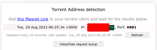

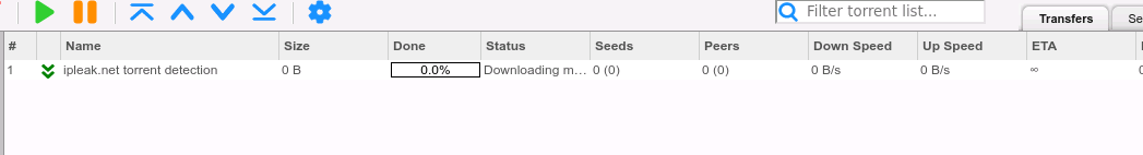

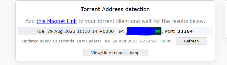

Go back to IPLeak, grab  a new magnet and put it into QBT:
...and poof, pretty much instantly
Finally, lacking any better ideas, I change the DNS that the OVPN container is using.
....and boom, same as above.
Meanwhile, on my extra Windows machine running the PIA client, I go through the same tests, and only my PIA VPN IP ever shows up in the ipleak site.
I'm not saying I'm not possibly doing something wrong here, but I don't see how I can be.

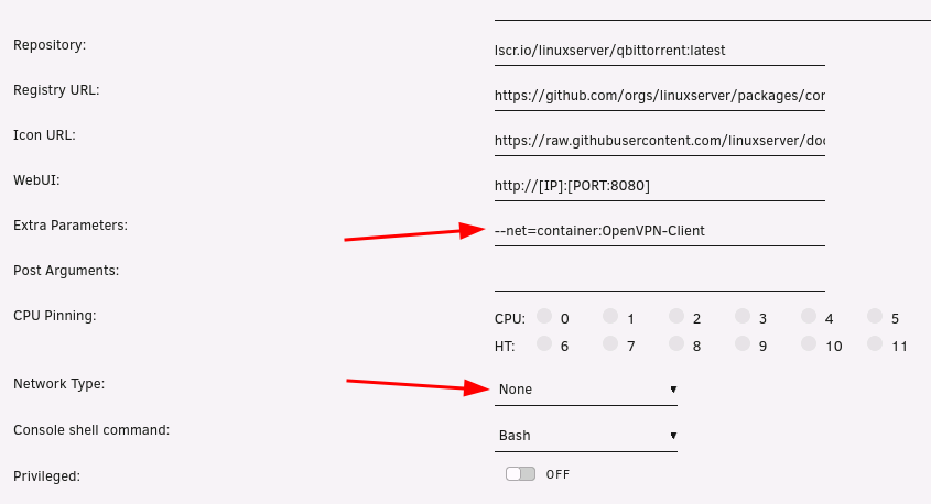

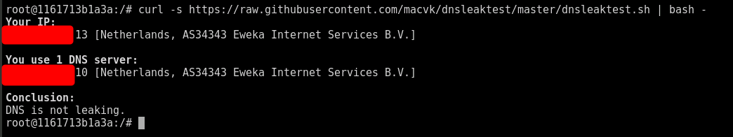

i added LSIO's qbitorrent just for testing... can't reproduce it. it isn't the ovpn-client client. it must be you setup.
Edited by sonic6

there are no ports or the firewall, which is needed in bridge mode, or i am wrong?
As @sonic6 said, something seems off, can you please also post a screenshot from your torrent container with the Advanced View enabled?
I think there is a general configuration issue.
I've now also tried it with the ams-001.default file (@iviv this is maybe also interesting for you) :

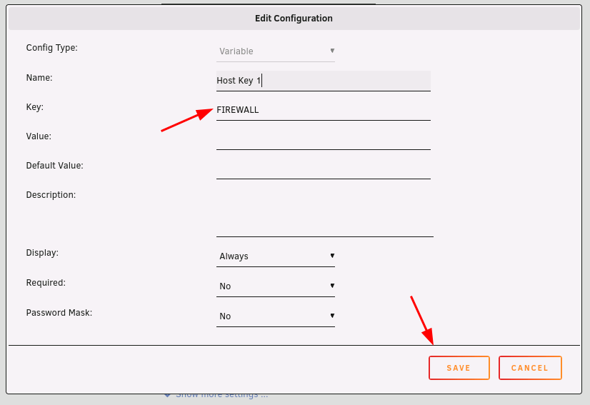

First I've created the OpenVPN-Client container (this is a completely fresh installation) :

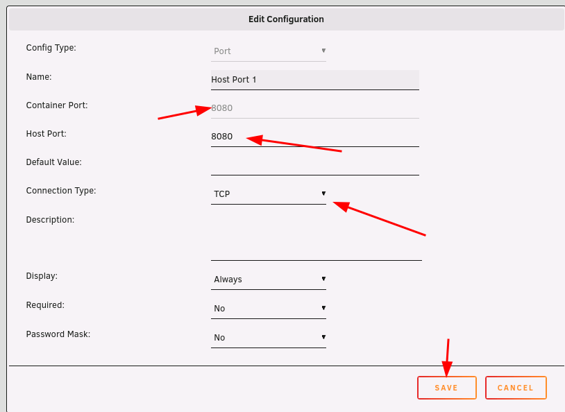

Then I clicked this button in the OpenVPN-Client template to add a variable and a new port entry:
This is the variable (this will ensure that no outgoing traffic is possible when the VPN connection is not established, strictly speaking you don't have to create that variable but I recommend it) :
This port is necessary because you route the traffic from the torrent client through the OpenVPN-Client and the torrent client has strictly speaking no own network anymore and you have to create all ports that you want to be reachable from outside the torrent container in the OpenVPN-Client template:

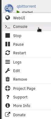

Then I ensured that the container doesn't leak by opening the console:
And issuing the command that I've provided (a bit modified, but it does the same) :

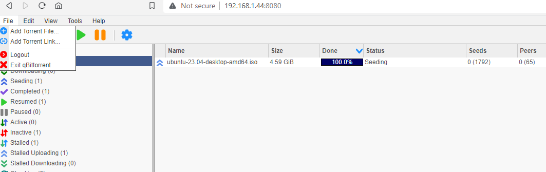

Then I created the torrent container and changing the Network Type to None and in the Extra Parameters you have to tell the torrent container that it uses the container network from OpenVPN-Client:
Then I ensured that there is no leak in the torrent container by opening up the console (please note that the WebUI button in the torrent container is not working anymore because it has no network anymore, you have to type in the IP:PORT manually in the address bar like 192.168.0.10:8080 to open the WebUI from the torrent client) :
I issued the command again:
Then I went over to the leak testing thing and this is my real IP (I removed basically everything except for the last digit but you should see that the IPs are different) :
Then I copied the Magnet Link and pasted it into the torrent client (you have to open up a browser and enter the IP followed by the port manually because the WebUI button doesn't work anymore as explained above) :
And back to the leak tester you can see that there is only one IP (from the VPN) :
Hope that makes sense.

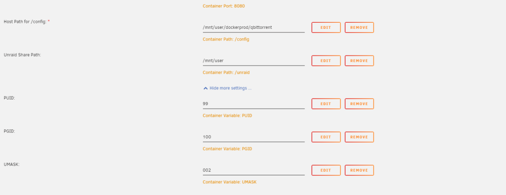

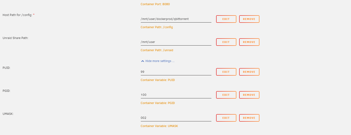

Here's some shots of my advanced QBT setup:
As you can see, not much to it.
However, I did add the FIREWALL variable to the OpenVPN container and so far I seem to be showing good:
So...I'll throw a few more things in there and check back and see what I can see.
@Merijeek the forwarded Ports are still Missing in your ovpn-client Container.
Yeah, that was just a shot from before I did it. They're there and I can reach the containers behind it.
