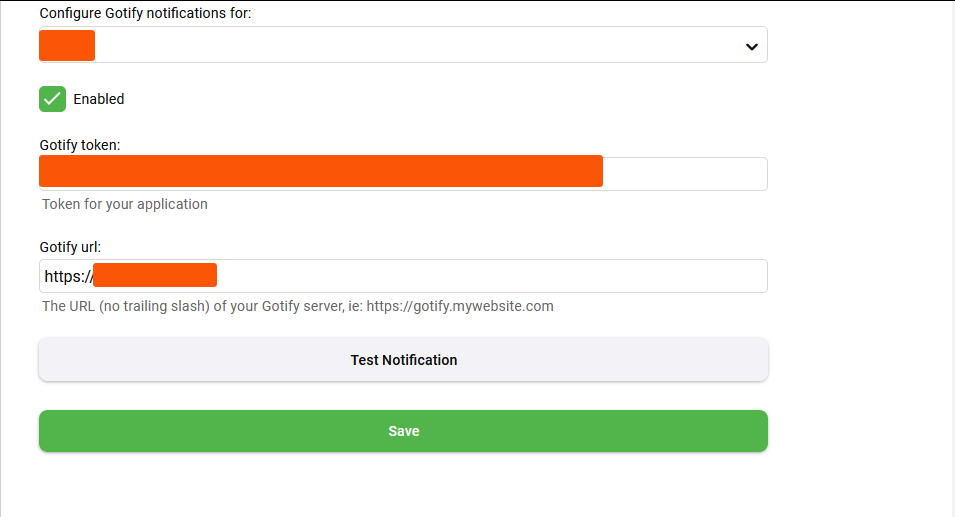

I have some Problems regarding Pushbits and the Jellyfin webhook plugin. I understand that I can use the gotify option in the webhook plugin, but I can't get it to work for some reason. For Server URL, I use my internal Jellyfin IP, for Webhook URL I use the Host IP of the PushBits container. A application for the token for Jellyfin was made with pbcli, i put the token into field. I used this template.
TBH I really don't know that plugin but after a short search I find this: Click
I'm not too sure how this is working since I've never used a Webhook for that but usually there are plugins out there for such things.
For example for Emby there is a plugin out there which supports Gotify which in theory should also support Jellyfin: Click
It looks like this on Emby for me:
Maybe someone also created a plugin for Jellyfin for Gotify?

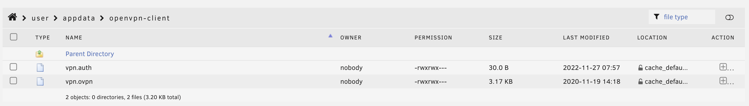

I am having an issue with Open-VPN.
Out of the blue I started getting the errors below.
I checked the VPN credentials and configuration file and nothing has changed.  The only thing I have done recently on my unraid server is add a second cache drive.  I did move appdata to this new cache drive so not sure if this created the issue?  Haven't seen issues with any other apps so far.
Thanks.
Unraid 6.11.5
Docker last updated July 2, 2023
ls: cannot access '/vpn/*': No such file or directory
Error: ipv4: FIB table does not exist.
Dump terminated
grep: /vpn/vpn.conf: No such file or directory
+ exec sg vpn -c 'openvpn --cd /vpn --config /vpn/vpn.conf --script-security 2 --redirect-gateway def1                 '
Dump terminated
ERROR: VPN not configured!
ERROR: VPN CA cert missing!
Options error: In [CMD-LINE]:1: Error opening configuration file: /vpn/vpn.conf
Use --help for more information.
---Taking ownership of data...---
---Starting...---
I also don‘t know whats wrong with that little information and what changed, how is you template configured, how is your share configured where OpenVPN is located on?
It is definitely the case that it can‘t read the files.
Unraid 6.11.5
I would recommend that you uprade to something recent like 6.12.3

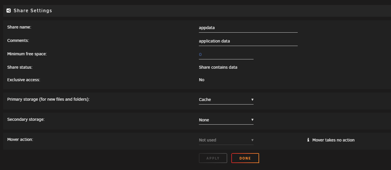

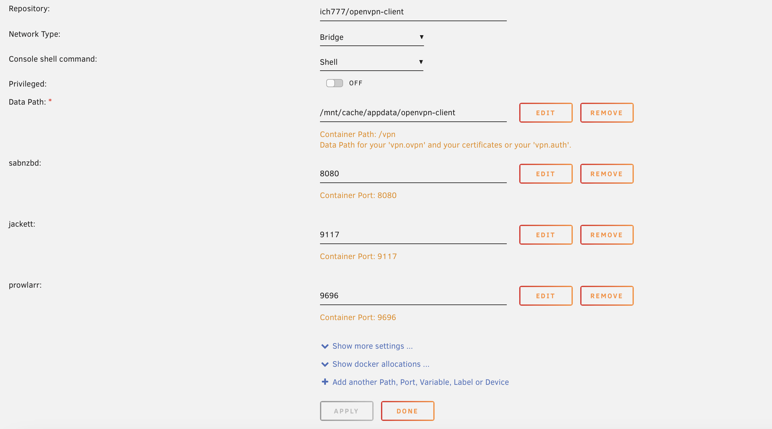

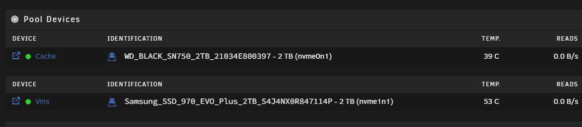

I upgraded to 6.12.3
The change I made was to add a second cache drive and I moved the appdata cache to this second cache drive.  Not sure if this caused the problem, but it's the only thing I changed so just assuming this was the cause.
Here is my information (below).  Happy to include more info as needed to help diagnose this.  Thanks.
may a screen from your main page, specially the part from your cache pool devices ... and/or from your sharesettings appdata
as you see in your pics, you "hardsetted" /mnt/cache/appdata/... for this Docker, while you posted now /mnt/user/appdata/... so i assume you moved to like .../cache2/... or whatever and there is your reason.

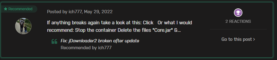

I'm getting a weird error message when I started the JDownloader 2 container today. Seems its stuck while doing some kind of update. And then this message pops up:
Edited by matuopm
when you google it you ll find the fix, it was like deleting some files and 1 folder when i remember correctly.
stop the container, delete the files, start the container, done.
Yea sorry. I found it in the meanwhile. It was the pinned post.
But thank you for giving support !

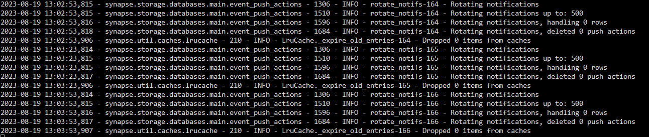

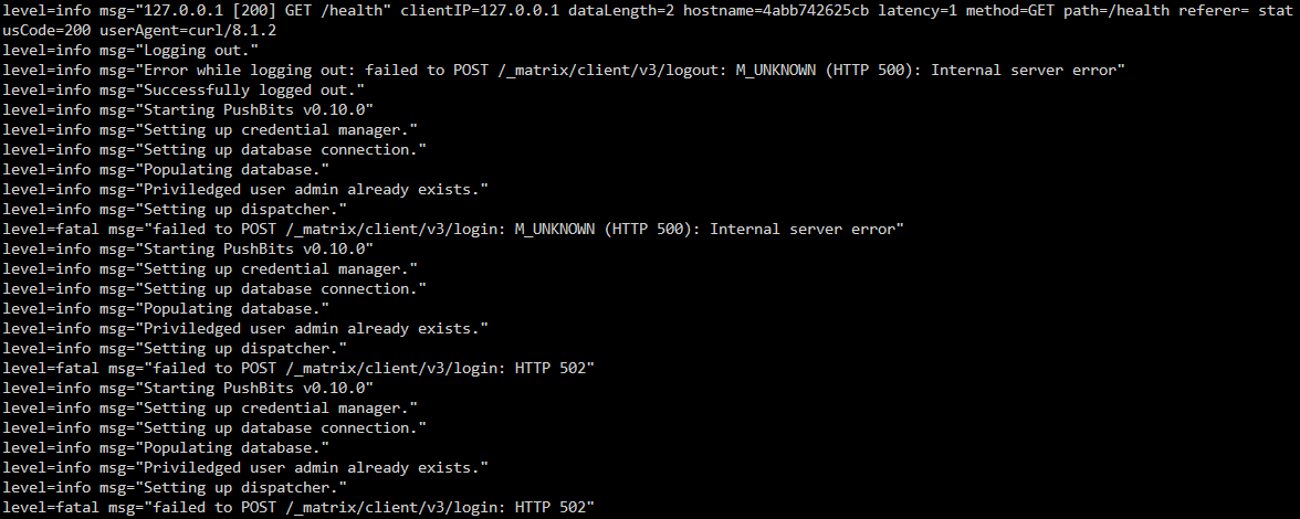

I get some weird behaviour with PushBits. It works normal for several hours and then, the container shuts down for some reason. I can't figure out how to interpret the information in the log.
It seems that your Matrix instance is not stable or at least it can't stay connected.
How often do you run CA Backup <- if you have it installed?
A 502 error usually means a Bad Gateway.
I run it daily.

Does your matrix-synapse log look like this too?
How do I login? I've set a password in the setup but I use username as "admin" and I'm denied. Pretty sure I'm using the right password (as I typed in in) but maybe the username is something else?
sample
Awesome - now I am getting it.  I did add a second cache but I renamed both of the caches to define their specific use.
This appears to be the only docker I have installed that has a data path specified so presumably the other dockers were fine with the change in name of the cache.
I am in the process of moving the cache files back onto the array and then onto the new cache right now.  When I am done I assume I update this from "/mnt/cache/appdata/openvpn-client" to "/mnt/new_cache/appdata/openvpn-client"?  Thanks for the help.
Nope, as far as I remember.
I don't have any such messages in the log, only for startup and shutdown.
Correct.
