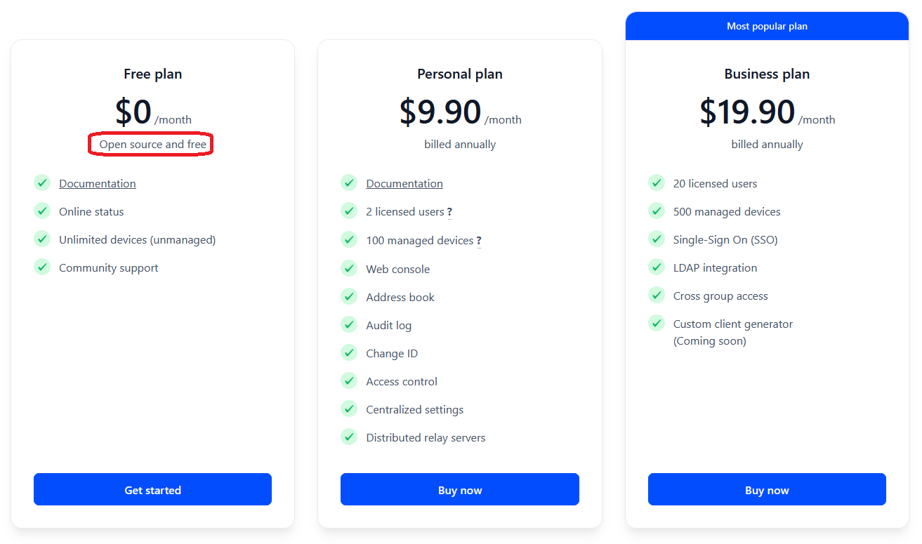

9 hours ago, Nofences said:
Can anyone confirm if the RustDesk-AIO is compatible with the new PRO option from the RustDesk team?
I don‘t think so since this is another product since you have to pay for it monthly or annually.
What are the benefits from Pro compared to the Opensource version? I should have looked at the pricing first, there are the benefits... :D
But I have to say I will stick to the Opensource version.
Do they plan to deprecate the Opensource version? Confirmed by @sonic6 that it will be not deprecated because they list it on the pricing page as the 0,- tier.
As you can see from the screenshot below my container is only for the 0,- tier, the Pro version that you are referring to are the paid tiers.
No, the Opensource will be free, but only with base features.

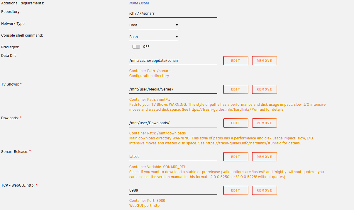

Hello,
The way the forums are laid out for apps like these is not very conducive to researching and correcting problems on our own.
With that out of the way, I'm trying to get the *arr apps working however when I try to add my existing media to them, I get the following error:
And it doesn't seem to matter what PUID and PGID I input, I get the same error (just different user). How do I fix this?
Thanks.

Sonarr, by ich777, yes. I added those variables in effort to remedy the permissions issues.

In my container you can use UID and GID, just click on the Show more … text and you will see them. 😉
Just check if your permissions for Media are set correctly or you can also run Fix permission from the tools menu but only for your Media folder.
This should help.

I tried running the New Permissions tool but that did not help. I've tried a couple other Sonarr apps (binhex, linuxserver) and they all share the same issue. I am able to copy/paste/move files around so I'm not sure what's up with the permissions.

Are you sure that you‘ve set root directory in Sonarr itself to /mnt/tv since you‘ve mounted it from the host to that directory.

What I have is in the screenshot above.
Oh, you mean in Sonarr itself while it is running. Yes, I'm navigating /mnt/tv and it does show all of the files in there but I'm prompted with the error stating that the folder is not writable by user sonarr.

This is really strange.
Did you change anything in the mount itself in the template?
Ususally the user Sonarr has the UID 99
To what permissions and users and group are your files and folers are set on the host.
It should be nobody for the user on the host (this is basically the UID 99)

The only thing I changed on the template was the location of the media files. Permissions are all defaulted to whatever the New Permissions tool sets them to.

Interesting. I figured it out. Apparently if pool is 90% full it will completely prevent writes. I'm in the process of upgrading the 4TB drives that are in it now; once I replaced the first one Sonarr is happy. Wish I had known that, it would have saved me some frustration yesterday on this.
I'm in the process of moving from TrueNAS SCALE.

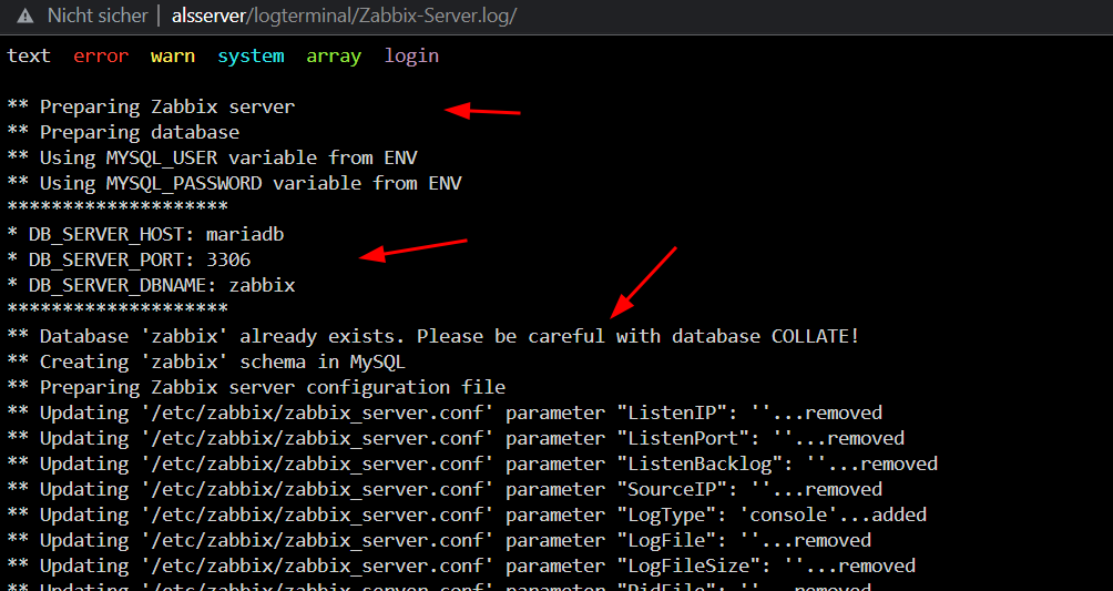

I’m have been having a horrible time trying to set up Zebbix! For whatever reason, no matter what I do, the Zebbix server can't find my mySQL database (I am using MariaDB) I continue to get “MySQL server is not available. Waiting 5 sec” in my live log terminal. I’m not sure what to do, I’ve checked ip’s, ports, names, database usernames, database passwords etc.
Hopefully someone might have a fix!

may take a look if your database container is reachable from your zabbix server, console from zabbix, ping mariadb
i dont use it, but just made a quick mockup and its working fine
and you are sure you created the database, user and pass already in mariadb ?

I pinged mariadb from the Zabbix server console and it was successful. Unless you need to run a command else where, I just set the database name, user and pass while installing mariadb. Would you mind showing me how you set this up? - no matter what I do right now I can’t get it to go to the database after the “DB_SERVER_DBNAME” in the logs.
