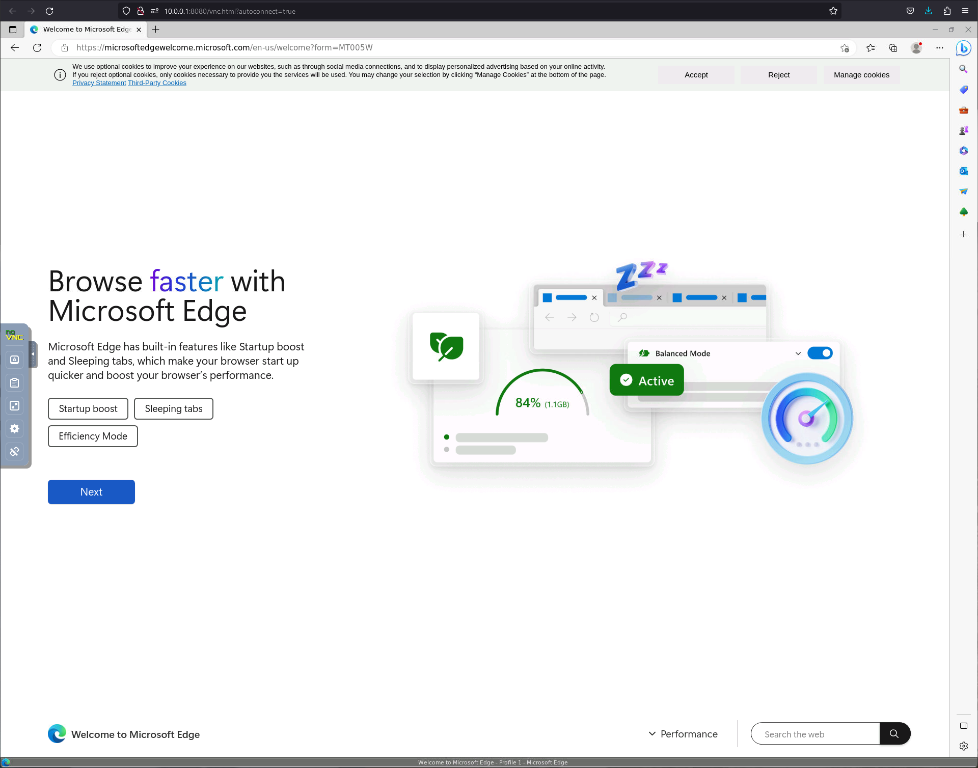

Hi, I am getting the below with the Edge docker:
---Taking ownership of data...---
---Starting...---
---Microsoft Edge not installed, please wait installing...---
---Something went wrong, can't download Microsoft Edge, putting container in sleep mode---
I've tried supplying a version to MS_EDGE_V as well as "latest" with no luck
No issue over here:
Here is the log from a fresh installed container: edge.log
Do you have any AdBlocking software on your network or a UniFi Firewall that maybe blocks the download?
Please do the following:
  1. Delete the container
  2. Delete the edge folder which lives in your appdata directory
  3. Pull a fresh copy from the CA App and leave everything as it is and try if it works <- this is what I've did
Thanks, that did the trick :)

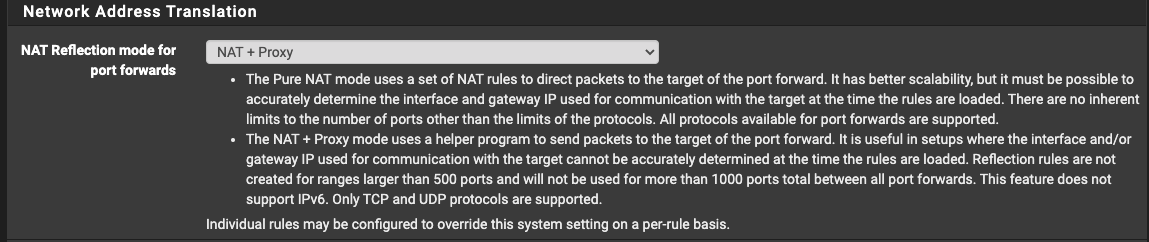

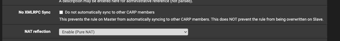

I can't seem to get the container for RustDesk working at ALL today. Not seeing anything in docker logs. Forwarding ports to Unraid server from pfSense. A record on Cloudflare with proxy off to home IP/pfSense.
What could I be doing wrong?

I figured mine out - but never had to muck with such setting before. In pfSense I had to change Nat Reflection for that port forward group to "Pure NAT".
My default mode for the firewall has always been "NAT + Proxy":
1782474408_ScreenShot2023-05-26at6_43_40AM.thumb.png.bfdb381d7cc853e4184416cb67c902e2.png
On port forwards for RustDesk I had to change it to ""Pure NAT":
1295148221_ScreenShot2023-05-26at6_44_58AM.thumb.png.e1d39090d80555aa1f064db31736e49e.png
Not sure if this may help some other lost person later but ich777 THANK YOU for your confirmations that it was just something stupid I was up to!
