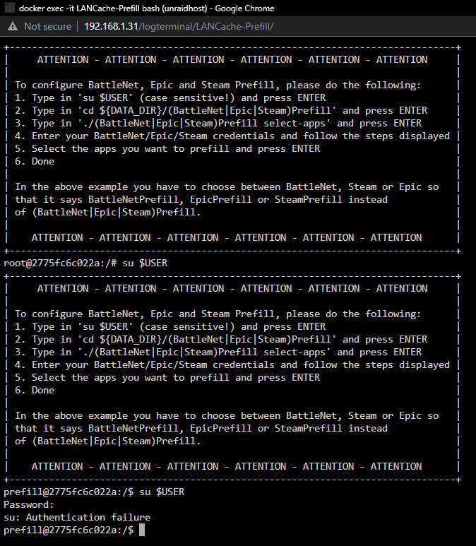

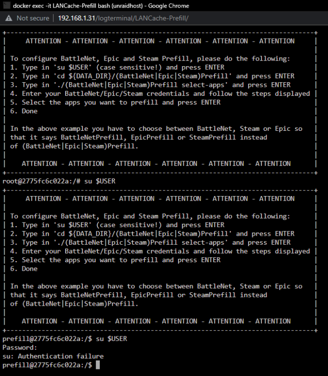

Hey,
I've been trying to set up a epic-lancache-prefill in unraid however when I open a console and type 'su $USER' it asks me for a password. I try my management access password and then my shares access password but its only returning 'Authentication failure'.
Just wondering if anyone could tell me why it's failing or maybe what my password is or something? Thanks.
 Because you‘ve typed it in twice. Just follow it step by step.
Type in su $USER
Type in cd…. And so on
After some failed attempts I got it working, thanks for your help.
