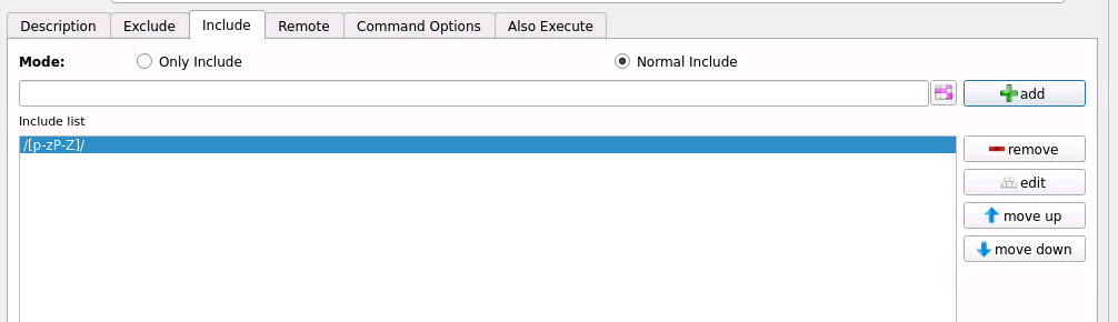

using this it starts to transfer the whole directory : folder starting with a number and i stopped it.
Do you also have the exclude pattern applied? Without it it won't work.
Are you sure that you have the lower case letters first and the upper case ones after the lower case?
i think so.
12 minutes ago, caplam said:
i think so.

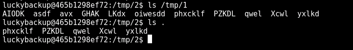

I've now tried it on my own (sorry btw, I've wrote this from the top of my head and haven't tried it) and here is the solution:
These are my test directories before the sync:
and here they are after the sync:
EDIT: Please note that I haven't tried it with files in the subfolders, but this pattern should work.
thank you. I think it's good.

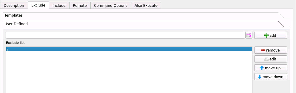

For whatever reason i had to delete and recreate the exclude part but when i look at the command line (validate button) it's the same.
For now it started to transfer folder starting with "O" right in the root of destination disk.

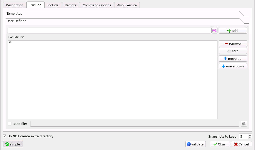

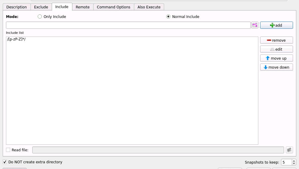

I can't reproduce this on my end, as said above I haven't tested if it also syncs the sub folders but it should.
Please make sure that you create for exclude:
And for include:
/[p-zP-Z]*/
This makes sure to first exclude everything from the source directory and then look only for files/folder which start with letters from p-z (upper and lower case).
Please also note that I have checked "Do NOT create extra directory".
it syncs subfolders and files.
But i don't why i had to delete and recreate the exclude part. Also this should have worked without exclude and with only include.
Anyway thanks i appreciate your help.
I'm not entirely sure, IIRC you should always, or at least it is recommended to use include and exclude if you want to sync only certain folders with a wildcard.

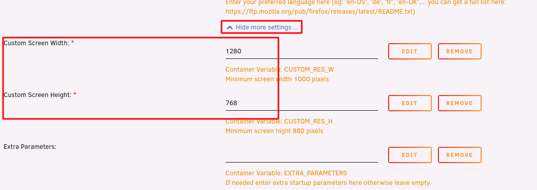

Hi Ich777! I'm trying out your Firefox docker in Unraid and I like the idea, but there's a couple of places that say I can change my resolution by clicking "show more settings"... but I can't find that option! Is it in the firefox menu inside of the container or some other option with the VNC controls?
(this is the initial resolution for the container)
BTW, the container also supports remote resizing, this means if you resize the browser window the container will also resize the Firefox application running inside the container to fill the browser window, to enable this:
  1. Click on the little arrow on the left side to open up the noVNC menu
  2. Click on the gear icon
  3. At scaling select "Server side scaling"
Hope that helps.
Hope that helps.
Aha!  It does, thank you.  I saw the env variables on the docker page, but for some reason I was reading the "more settings" as something inside the docker runspace itself.  The additional hint on server side scaling was perfect, thank you!

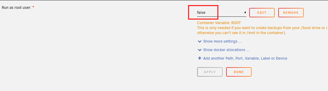

The problem is file permissions.
As for Appdata, Libvirt and unraid flash owner of the backup directory is root. But backup files have 700 as permission.
So luckybackup won't transfer any file.
Is there a simple solution which permit to use luckybackup for that and which would not affect other backups ?
Set this to true in the template:
damn it i was looking in luckybackup settings.
Thank you.
edit: i have this in my template. I guess i have just to add it.
Edited by caplam
You mean you don't have it correct?
Simply add a variable with the Key: ROOT and as Value: true <- this will do the job just fine. :)
yes sorry. I updated the template with the new variable and it's running fine.
Tank you again.😀
