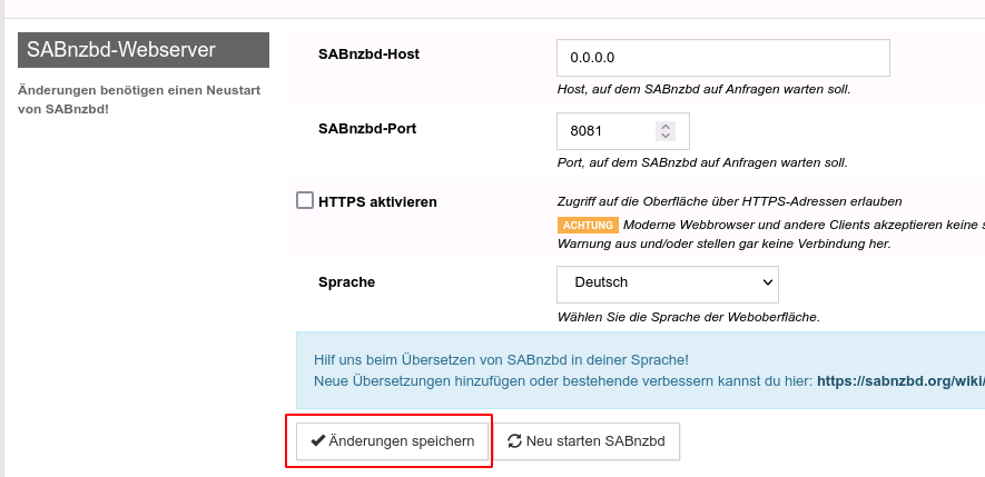

Just now, bobohazel said:
I think that port is hard-baked in the template or something?
Ignore that please in the Unraid WebUI, where you still able to connect through 8080 to the container or did you have to use 8081?
If you where still able to connect to it through 8080 then the container didn't save it.
The container does nothing to change the port back to 8080 and I've tested it now over here and I'm able to change the port to 8081, are you sure you've clicked this button after changing the port:
I tried this and I believe the port did change but now I cannot access the container anymore. Not on port 8080 or on port 8081. The template changed to show container port8081 but this is not reflected in the port's listed on the unraid docker tab.
I hope I have some time tonight to test some more.
As said, forget about what it displays in the Unraid GUI, just make sure that you've created a port mapping with the container port 8081 and the host mapping 8081 then you should be able to connect again when you are not routing it through the OpenVPN container.
