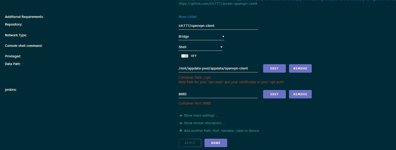

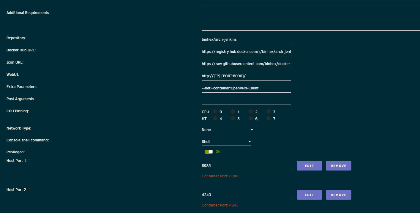

So completely new to openvpn on unraid.  I have OpenVPN client container working without issue.  Is there a way I can set up a docker container to only use the vpn for egress, but still allow incoming on the public interface?
Yes, configure it like described in the description.
Set the container network that you want to route through the OpenVPN container to None, and add the parameter to the Extra Parameters with Advanced View enabled.
In the OpenVPN template add the port from the container that you route through and you can again connect to the container.
Yeah I had done that but still not able to connect.  8985 is the web ui port
Because your mapping is wrong, you have to use the exact same mapping as in the container that you want to pass through, in your case Container port 8090 and Host port 8985.
You basically removing all network capabilities form the Jenkins container and using instead the OpenVPN network for the Jenkins container so to speak the Jenkins container uses still port 8080 inside the container, hope that makes sens...
Yeah.  Just figured that out a few mins ago.  I can't modify the host port on it if doing it this way.  Thanks!
What? You usually can't edit a Container port not Host port when you've added the port mapping already.
Delete the mapping that you've already done for the Jenkins container in the OpenVPN template and create a new mapping, with this you are able to specify a new Container port, the Host port can be left at 8985, the Container port in your case was wrong.

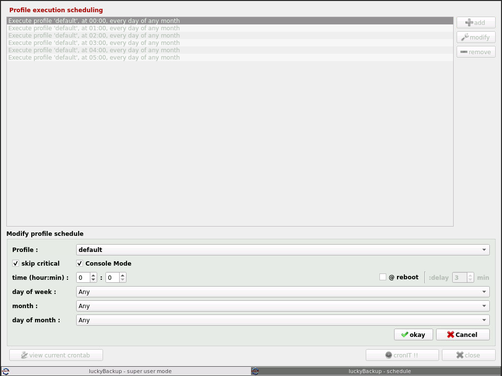

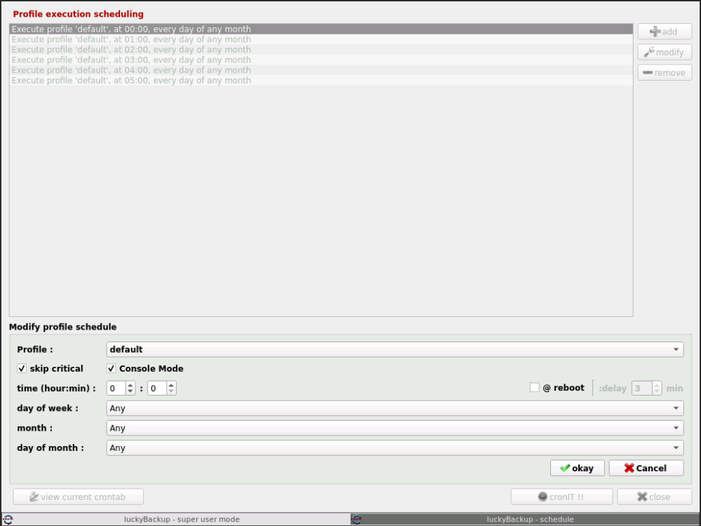

Hello, I am having a similar issue that guyola received assistance from ich777 and alturismo recently. I have a luckyBackup container on my Unraid install, configured to backup several directories to another Unraid server. The tasks run successfully manually but don't appear to run or run consistantly when using the scheduler/chron. From the info ich777 and alturismo provided, I now understand that the container gui will only update when restarted. But even after having a backup job scheduled and restarting the container after it should have completed, the backup does not seem to have run.
Attached are screenshot examples of where I had the schedule set to run every hour starting at midnight last night through 5:00 AM. But after restarting the container around 11:00 AM, the jobs do not seem to have run. Any help you can provide on what I am doing wrong is appreciated.

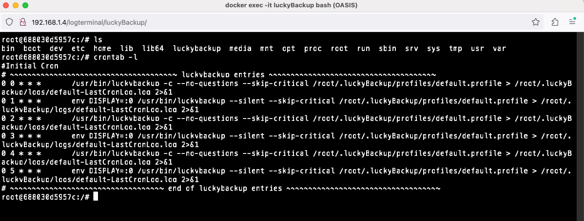

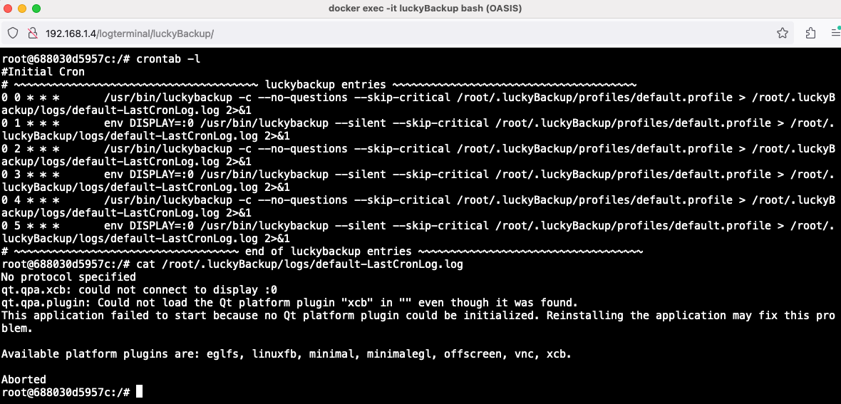

Please try to check the log from the cron jobs itself, you see the path to the logs in the output from 'crontabl -l'.
Do something like 'cat root/.luckyBackup/logs/default-LastCronLog.log'
Btw: You can see the crontab also in the GUI on the Schedules page.
I'm really curious if it's related to the network shares but I don't think so...
Thank you for the reply. Here is that output:
You have to select console mode (checkbox) for the Schedules in luckyBackup, otherwise it won't work (this is also mentioned in the description from the container).
Console mode is and has been selected:
