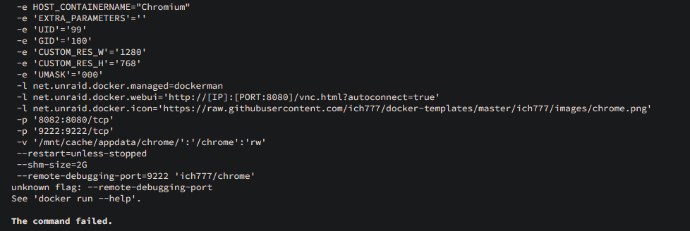

For Chromium is there some way to enable remote debugging? I've tried using the flag:
--remote-debugging-port=9222
but it says its not valid for some reason. I'm desperately trying to get something to work that requires a login and these are the only non-headless chromium dockers I can find. Help would be very appreciated.
Where does it say it‘s not valid?
Have you also added a port in the template with container and host port set to 9222?

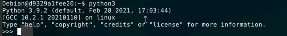

I'm unable to run python functions due to the GLIBC version being too low (2.31 - should be 2.35+)
How can that be updated?
Any hints about which container are we talking about?
Oh oops - the Debian Bullseye one
And yes I added a 9222 port in the template
I‘ll have to look into it.
On what Unraid version are you?
I don‘t have issues runnig a little python3 script.
How have you installed Python3?
You have to add it at the Extra Parameters at the Variable not on top with Advanced View.
6.11.5 - running it on bare metal works fine but the two dockers I tried have an issue with python3. (complaining about glibc). Installed python `sudo apt install python3` - something like that
Thank you! That got it installed.
The remote debugging doesn't seem to work though. With chromedp/headless-shell I was able to reach IP:9222/json/version from other machines and dockers, and I can't with this so far. I can reach localhost:9222/json/version from withing the chromium instance itself, but it doesn't seem to be accessible from anything else.
Apparently the "--remote-debugging-address" flag only works for headless chromium. I'm guessing that's why I could connect to chromedp but not this.
So I guess i'm stuck in a catch-22. I can have GUI chromium where I can login to the site I need, but can't connect to the session from another docker. Or I can have headless accessible from another docker, with no possible way to login to the site I need.

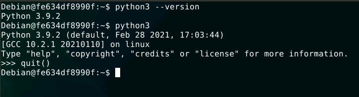

I'm not using 6.11.5 here on my server because it's something newer but usually you don't have to install python3 in the container because it's installed right OOB, I've now tried it again and it is working over here:
I have now the confirmation from another user who is on 6.11.5 that it is working:

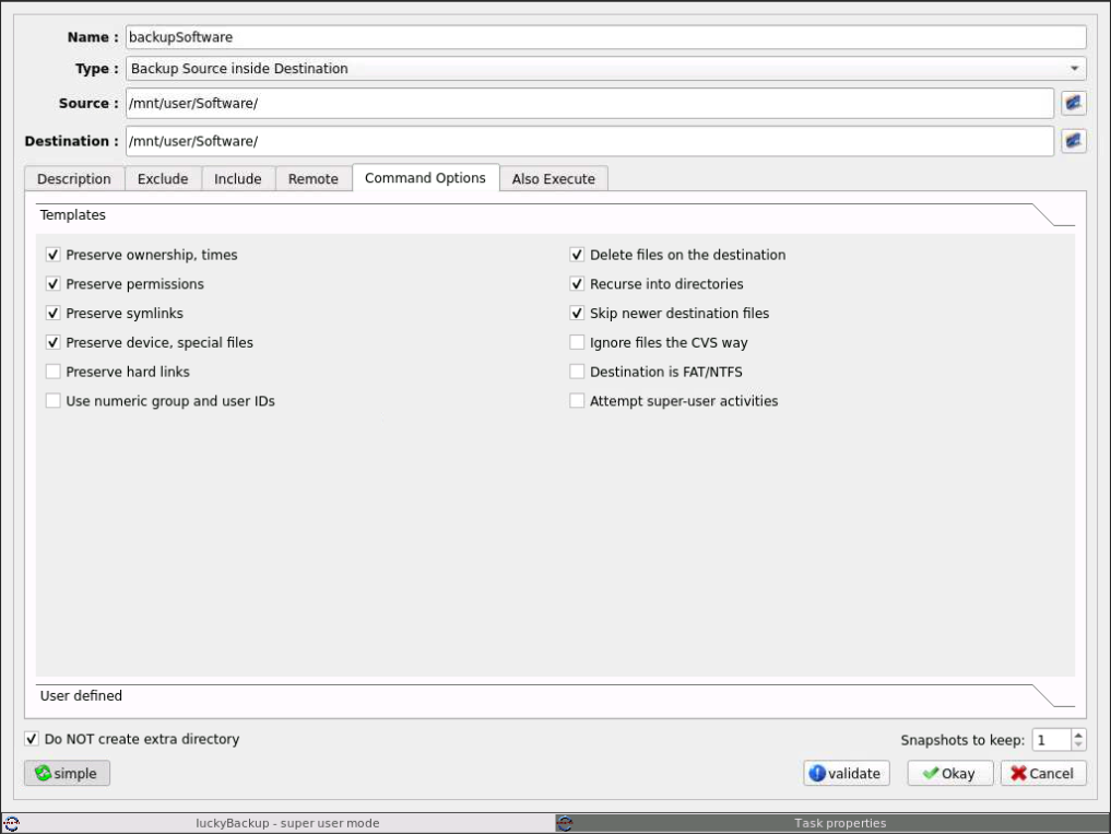

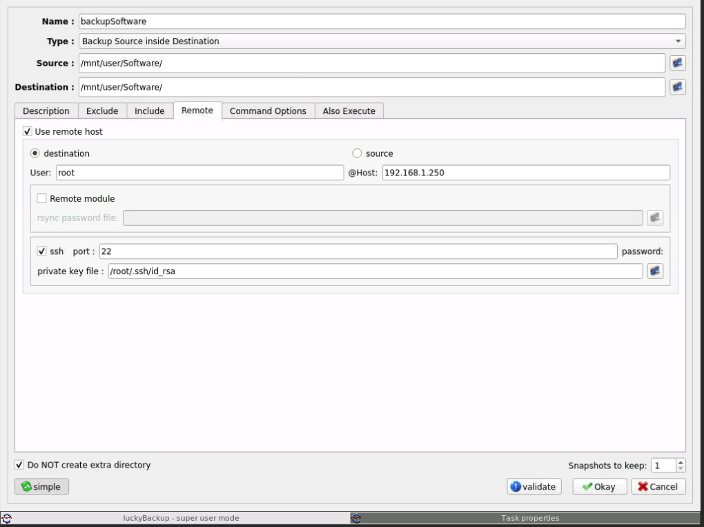

Im using Luckbackup to clone some of my Unraid shares from from my Unraid Server 1 to Unraid Server 2 (all inside the same home network) Im loving it and its working really well except, each time Luckybackup copies a file from Server 1 to Server 2, the owner of that new file is set as "UNKNOWN" in Unraid.
For some reason its not cloning the Owner of that file and im not sure what im doing wrong or if there is a setting somewhere that i should use. I have tried the option of "use numeric group and user IDs" but i get the same result.
My config and settings are below for info. any help would be much appreciated.
Did you do anything custom or better speaking does the user which has permissions to the files exist on the second server?
Anyways, this shouldn't harm anything because if you copy the file back over to the first machine the files should have the correct owner again.
Hope that makes sense.

No, nothing custom at all on the second server. It's a new build and that user has permissions to the files which exist on the second server so a bit strange.
All good, thanks for explaining about what happens when you copy the file back to the first server, i gave it a test and it does indeed show the correct owner again which is perfect because as long as i can restore things back to how things were on the first server then thats perfect for me :-) Thanks so much again.
