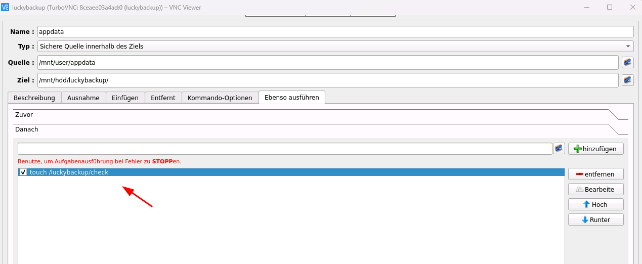

I think this could work with the "also execute" function of luckyBackup described here: net/manual.html#OperationAdvancedAlsoExecute
nope, you cant stop services outside the docker itself, this would work if luckybackup would run on the host itself ...
one approach would be to userscript docker stop xyz the related dockers before your luckybackup cron is running, now turning them back on ... one approach, see how long it takes, give it some extra and again userscript start the related dockers then.
another approach would be, touch a file after the job is done, in your userscript then, look when the file was touched and only then do something (like starting your dockers), in terms you want a safer and closer approach ... like this you could somehow use this "feature"
easiest is 1st approach, measure it now, if it takes like 10 Mins (it will only backup changed/new files after the 1st run) then stop dockers at 2.00, start them at 2.30 as sample, so you have 20 Mins safe between ...

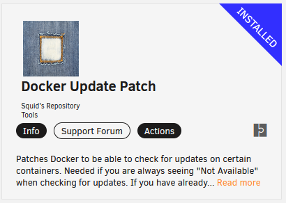

3 hours ago, idscomm said:
I did some research before posting and did not find a solution/topic....
This has nothing to do with the container, you have to install Squids Fix from the CA App:
Awesome, Thanks for the quick reply. I was not aware of this issue and plugin... Zabbix was the only docker out of my 10 giving me this error.
Problem fixed, thanks again!

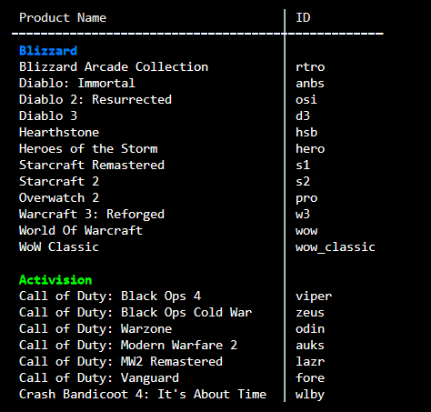

4 hours ago, cholzer said:
And is there a list of all battlenet product codes somewhere? specifically the codes for overwatch2 and Warzone 2 which I cannot find.
Sure thing, as mentioned in the template here:grafik.png.20ec7d7a4f9284303bf1c25f5a700a5f.png
https://github.com/tpill90/battlenet-lancache-prefill#detailed-command-usage (or you can scroll a bit up to this bit: https://github.com/tpill90/battlenet-lancache-prefill#selecting-what-to-prefill)
Or you can open up a container console and run the following commands:
  1. Type in 'su $USER' (case sensitive!) and press ENTER
  2. Type in 'cd ${DATA_DIR}/BattleNetPrefill' and press ENTER
  3. Type in './BattleNetPrefill list-products' and press ENTER
Then you should see something like that:
Lets say I preloaded "Game A".
With the schedule enabled, does it predownload game patches that get released later?
Yes, every time the prefill run it will check for updates, so to speak patches and prefill them.
